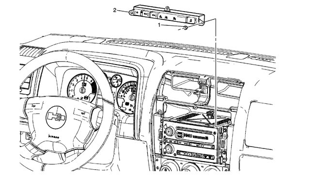

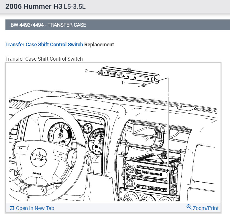

my car looks like activates the 4x4 by itself without press the buttons in the central console. Usually when going back and turn or when you try to make a U turn.
the T-Case can activate the actuator if it see any drag in one of the rear wheels?
all my problems came after some problems with the parking brake, activating by itself like two years ago. Last year, my front differential was rebuilt for that reason and it never stops doing it.
what can I do?

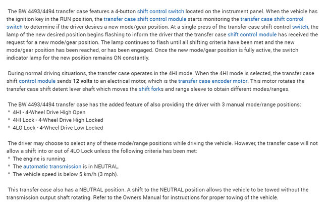

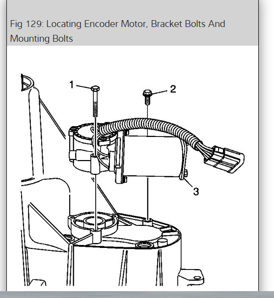

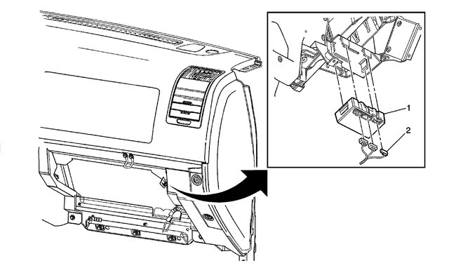

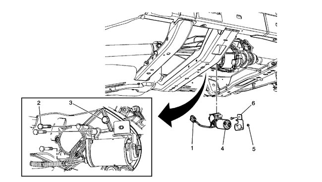

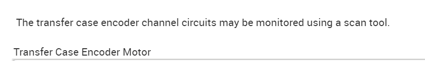

  • 55,721 POSTS

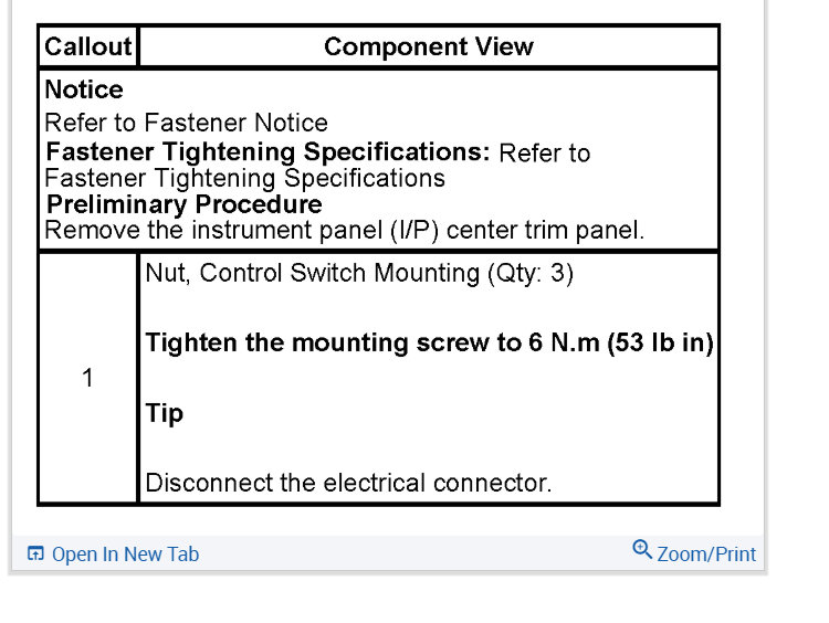

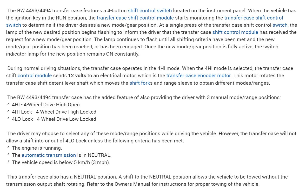

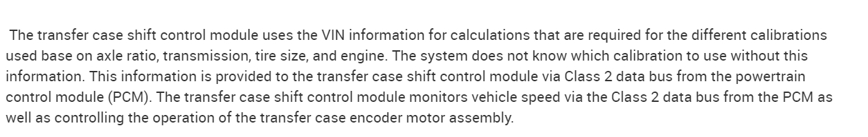

If the switch goes bad it will self activate. I would replace it first, the encoder will not operate unless the switch activates. Check out the diagrams (below). Please let us know what you find. We are interested to see what it is.

when I place the truck in neutral and activate the switches, everything looks normal, lights change and everything, you can hear the transfer case changing and making the same sound
when the failure occurs the light 4WD unlocked remain lit.
why do you suspect of the switch?
I've been reading a lot about transfer case and everything related lately,
the problem looks to me below, the 4WD engage without command and according to what I read, it can be caused for a defective VSS, or defective encoder, or definitely a bad TCase (folk) or other thing inside.
I also suspected the TCC module but I have inclination to think if the module is defective the lights should be changing, don't you think?

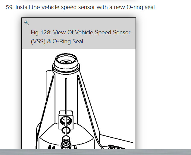

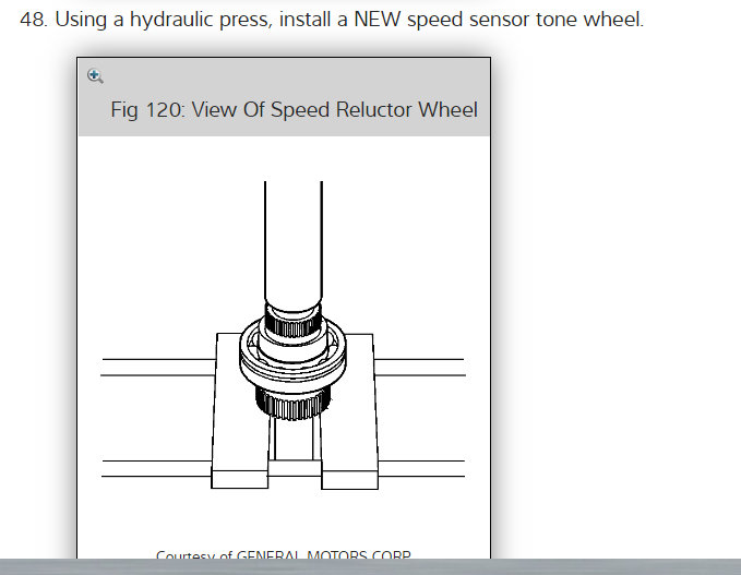

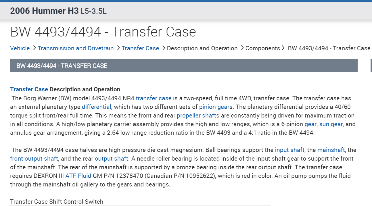

Jun 12, 2019 at 10:57 AM

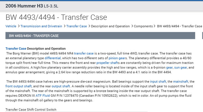

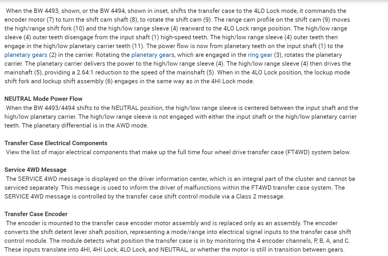

SCGRANTURISMO
  • 4,897 POSTS

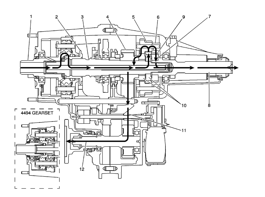

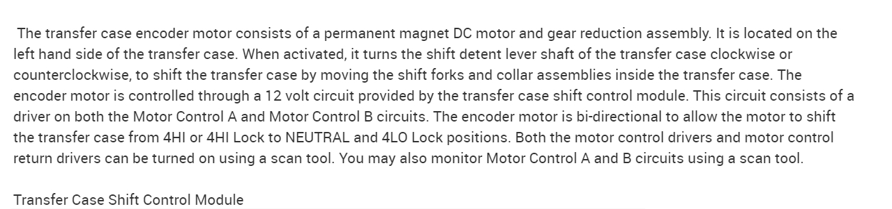

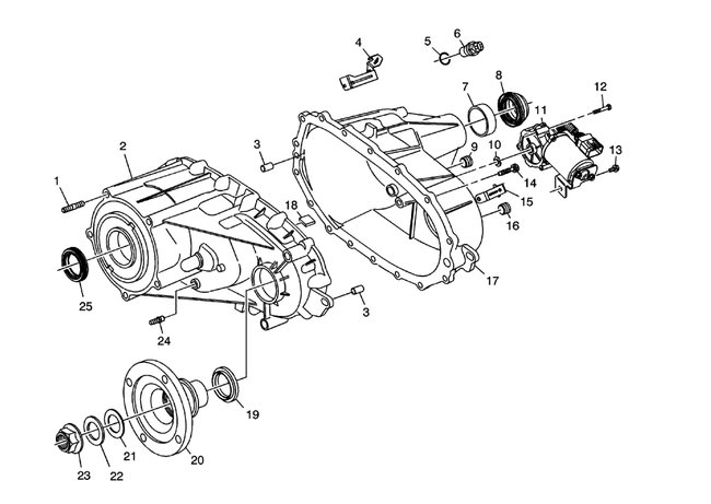

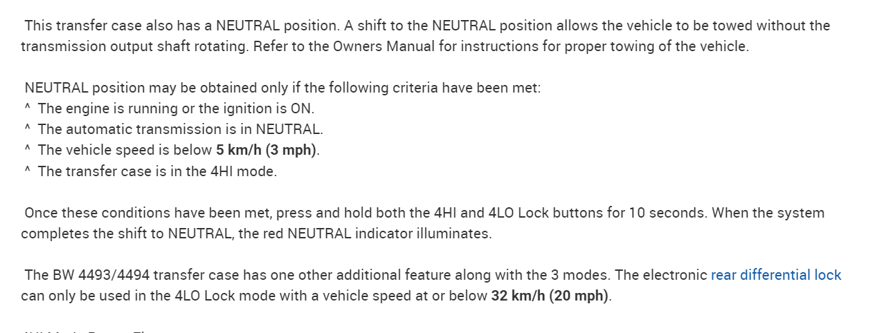

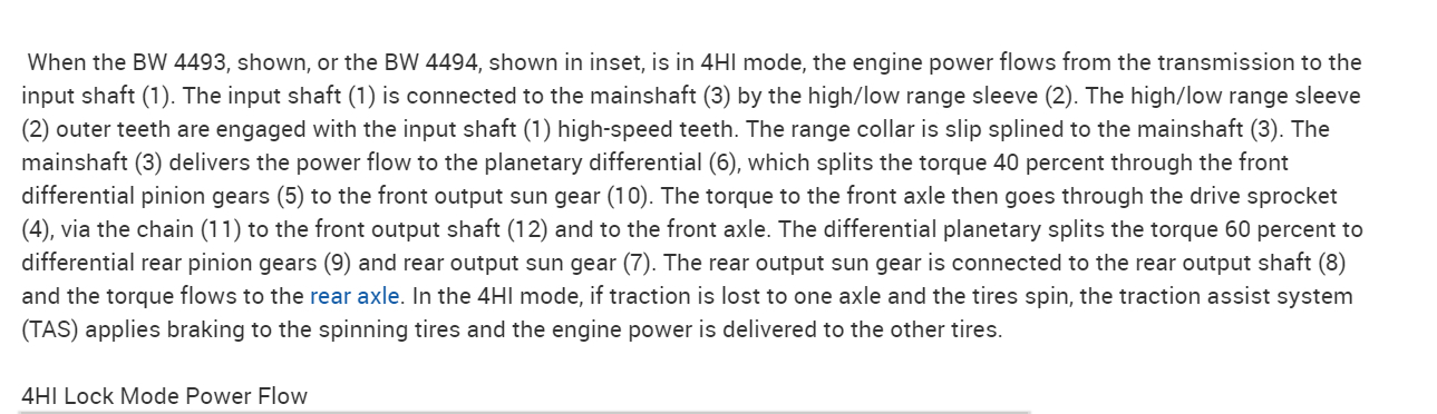

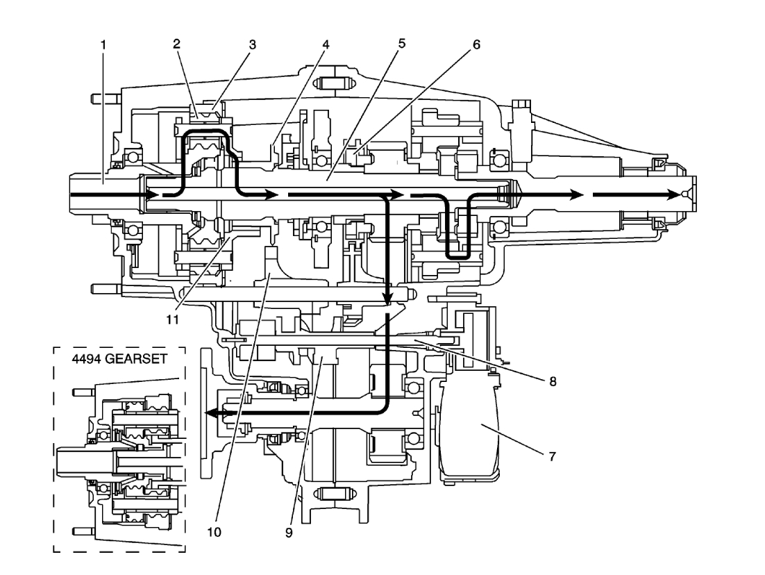

Hello again,

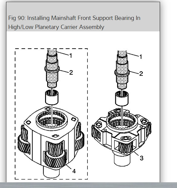

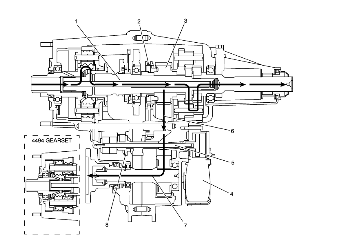

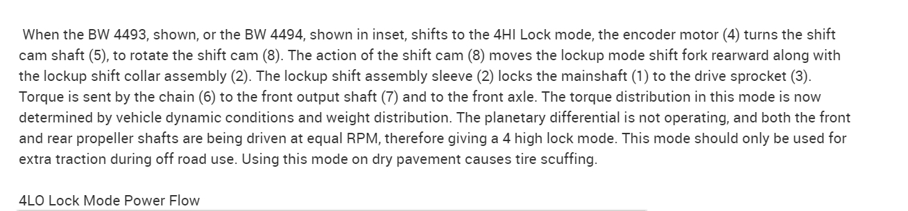

Okay, here is everything that there is to know about your vehicle's Transfer Case. The best part about the information that I included in the diagrams down below for you, is that this information isn't hype or speculation, but a description of how the component and related sub components work and work together from the vehicle manufacturer themselves. No guessing or misinformation here. Please go through this information and get back to us with what you find out.
Thanks,
Alex
2CarPros

Sure, I have this complete manual.

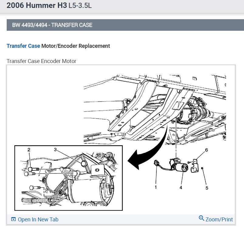

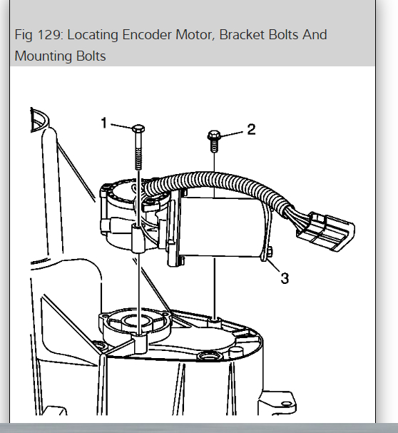

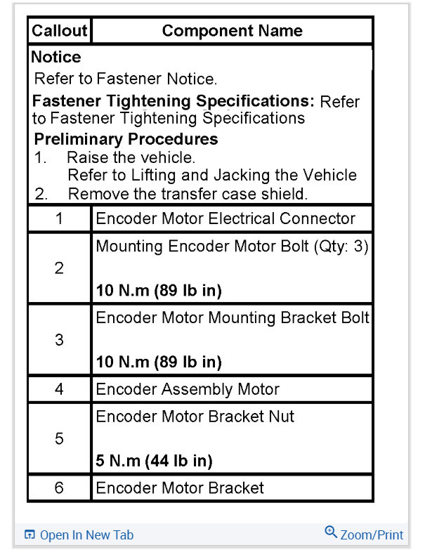

JULIOLOP
  • 18 POSTS

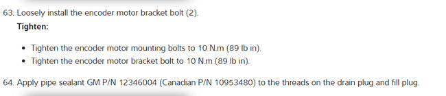

I have a risen question.
in case that I need to replace the encoder motor, what if it is in a different position than the T-Case?
can I connect it to the harness and start on the truck without to hook it up to the T-Case ?
BR
Jun 13, 2019 at 3:21 AM
  • 55,721 POSTS
Yes, you can match the encoder motor position before installing it. That way when installed you can use the switch to check it to the desired position.

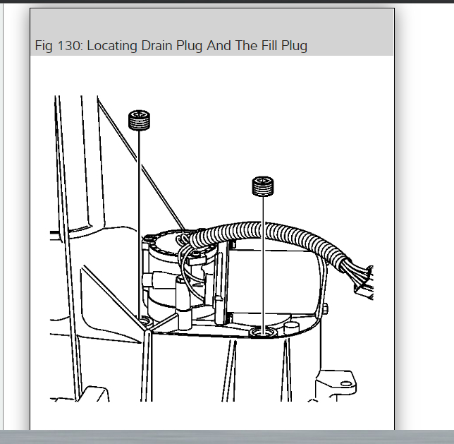

Two questions
Do I have to drain the TCase before the encoder replacement?

JULIOLOP
  • 18 POSTS

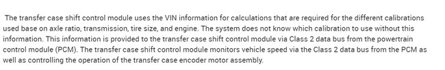

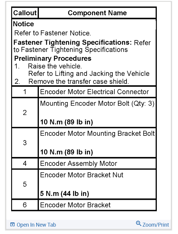

I've not proceed because I was told after you replace the encoder motor or the transfer case you need to reprogram the modules. is that true?
Jun 25, 2019 at 12:48 AM

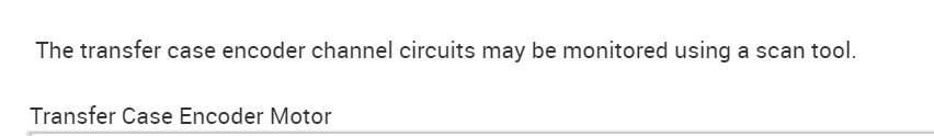

  • 55,721 POSTS

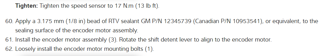

I don't think so. here are the instructions on how to replace the encoder I don't see any relearn notes. Check out the diagrams (below). Please let us know what happens.
Jun 25, 2019 at 4:54 AM

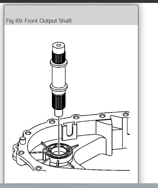

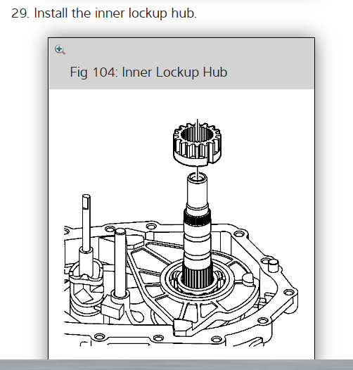

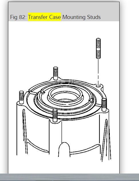

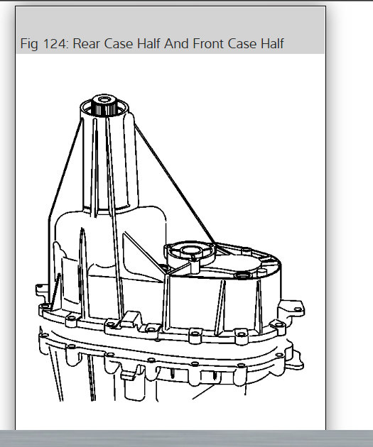

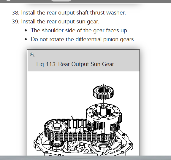

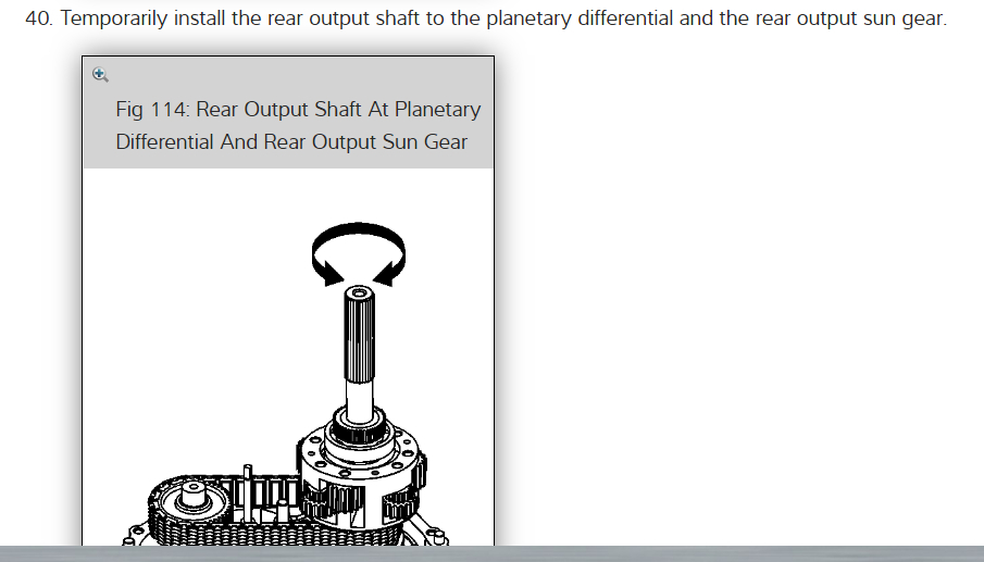

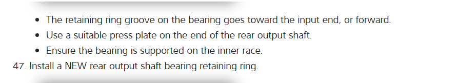

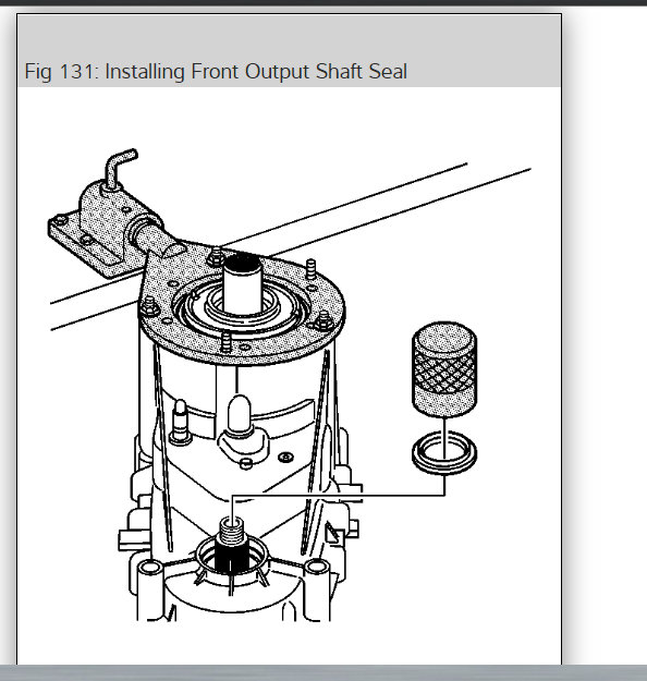

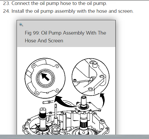

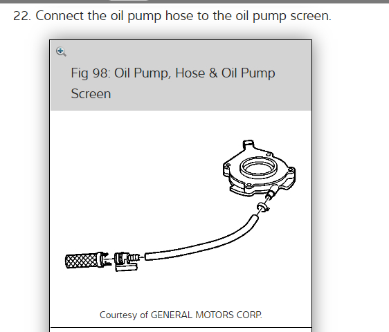

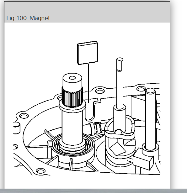

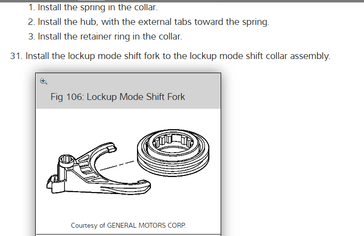

JULIOLOP
  • 18 POSTS

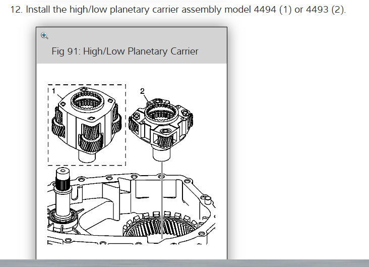

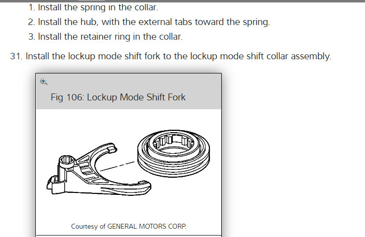

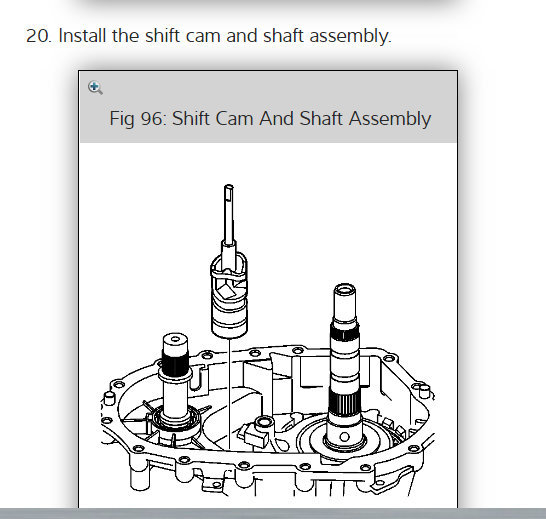

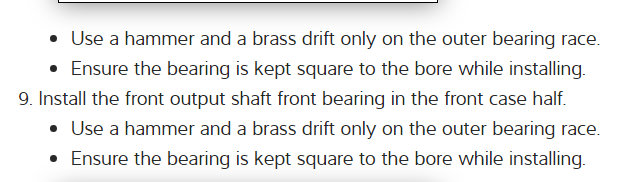

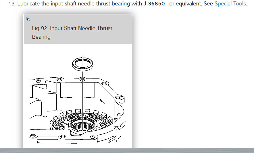

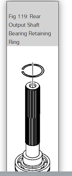

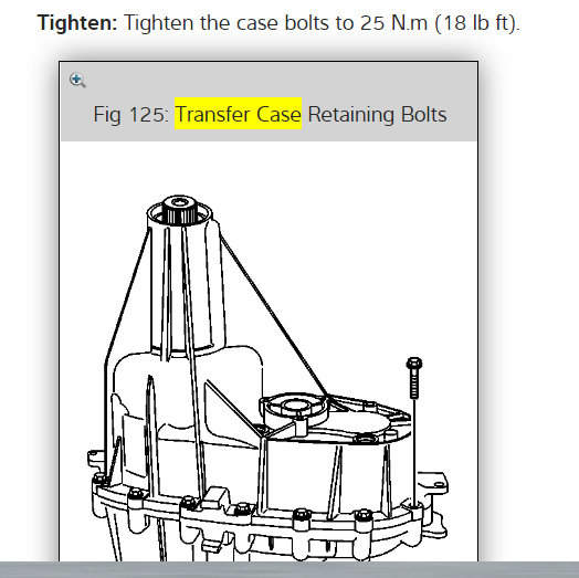

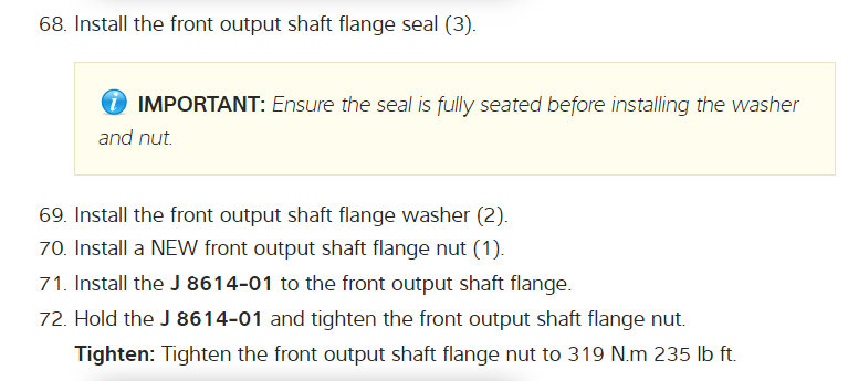

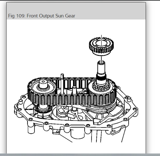

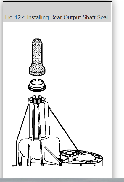

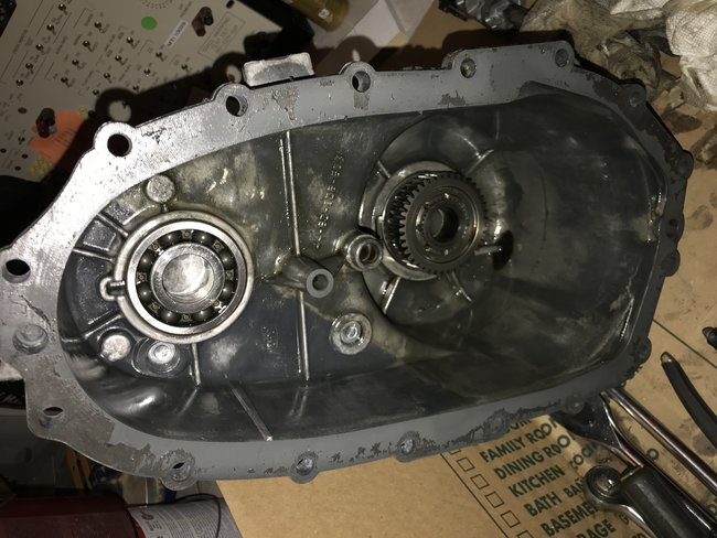

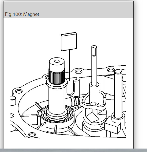

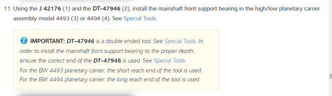

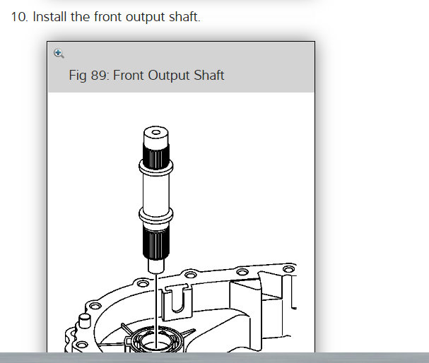

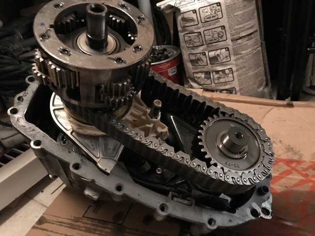

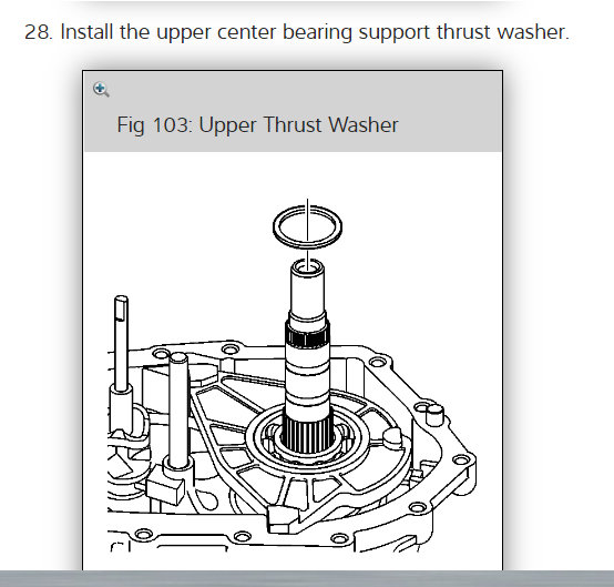

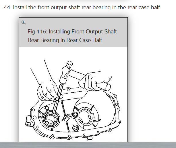

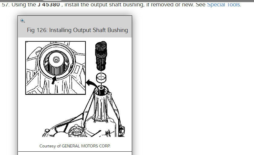

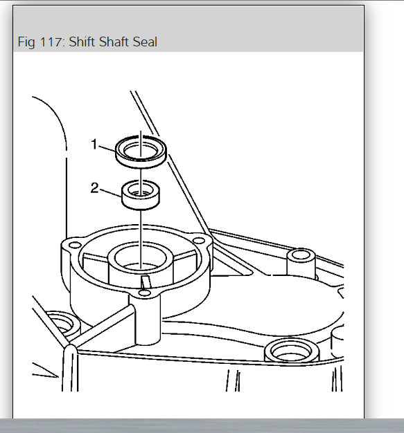

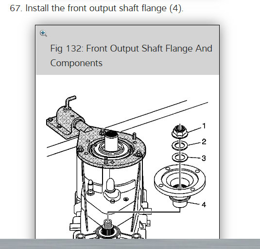

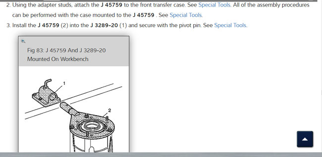

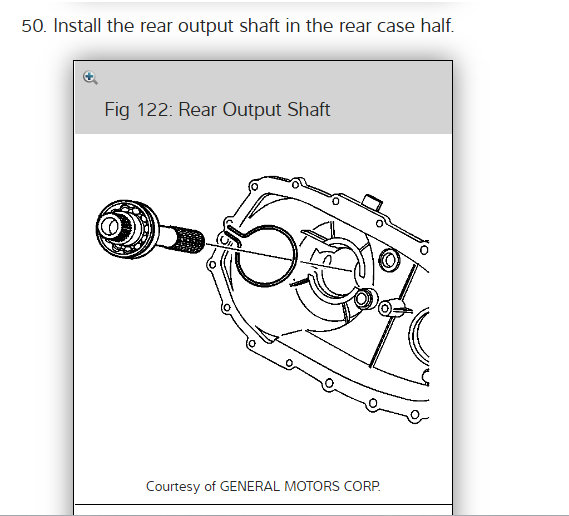

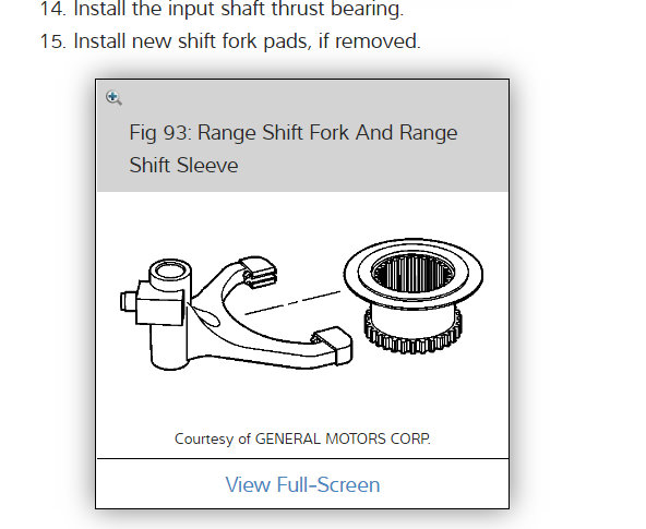

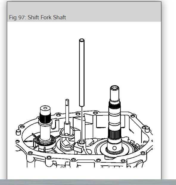

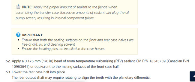

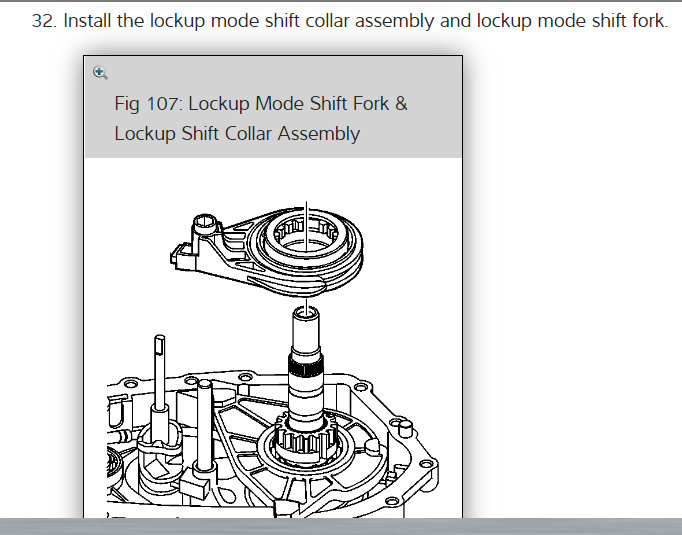

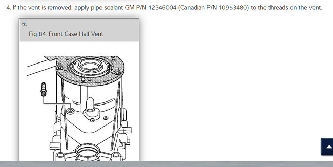

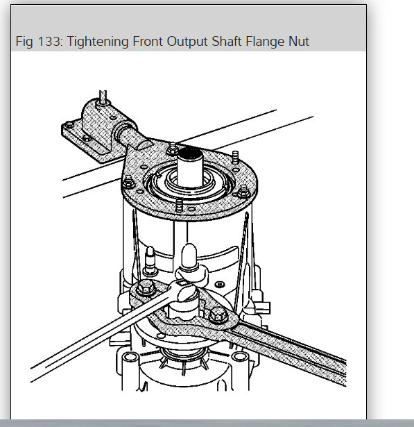

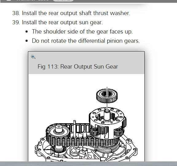

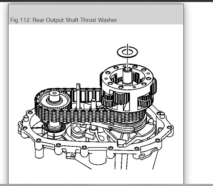

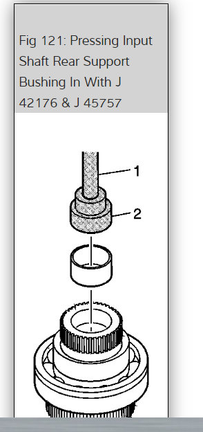

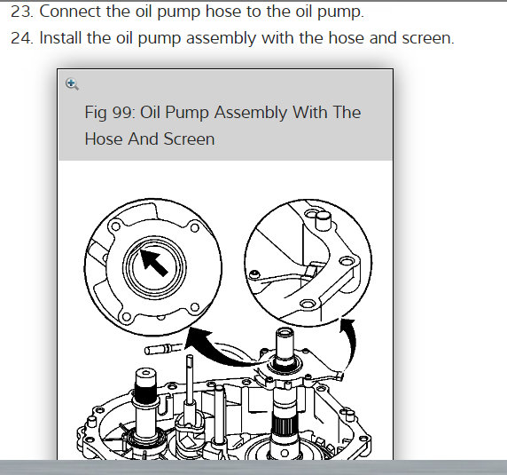

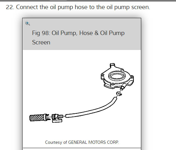

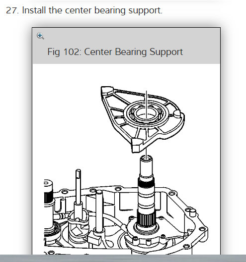

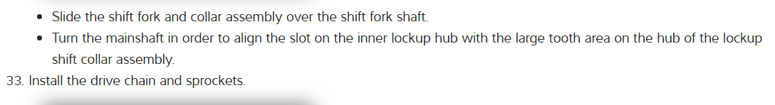

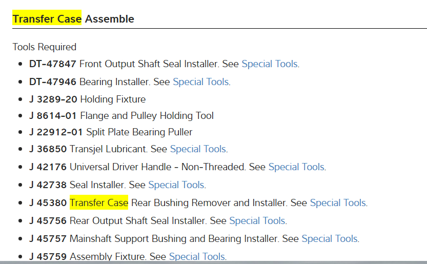

okay, transfer case down, open and verified defective plastic fork (replaced).
my concern now is how to put back the piece that move the fork, any suggestion or it is easy?

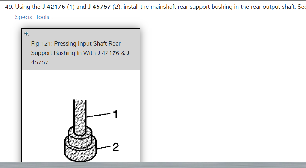

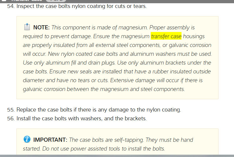

Jul 18, 2019 at 10:16 PM

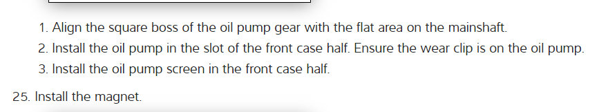

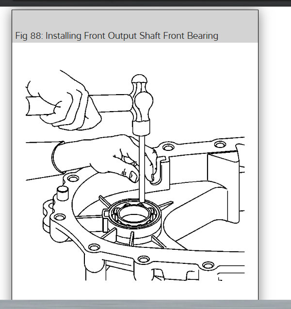

SCGRANTURISMO
  • 4,897 POSTS

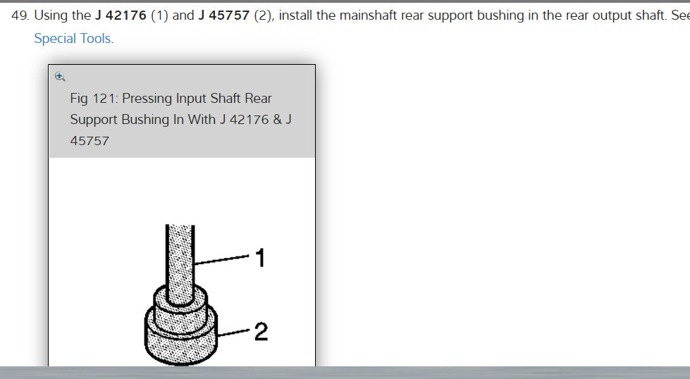

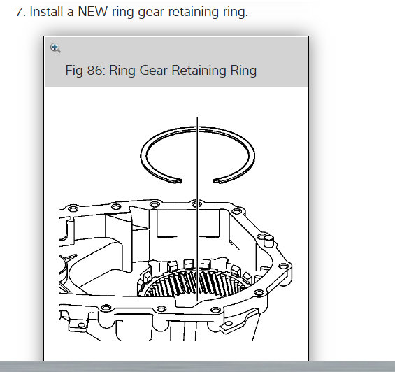

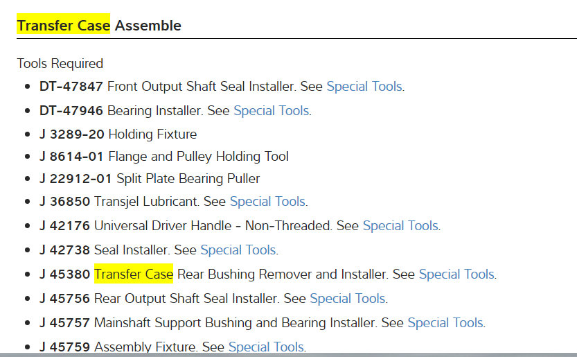

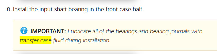

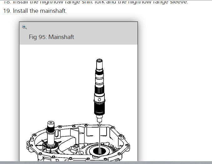

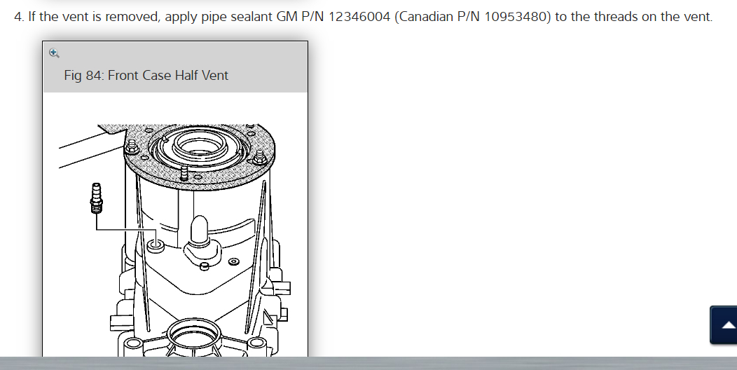

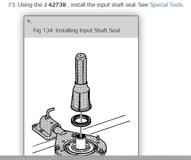

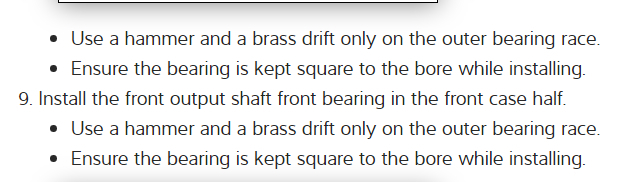

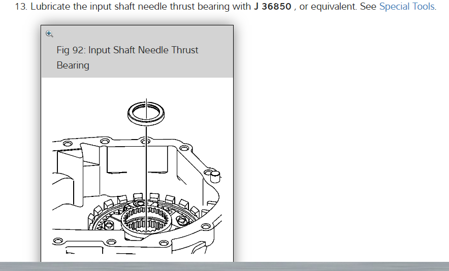

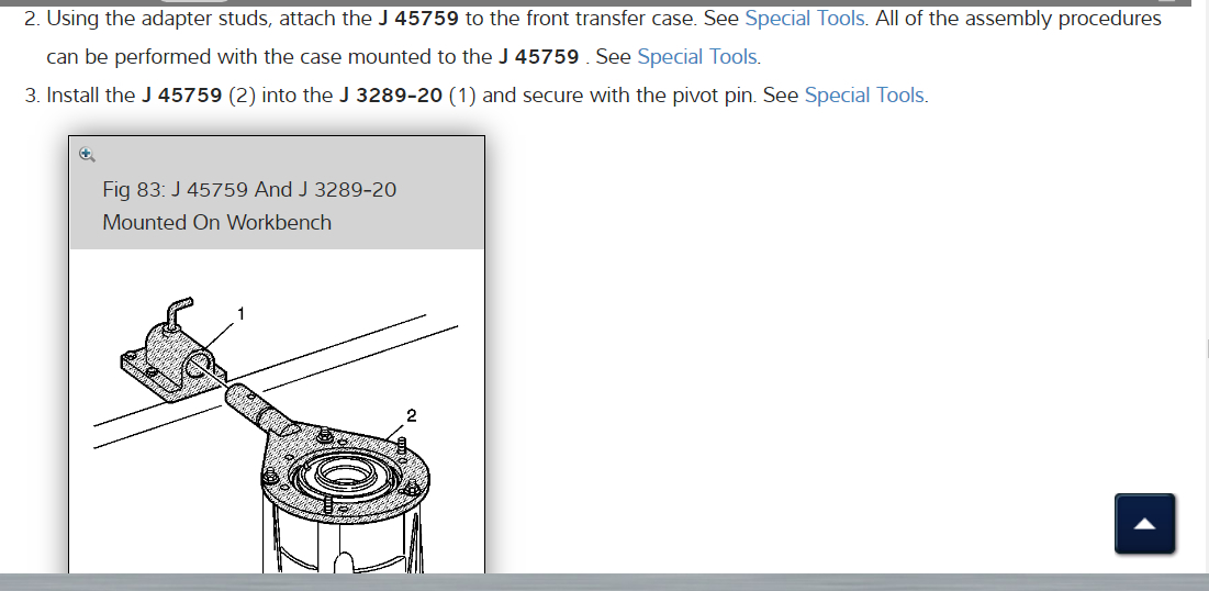

Hello again,

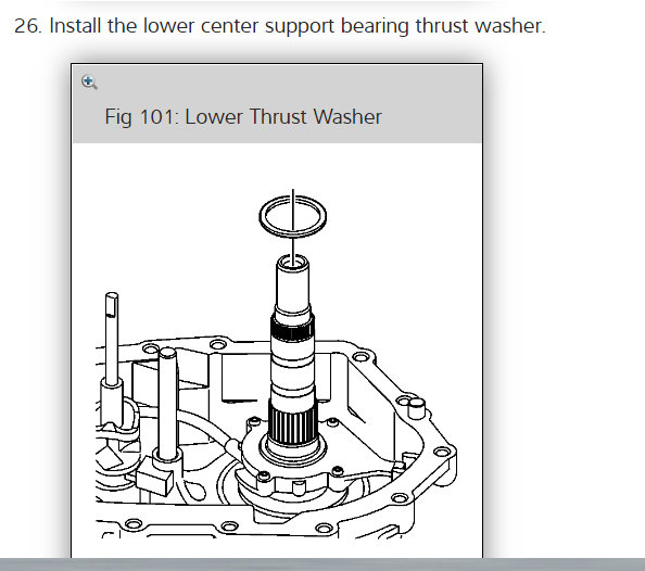

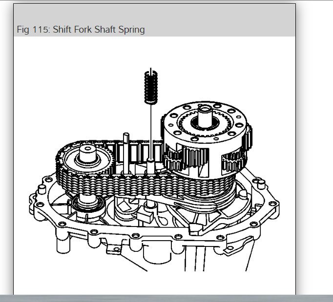

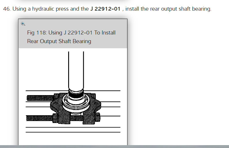

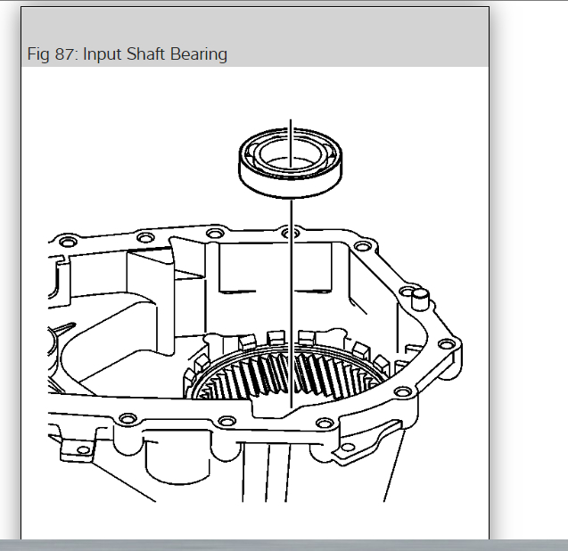

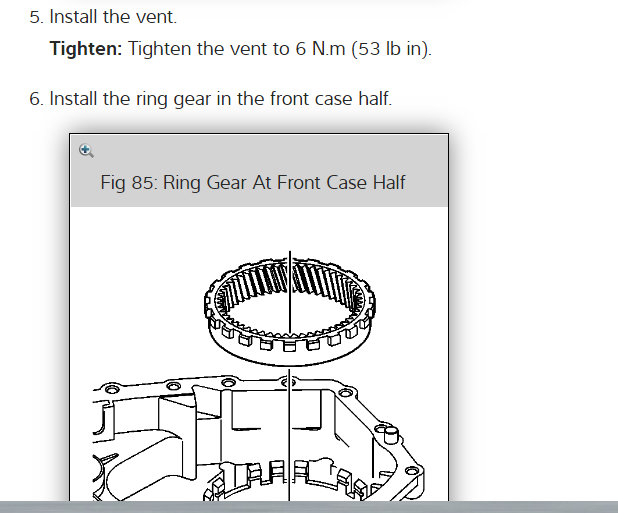

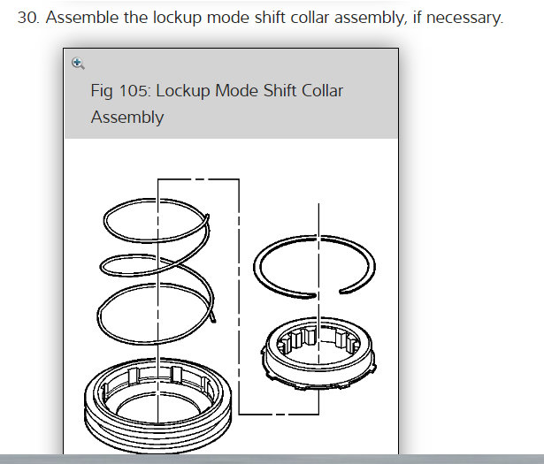

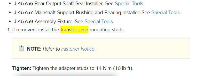

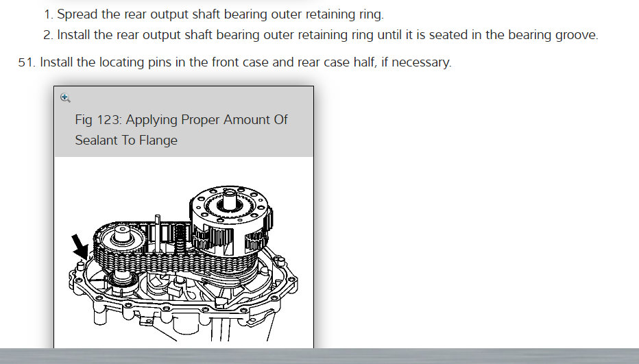

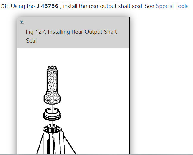

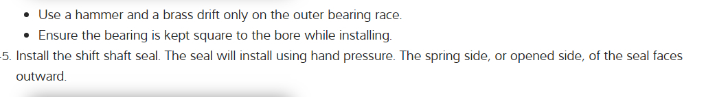

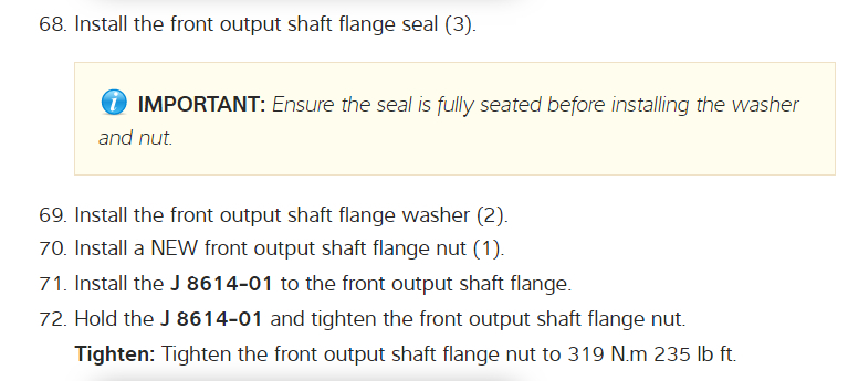

Okay, In the diagrams down below I have included the entire directions from the vehicle manufacturer for the assembly of your vehicle's transfer case. Please go through this guide and get back to us with how everything goes reassembling it.
Thanks,
Alex
2CarPros
Jul 18, 2019 at 11:41 PM

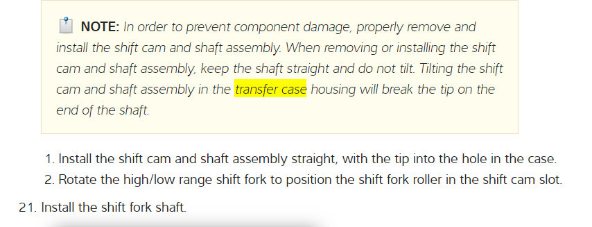

JULIOLOP
  • 18 POSTS

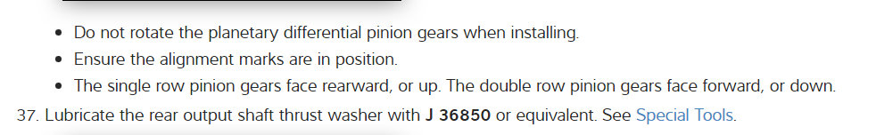

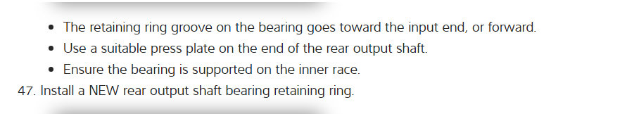

Alex, thanks for your prompt answer.

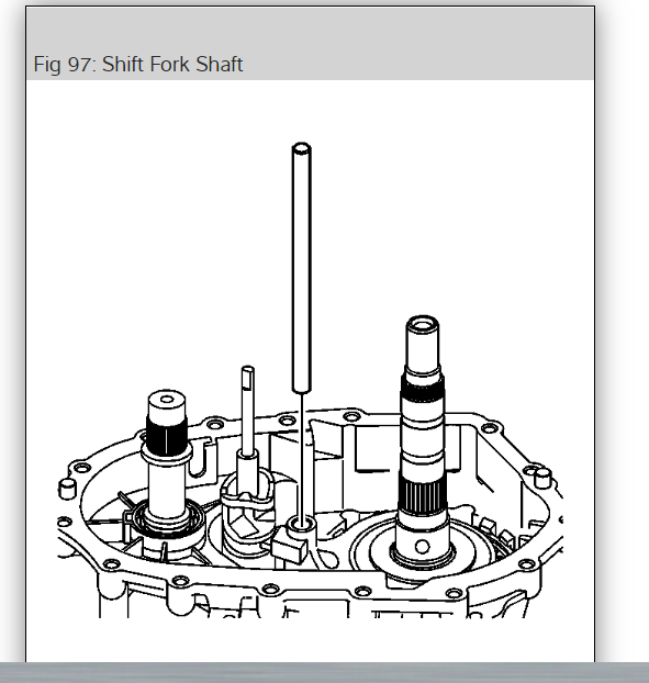

do you have all this in just one PDF?

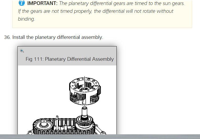

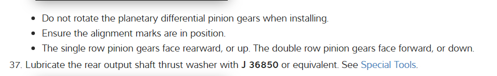

now I have several doubts.

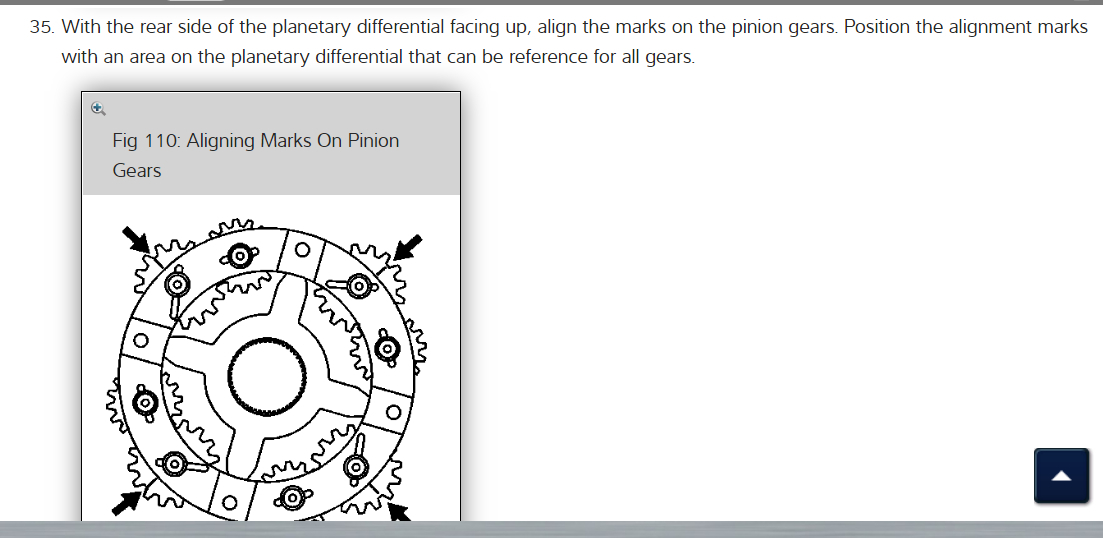

I can see nothing related to the shaft I asked, the one that is moved by the encoder, and in the planetary I only have marks in two gears, is it okay?
Jul 19, 2019 at 2:01 AM
  • 55,721 POSTS
sounds right can you upload a picture of what you are talking about?
Jul 22, 2019 at 4:19 AM

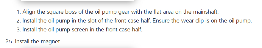

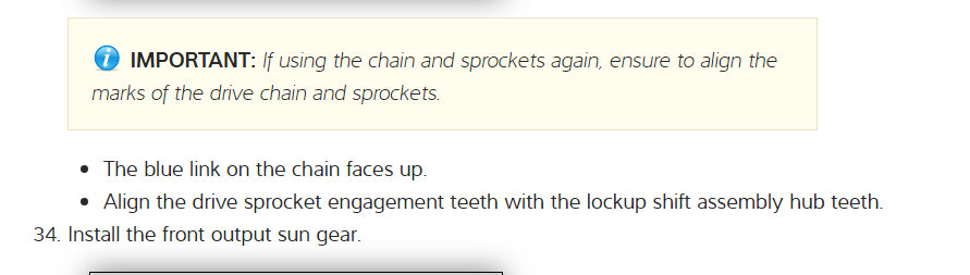

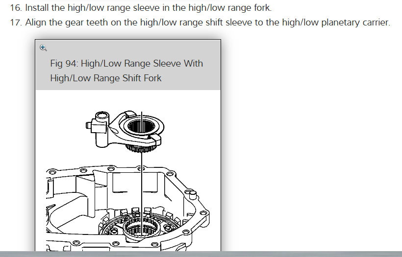

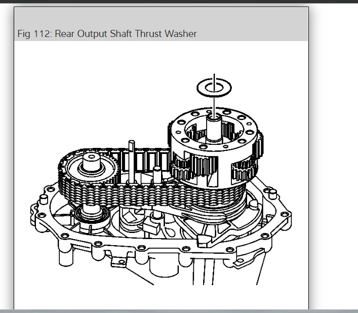

JULIOLOP
  • 18 POSTS

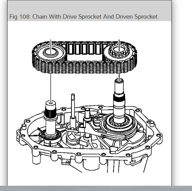

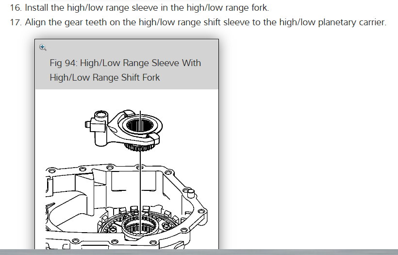

to place the sprocket inside that planetary gears assy you can see in the picture on top of the chain has been very difficult
following the manual you have marks in the four upper gears,
Jul 22, 2019 at 5:11 AM
  • 55,721 POSTS
Sorry, I am not sure what you are saying, there is no timing for these gears, can you be more specific, what is the problem ?
Jul 23, 2019 at 5:08 AM
JULIOLOP
  • 18 POSTS
Okay Ken,
Work is done and it looks okay.
the plastic fork was replaced by aluminum fork.
