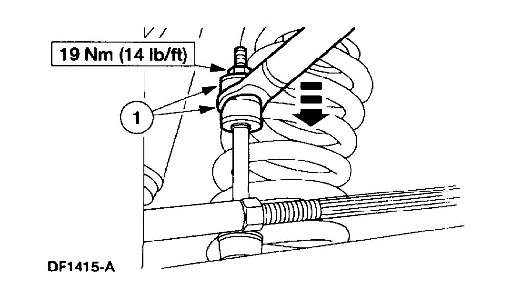

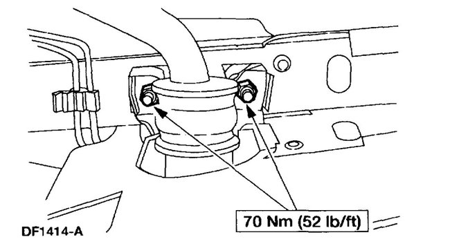

Torque specs on the sway bar bushings.

Hello my name is Dave.
As far as the tie rod ends; yes, you can replace just the outer ones provided they are the ones showing play, the inner usually outlast the outer by a considerable amount of time/use.
For your sway bar the bushings torque is 52 lb/ft and the links are 14 lb/ft
Let us know if we can help you anymore and thank you for using 2CarPros!

Good morning,
I posted the spec for you for the sway bar bushings.
Also, you can just replace the outer tie rod ends without doing the inner.

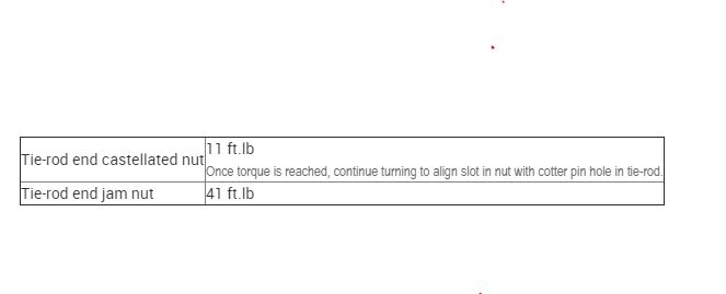

And the inner tie rod torque specs please.
Mar 12, 2020 at 5:22 AM
Attached.
41 pounds.

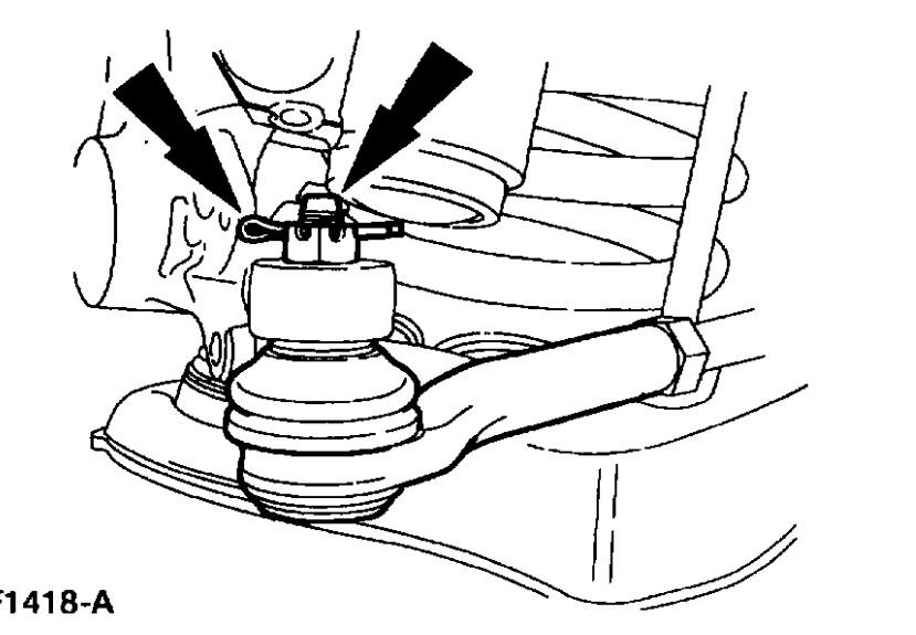

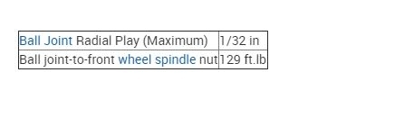

And going to install a ball joint on the lower control arm. anything I need to know and what are the torque specs?
Mar 13, 2020 at 3:17 AM
Good morning,
Torque spec attached.
