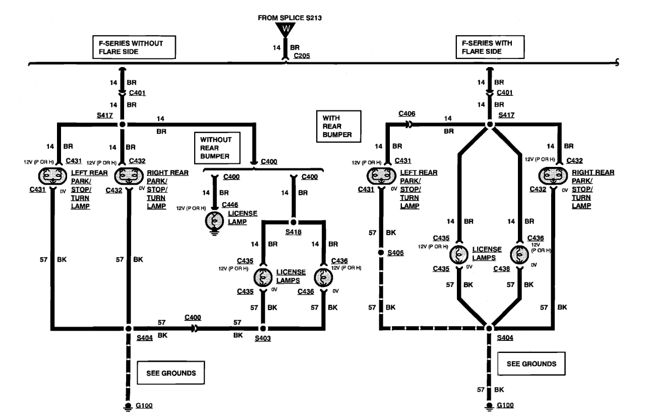

I have no blinkers or flashers. I have LED in the front non led in back except for 3rd brake light. brakes, taillights, running lights, park and all work including LED third light put LED flasher in, but my blinkers or flashers won't even come on not even on dash.

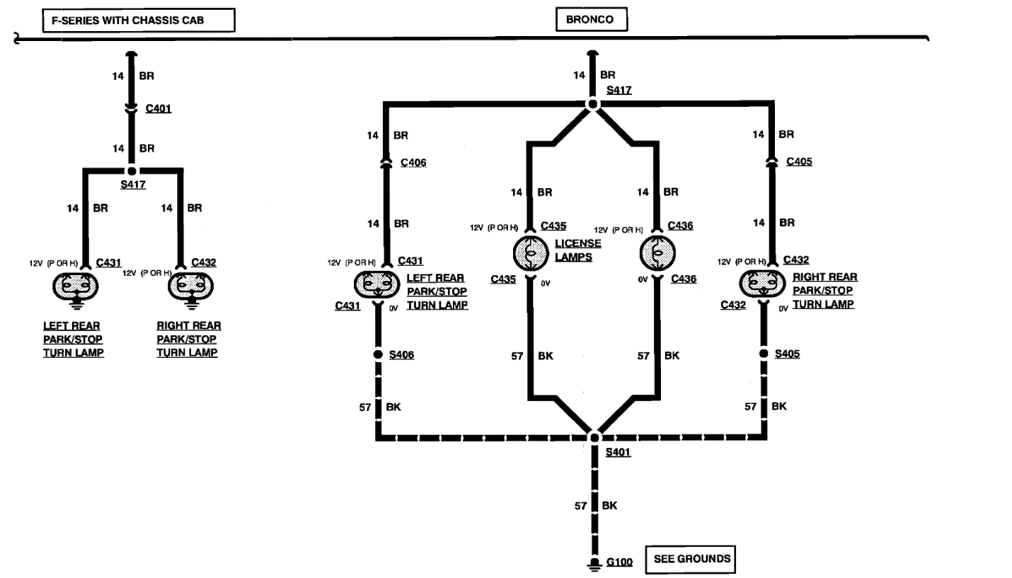

Yes, when you swap to LED the resistance goes down so the flasher will not engage. They make LEDs with the resistor interrogated into the bulb. Here are the blinker wiring diagrams so you can see how the system works. Also, they make a flasher that will work with the LED's. Check out the images (below). Please let us know what happens.
