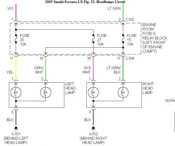

i would like to know where i can find a wiring diagram for a 2005 suzuki forenza headlight diagram i lost my head lights i have brights and parkin lights but no head lights bulbs are good

Notchback or wagon?
just the headlights wiring?
did you check the 15 amp fuse? (fuse No: 15)
(that`s for both low beam lights)

Too big and hard to read (too small letters) here part of it:
https://images.2carpros.com/forum/automotive_pictures/576_suzuki_1.jpg
if you want I can e-mail you the rest of it... good luck!

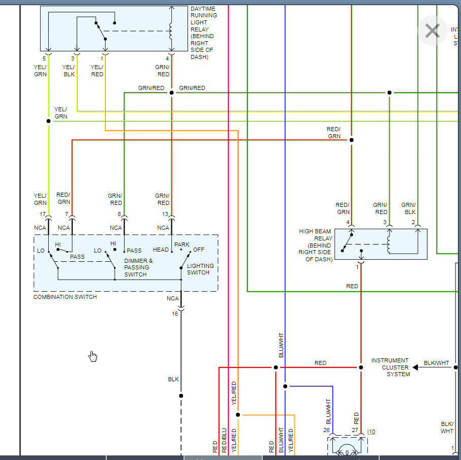

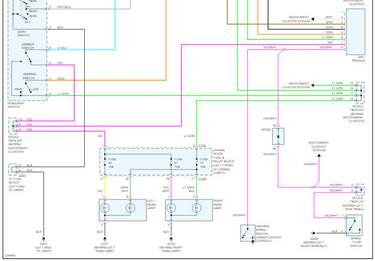

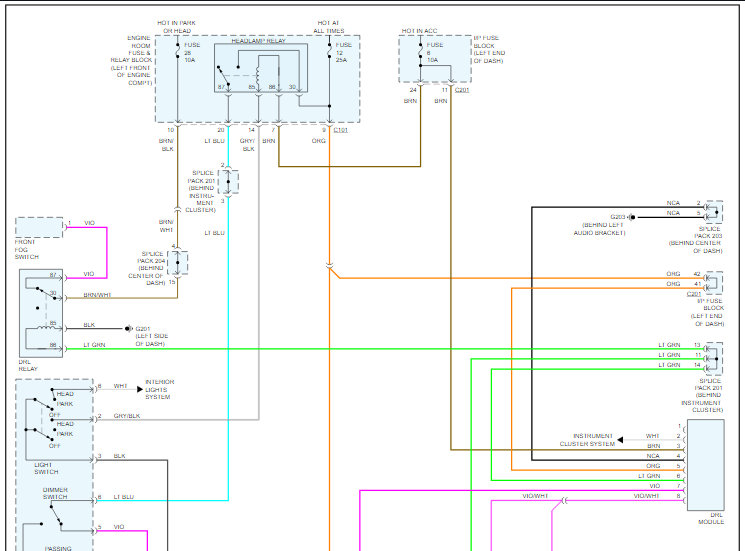

I would like to get a copy of wiring diagram for 2005 Forenza.
Dec 14, 2019 at 6:01 PM
DANNY L
  • 5,648 POSTS
Hello, I'm Danny.
Here is a headlight wiring diagram for your car as you've requested. I've cut the picture in 2 to make it larger for you and attached below. Hope this helps and thanks for using 2CarPros.

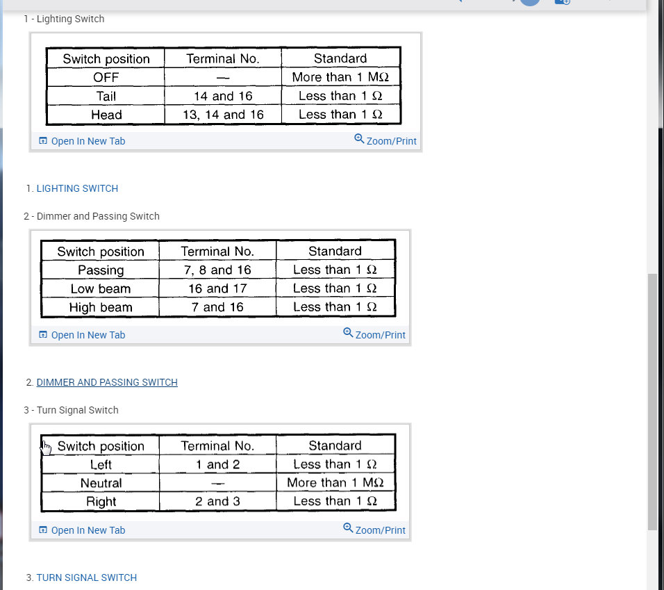

Recall was done on car. Sometimes dim lights work and sometimes they don't. They can be working then randomly turn off. Got any ideas on what to check for?
Dec 17, 2019 at 9:58 AM
WILDFORDCHILD
  • 5 POSTS
Is there a relay that could be faulty? Would replacing the multi switch on steering column fix it? How can I diagnose my problem?

What was the recall for ? I'm searching for your headlight relay in the meantime.Thanks again for using 2CarPros.

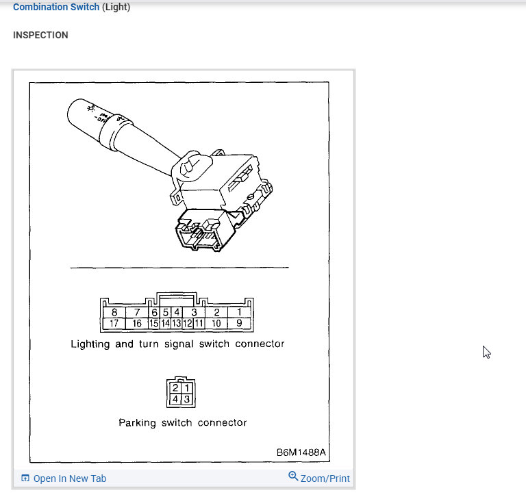

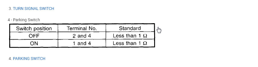

Recall was for wiring to headlights. Certain models (according to VIN) had headlight switch replaced. I called Suzuki and was told my vehicle wasn't included in that recall.
Dec 19, 2019 at 3:46 PM
If you haven't swapped out the combination switch, then I would do that. It sounds like the switch in the dimmer is failing.
If you want to test it, I included the testing for the switch. Let me know if you have questions. Thanks
