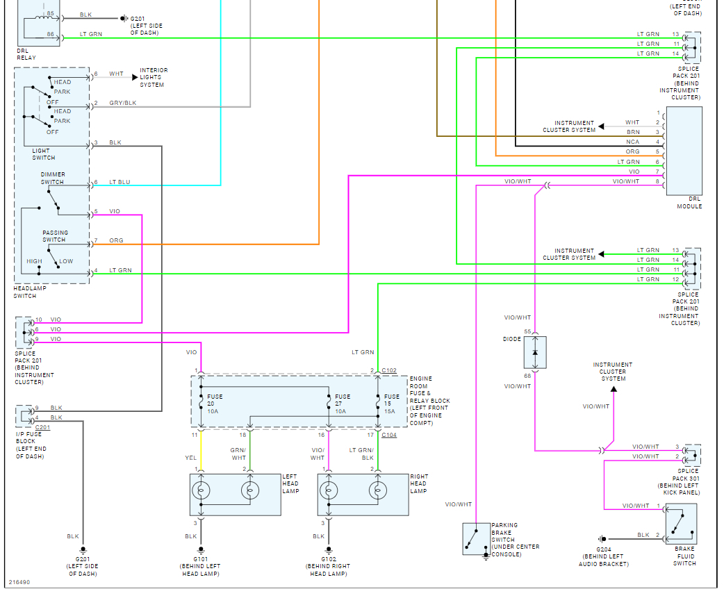

I have no low beam lights.High beams and parking lights work. When I push the switch ahead for low beams, they go completly out. Bulbs, fuses, relay good. Replaced light switch on steering colume. This is a 2005 Forenza.

check wiring and ground connections

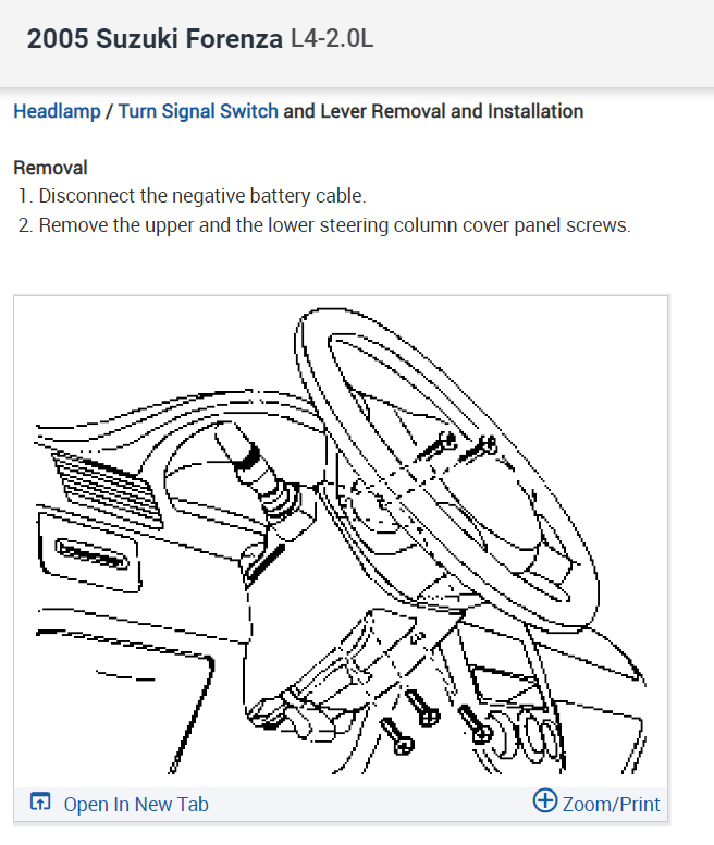

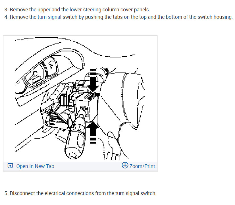

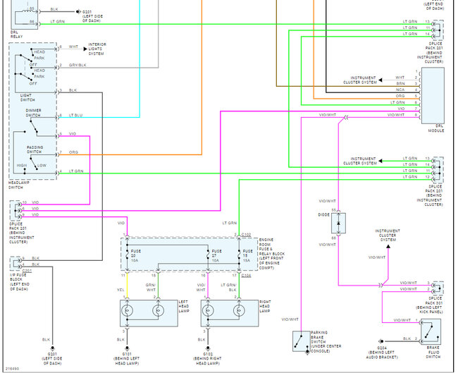

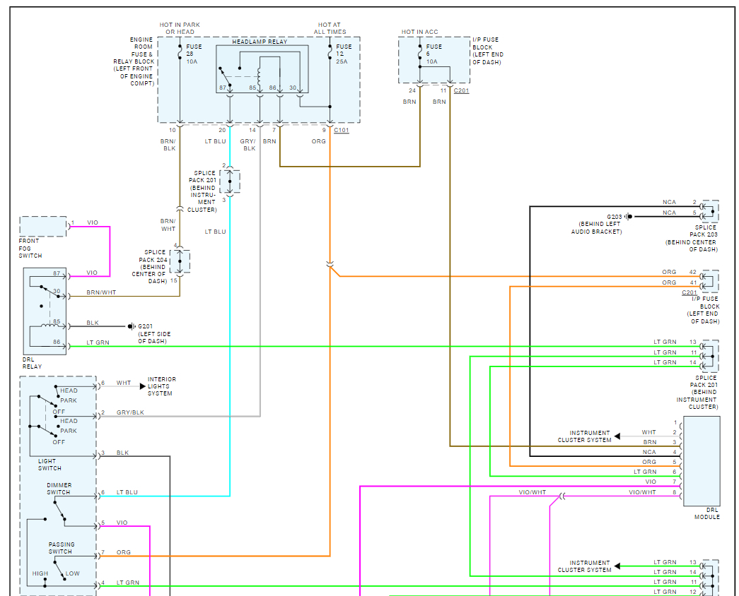

If the other lights work it sounds like the headlight switch itself is bad, here is the headlight wiring diagrams so you can see how the system works and I have included how to change the switch out as well. Check out the images (below). Please let us know what happens.
