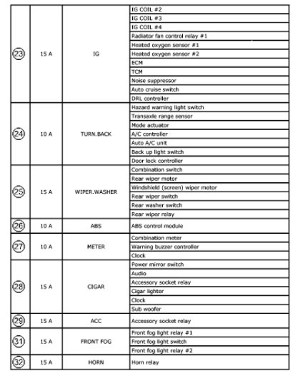

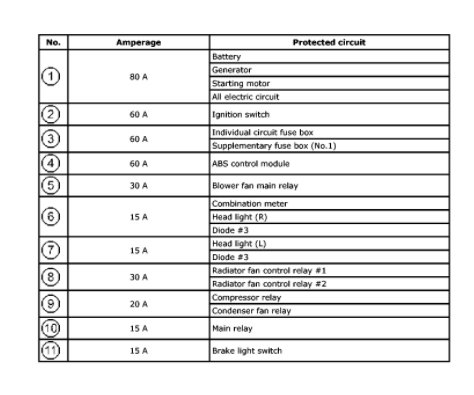

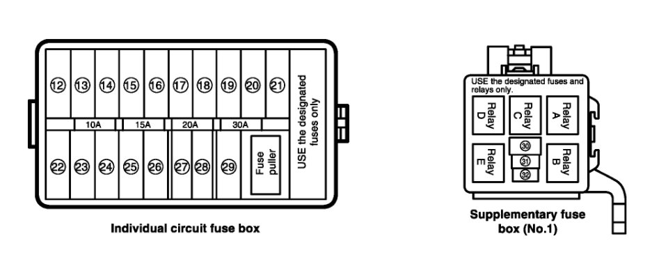

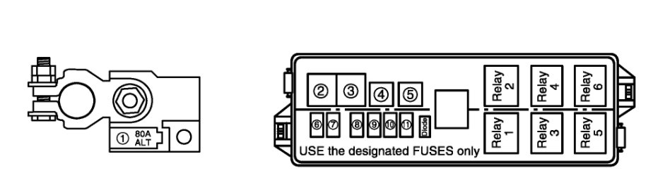

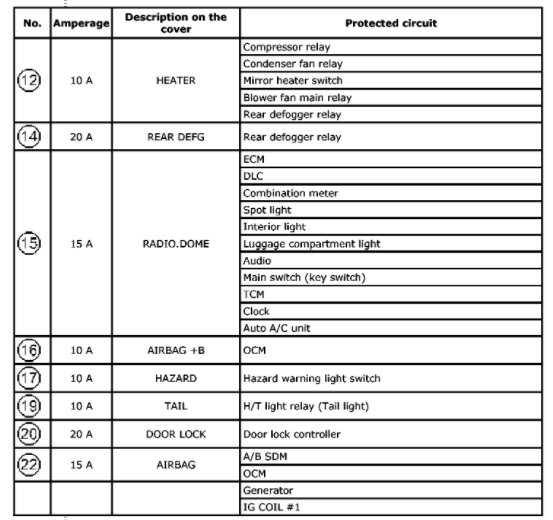

The other day my clock & Temp gauge on the dash of the car started blinking, the seat belt light were on even though both seat belt were clicked into place. The next time I started and ran the car, the symptoms continued. The next time I started and ran the car those symptoms had stopped but the air bag light stays on all the time now. The car needs the fuses checked where are they and how to check the fuse please?

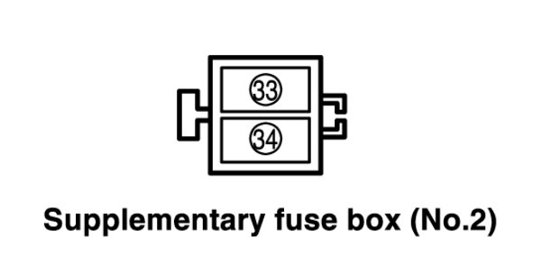

Here is the information you requested. Here are a few tutorials for you to view on how to check and replace fuses:
I've attached pictures below showing the fuse and relay locations on your Suzuki Aerio. Hope this helps and thanks for using 2CarPros.
