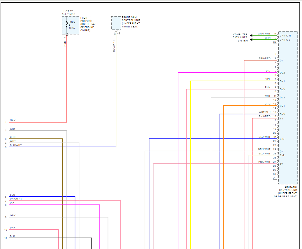

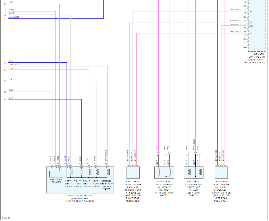

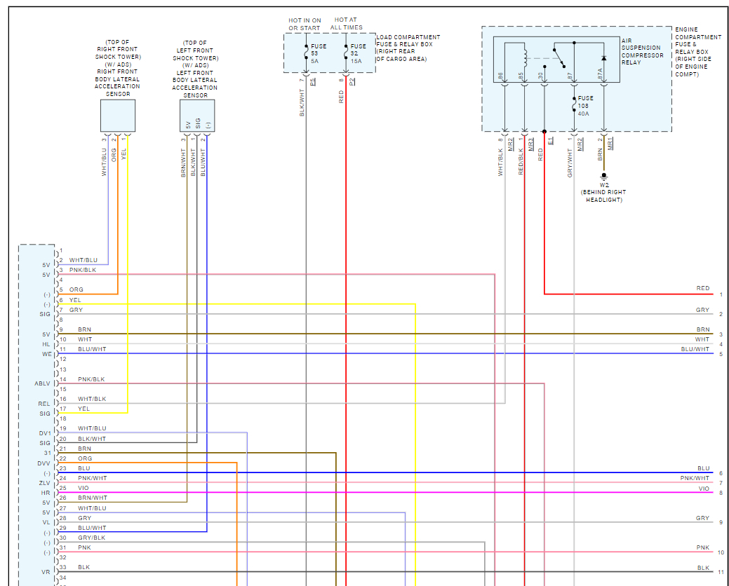

I changed all 4 airbags the air compressor and solenoid and also one of the rear height sensors, but the car still bounces, and the car isn’t rising in the back.
Sep 17, 2024 at 2:22 AM
  • 55,402 POSTS

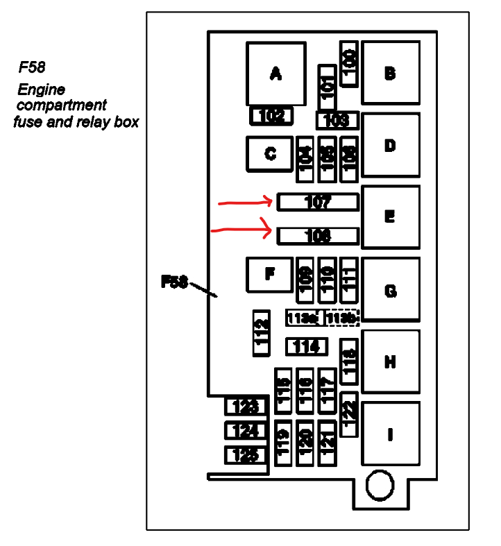

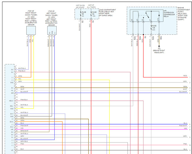

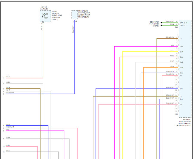

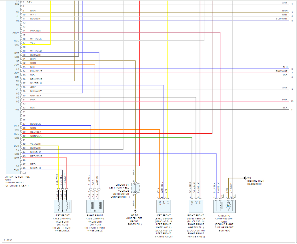

Can you hear the compressor come on or not? If not i would check the fuses for the system which I have included in the wiring diagrams below, also you can see how the system works which helps. If the fuses are okay, I would swap out the compressor control relay which can get overloaded when the system is overworked which happens when the air socks go bad.
Here is a guide to help you check the fuses and I have the fuse and relay locations as well:
It does not give me the relay location so I would look under the fuse panel lid for the listening. Check out the images (below). Please upload pictures or videos in your response of any problems so we can see what to help you with.
