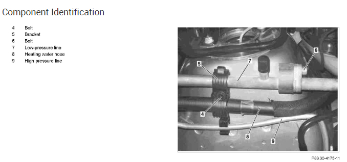

I am afraid I do not have good news. These clutches are not generally repairable in the field. You are looking at replacing the whole compressor. In order to do that you also need recovery equipment and knowledge of how to balance the oil in the system. These pulleys are pressed together using special tools to precise measurements done at the factory.

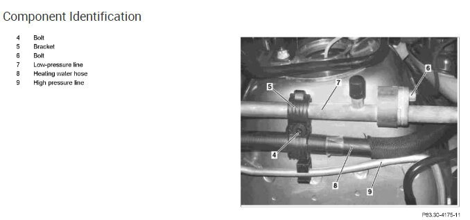

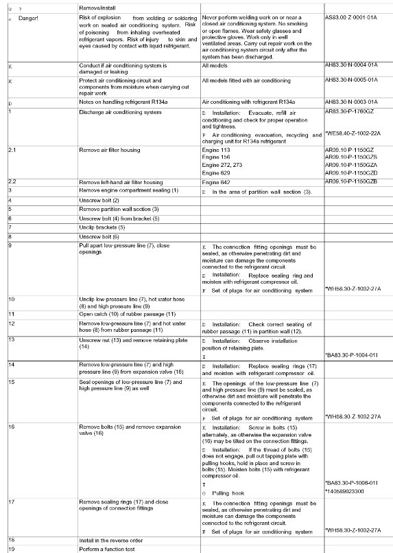

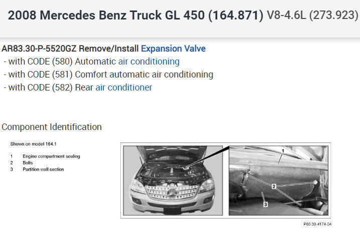

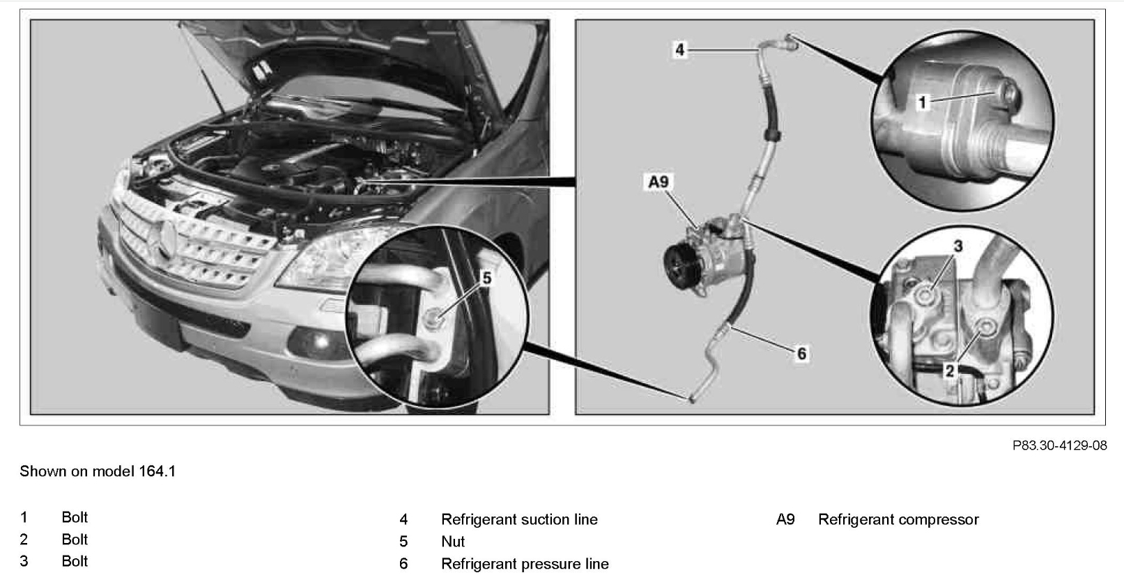

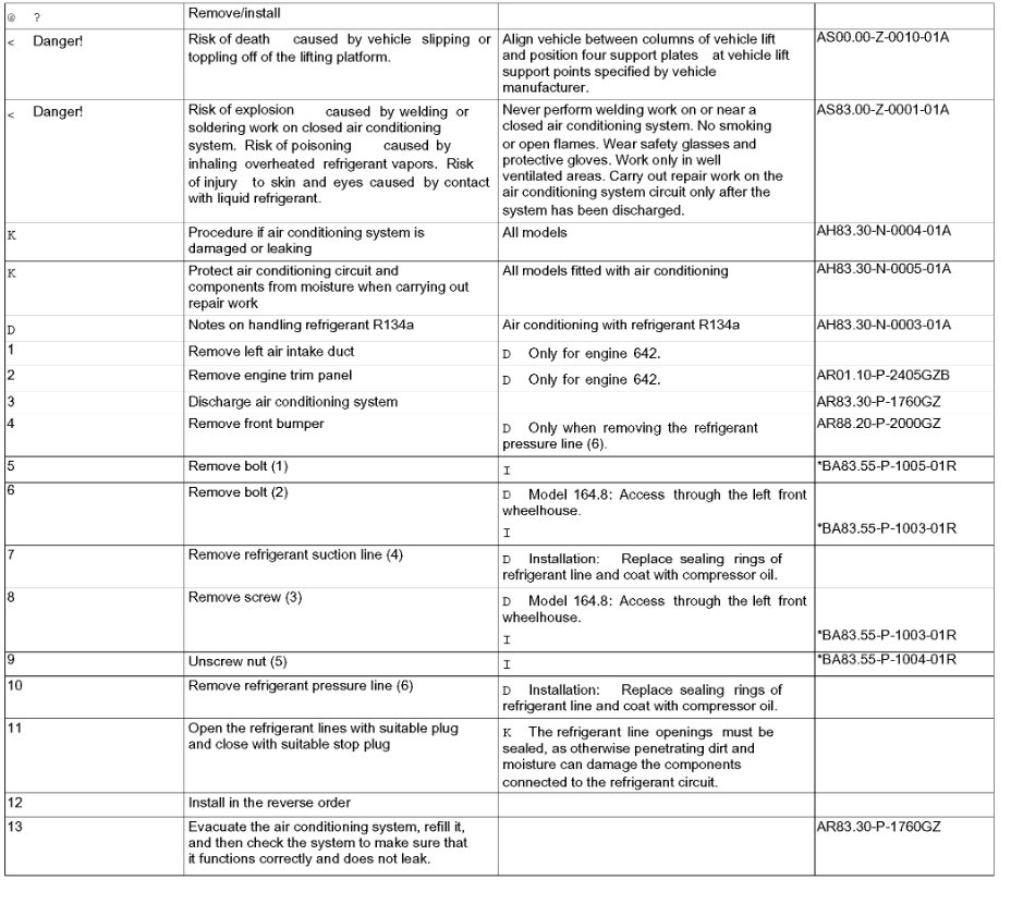

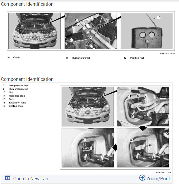

I have the same issue with my 08 MB GL450. AC compressor pulley destroyed itself. I have access to a vacum system and hoses. Besides the replacement of the compressor, how do I determine what other parts need to be replaced? Thx
Sep 3, 2024 at 5:45 AM
  • 55,402 POSTS
If the compressor came apart internally it will spread metal and seal material throughout the system so it will need to be flushed and the expansion valve replaced. Can you tell if there is debris inside the refrigerant tubes? Here is a video to help with the job and how to change out the compressor and expansion valve.
https://youtu.be/4EqdrBVb0sY?si=tqE2yNp1wekpSNq3
Check out the images (below). Please upload pictures or videos in your response of any problems so we can see what to help you with.
