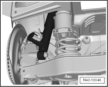

Hi, I recently had my car estimated and the garage said I will need new struts and shocks. I Googled my car and I believe my car only has struts not both?
Apr 25, 2019 at 9:30 AM
  • 110,241 POSTS
Welcome to 2CarPros.

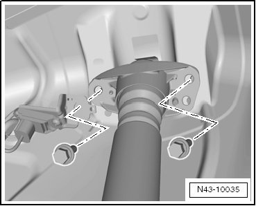

It has struts on the front and shocks on the rear. Here are the directions for replacing the rear shocks. The attached pictures correlate with these directions.

- Disconnect the connector and remove the wire from the shock absorber
pic 1

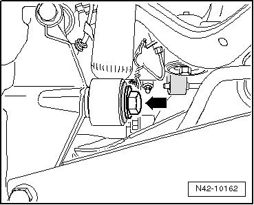

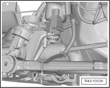

- Remove the shock absorber bolts.
pic 2

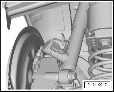

- Remove bolt - arrow -.
pic 3

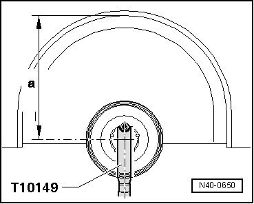

The bolted connections of the shock absorber to the wheel bearing housing must only be fastened when the dimension "a" is achieved! Refer to => [ Tightening of the respective bolts/nuts must then only occur after dimension between the wheel hub center and the lower edge of wheel housing has been attained. ] See: Suspension > Components > Rear Axle, Lifting to Curb Weight Position.
Note the shock absorber installation position.

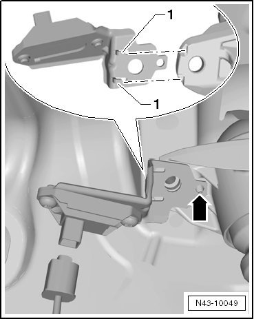

- Mount the retainer on the shock absorber mount from the rear, so that the retainer tabs - 1 - fit into the depressions on the shock absorber mount.
- Turn the retainer forward so that it contact the shock absorber mount.
The tab - arrow - is used for adjusting the rear body acceleration sensor retainer.

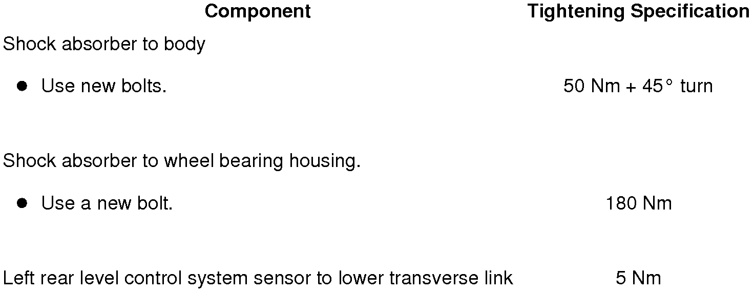

- Install the wheel and tighten the wheel bolts. Refer to => [ Wheel Bolt Tightening Specification ] See: Wheel Stud / Lug Nut > Mechanical > Wheel Bolt Tightening Specification.
Tightening Specifications
pic 7

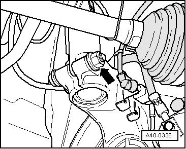

- Remove the nut - arrow - of the connecting link from suspension strut.
pic 8

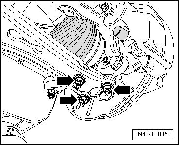

- Remove the nuts - arrows -.
pic 10
- Remove both the wheel bearing housing and ball joint from the control arm.

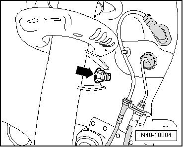

- Disconnect threaded connection of wheel bearing housing/suspension strut - arrow -.
pic 12

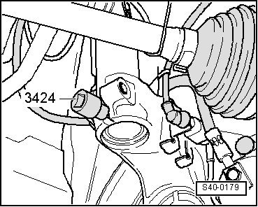

- Insert Spreader Tool Tool (3424) into slot of wheel bearing housing.
pic 13
- Using a ratchet and the Spreader Tool Tool (3424) , open the wheel bearing housing slot.

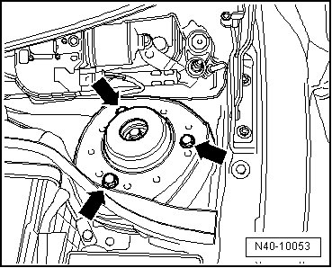

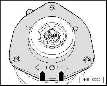

- Remove the bolts - arrows - for upper strut mount and remove suspension strut.
pic 14

- Secure Engine/Gearbox Jack (VAG1383A) with Engine/Gearbox Jack Adapter - Wheel Hub Support (T10149) to wheel hub using a wheel bolt.
pic 15

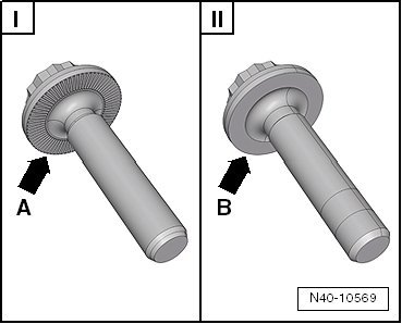

Differences Between a Twelve-Point Bolt with Ribs and a Twelve-Point Bolt without Ribs
pic 20
The contact surfaces - arrow A - and - arrow B - are different on the two-point bolts.
I Twelve-point bolt with ribs - arrow A -
II Twelve-point bolt without ribs - arrow B -

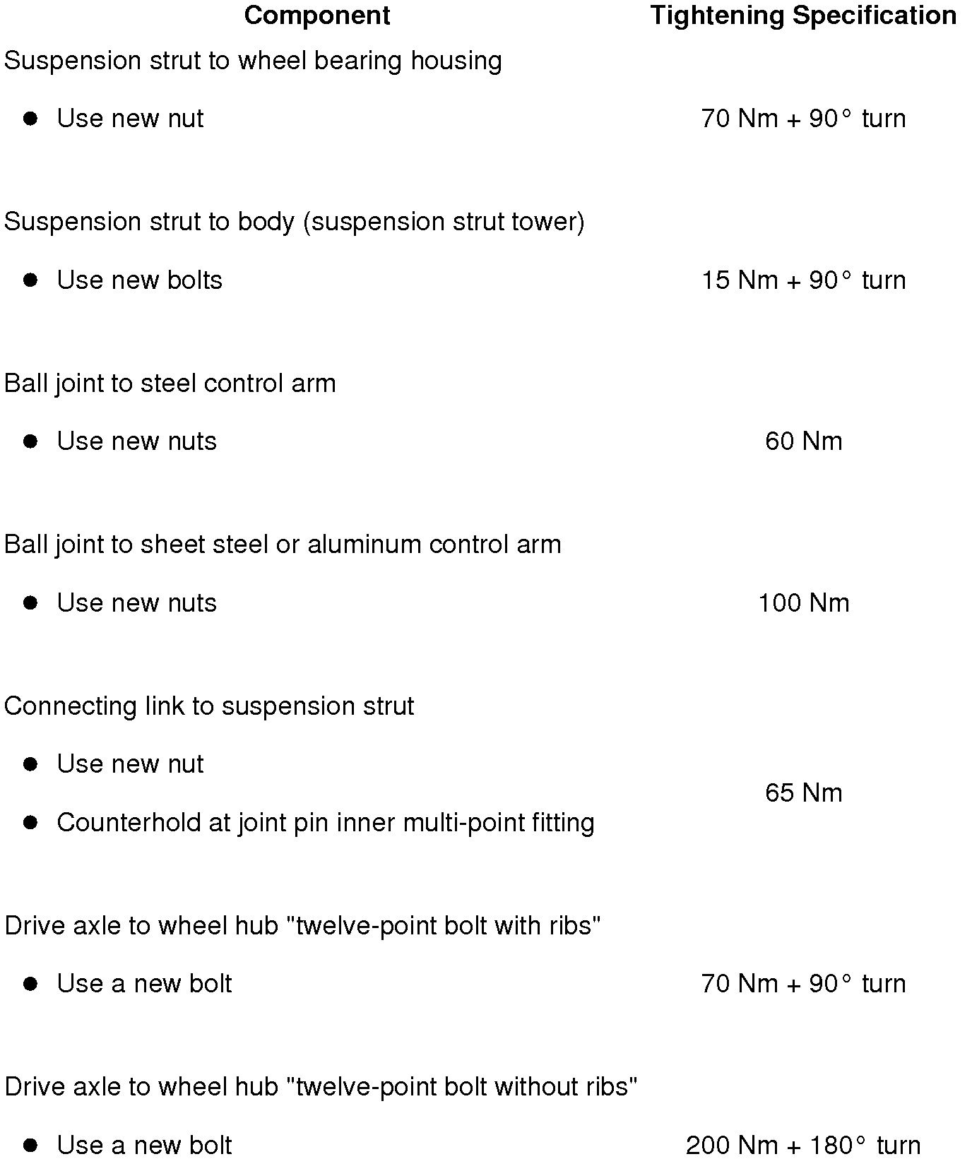

pic 21
