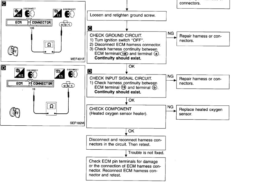

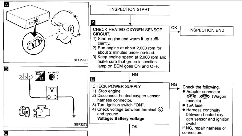

Hi, and thanks. I was able to pull a code. It is Code 33 - Heated Oxygen Sensor.

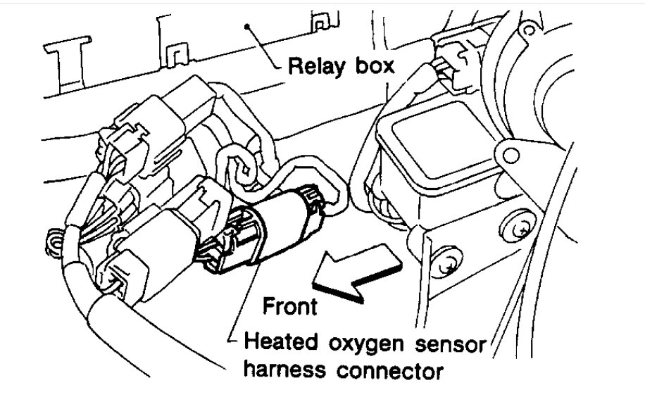

Does that make sense to you? If so, is the heated sensor upstream?

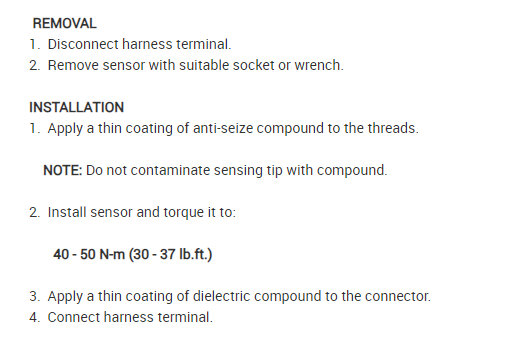

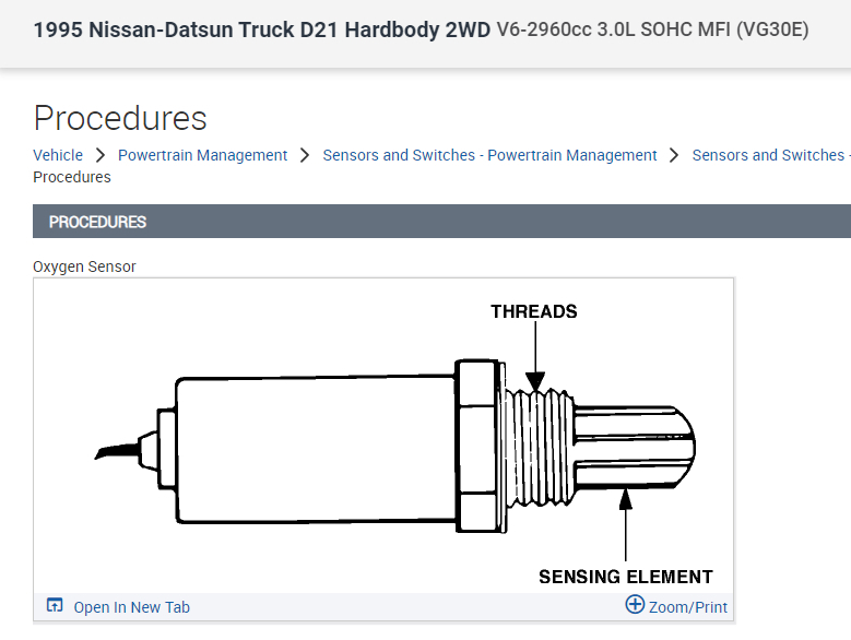

By the way I had an upper hose bleed screw missing. I replaced it and it seemed to do a little better but then back to its old tricks. I also noticed when it's cold it drives pretty good but after warming up a little, by that I mean like 2 minutes, then it loses power again. Fluids are good. If I should need to change the O2, I could use a remove and replace guide also. Thanks, Jose

The sensor's signals are used to control the air/fuel mixture for the engine, so yes, that can be an issue.
If you look at the first two pics below, I attached some general diagnostics for the sensor. Pics 3 and 4 are the directions for replacement. Pic 5 shows the connector location.
Let me know if this helps.
