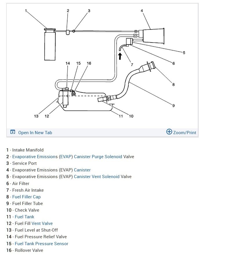

This is a diagram of the Evap vapor management system. Another thing you can look into if you don't see anything obvious on the live engine data is the Mode 6 data, under the Mode 6 data any self-tests that have failed can also give you some direction, you'll need to dig through the scan tool a bit to find it sometimes, but it should be there for a 2010 OBD2 system.

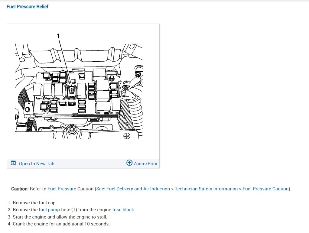

Can you graph sensor signals with that scan tool? APP should set codes, yes, how was the Evap tested? I've seen the purge on these put on backwards before if it's been taken off before, very strange the hoses can hook up opposite, but it's possible and manifold vacuum pulls the valve open when on reversed.
Your Fuel trims look normal, even cylinder misfires can cause fuel trims to go either direction. You could try graphing the APP, looking for dropouts and correct voltage levels. But I would expect a code for an APP as well.
Also graph the Oxygen sensors, they should respond very fast and go rich under wide open throttle and then lean when decel due to injector cut-off. Slow response could be an oxygen sensor heater fault. If they go lean under wide open throttle, then you could have a fuel pressure/volume problem. So, you can see these cars have a lot of different problems, some have one after another. Are there any other details you can give?
Mar 2, 2025 at 5:29 AM
IMTOOLER59
  • 28 POSTS
As mentioned previously according to the scan tool the evap system is good. It runs pretty good in all other conditions. Only on acceleration do I notice any issues. I never thought of fuel pressure, is there a port on these little cars to test it?
Mar 2, 2025 at 5:54 AM
AL514
  • 5,656 POSTS

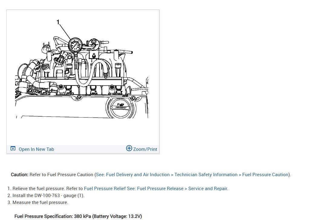

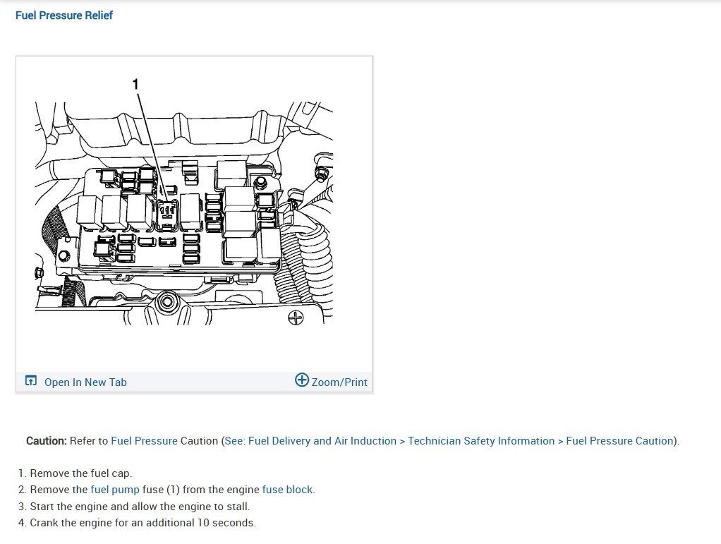

Never fully trust a scan tool test, it's only one part of the diagnosis. When it comes to the Purge valve on these, they can stick open if the charcoal canister fails, you shouldn't be able to blow any air through it one direction toward the intake manifold if it's not energized. But keep track of the direction the lines are on it before disconnecting. I have seen them stick open due to a small piece of a failed charcoal canister, check that the purge isn't stuck open by any amount. but there looks to be a fuel pressure port on the rail, here's the service info on it. Make sure it holds fuel pressure at key On as well, if there's a bad check valve in the fuel pump assembly it will drop off pressure quick, this is a return less system so if pressure drops off too fast I block off the fuel rail to see if it's the pump or injectors leaking down.
https://www.2carpros.com/articles/how-to-test-a-fuel-injector
Mar 2, 2025 at 6:12 AM
IMTOOLER59
  • 28 POSTS
I haven't done the pressure test, but I graphed the fuel trims, and it appears to go lean on accel. But I'm not sure I trust my scan tool, it seemed to respond slowly and kind of hard to read. Also, my APP is good.

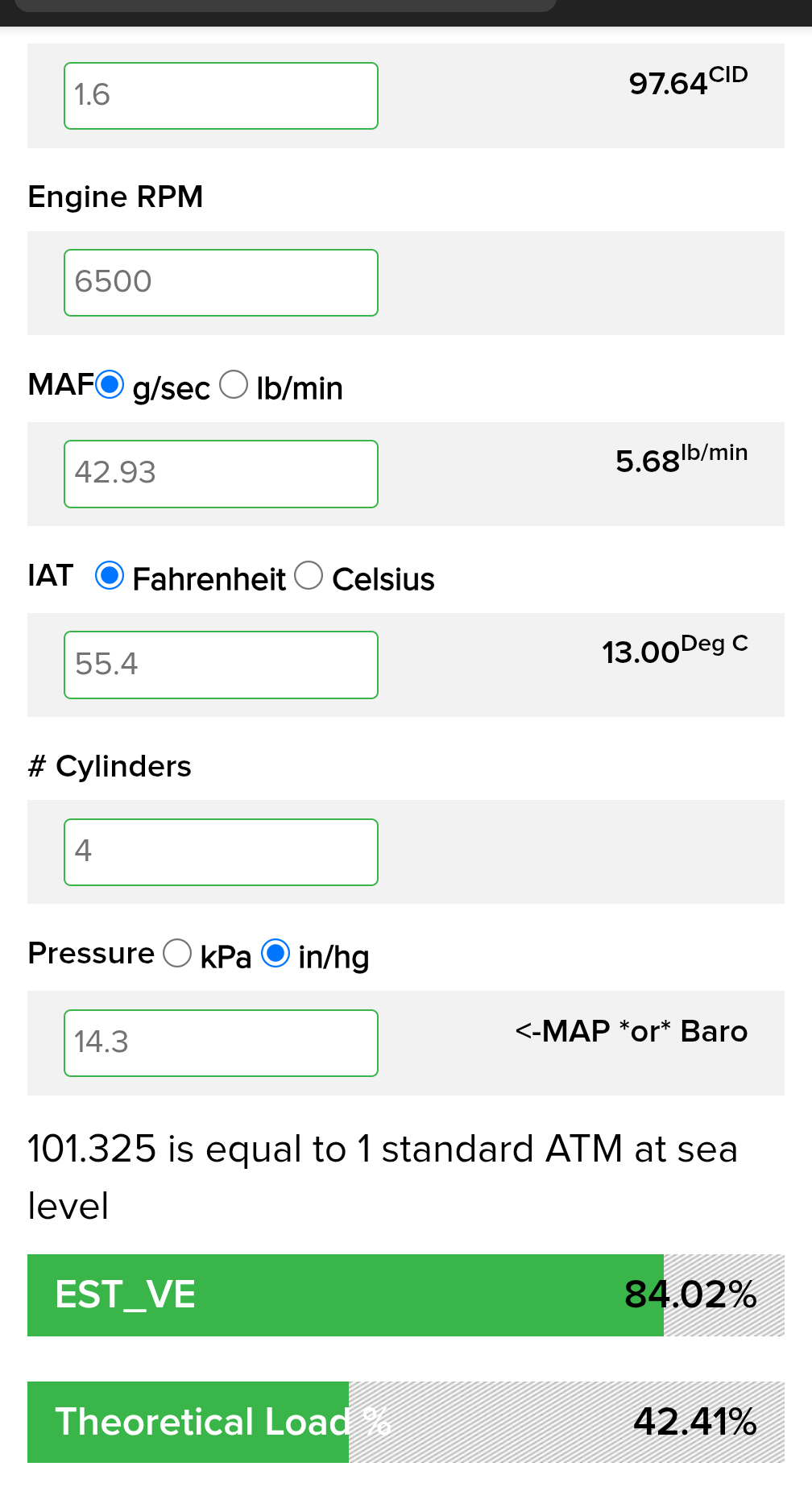

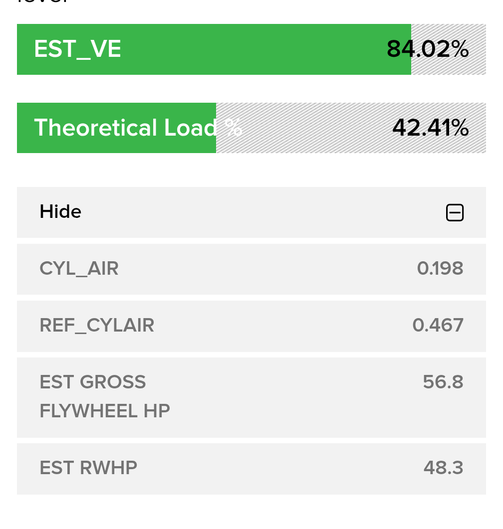

I did the VE test, it may or may not have been WOT. It was very near redline and screaming. Here are results. I'm not a certified tech but I consider myself a fair mechanic, but this little car is testing everything I understand about cars, but I am an old school points ignition type mechanic mostly but I'm learning more all the time.
Mar 7, 2025 at 11:12 PM
AL514
  • 5,656 POSTS
Okay, this peak RPM is good, I know doing this test the vehicle does seem like its screaming, that's why we record the live data and scroll back to that highest RPM to get our data, you can see it would be very difficult to get accurate data at that one point. I would be curious to see if the Calculated Load was close to the Theoretical Load.
Is this data from the manufacturer's side of the scan tool or global OBD2 scan data? If you're on the Chevy side I would try this test again under global OBD2 scan data, just to be sure you're not getting any substituted values in there and grab the Calculated Load and Long Term/Short Term Fuel trims as well. I'll say this is a difficult vehicle, without any obvious issues showing under up. No codes, 02 seems to be responding correctly. But the comment on the fuel trims under accel has me wondering about the MAF not reporting correctly or low fuel volume. I assuming the 02 is going lean as well under accel, possibly staying low voltage the entire time when it should be going rich.
I found a good video that will help with the VE test a bit more. but since this is just under some code setting criteria and making a call on expensive sensors or a cat without being sure can be costly. In the video he goes into the fuel trims more and what to watch for if the MAF is under reporting air flow, right around 6min in, he explains about the ECM and its fuel calculations. If the MAF is under reporting air flow going into higher RPMs you should see some correction in the fuel trim numbers due to the 02 feeding back a lean exhaust. That wouldn't really show up for a long term (learned value) so much because the vehicle is rarely at these high numbers.

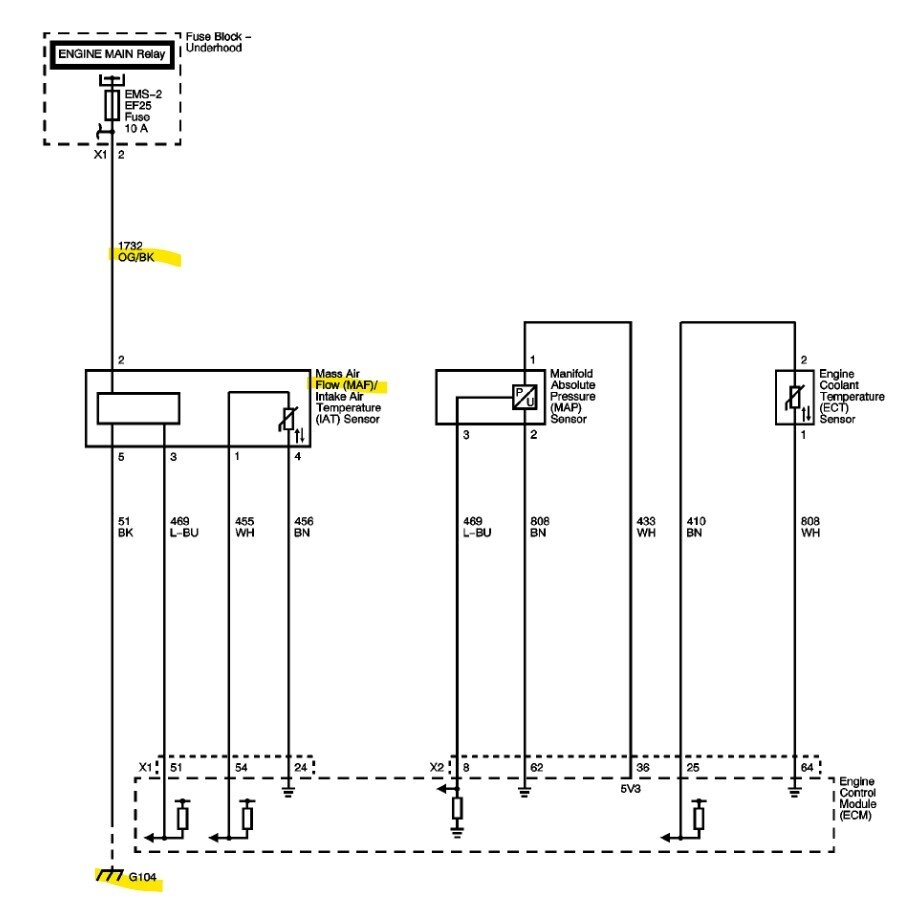

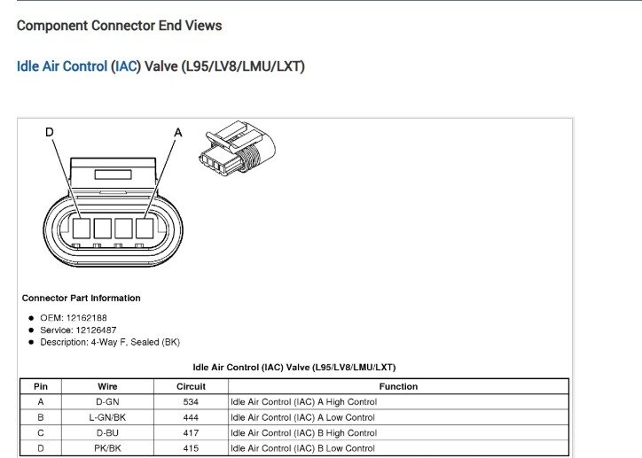

I added the OEM wiring diagram for the MAF if you need to check its powers and ground.
I'm really curious to see what the fault is on this vehicle, it's a close call, but the fuel trims under acceleration is a clue here.
Being at almost 84% VE, I don't think it would be a cat, but if you want to double check that, you can do a back pressure test at the front 02 location. You shouldn't be over 1.5psi at idle, I use an old 02 threaded section with an adapter for my vacuum gauge, you don't need to keep it on there long, just long enough to get a reading. I have seen people melt their vacuum gauges with just leaving it on the exhaust. Most restricted exhausts will show a much higher number right away and its almost something you can hear on these smaller engines; with that sort of hiss they make when the exhaust is just pushing out any place it can. Let us know what you find.

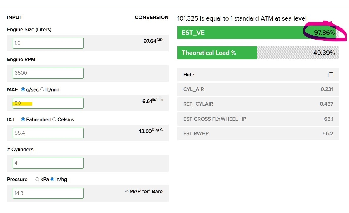

I don't think the cat is the issue either, if you mess with the VE numbers just a little, such as changing the MAF reading just to 50g/s increases the
est_ VE to 97.86%. With that said, you could run to AutoZone grab some MAF cleaner spray (follow the instructions on the can) and see if just cleaning the sensor makes a difference. It's good to have a can of MAF cleaner anyway. Check the MAF voltage and ground, use a test light across the two pins of the MAF connector, orange/black is B+ from a 10-Amp fuse, and the black wire is the Ground.

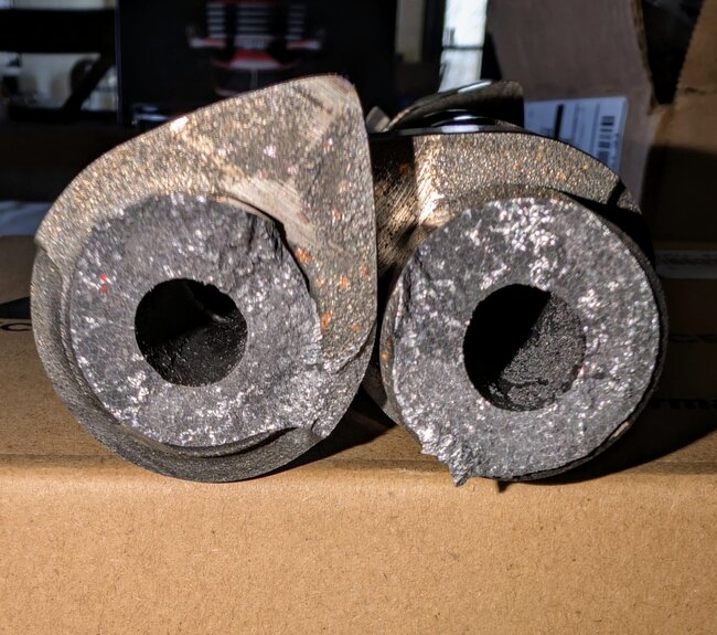

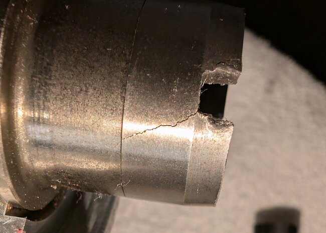

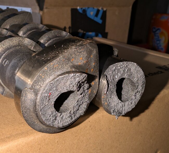

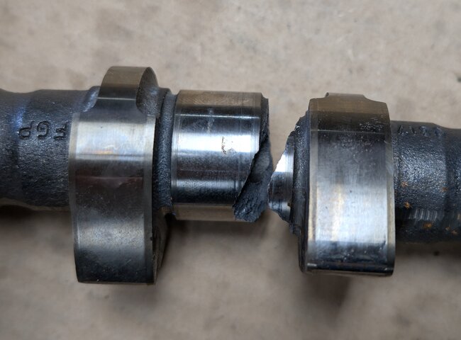

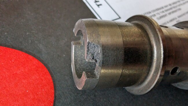

After all that I pulled the head to do a gasket and found a broken intake camshaft but yet it was running. Imagine that. I had to do the head gasket because it was overheating bad.
Apr 6, 2025 at 9:19 AM
AL514
  • 5,656 POSTS
A broken cam? Where exactly was it broken and can you take a picture? That was really not expected, I was curious what the outcome of this would be. I can't believe there were no misfire codes with part of a camshaft not moving. I'd really like to see a picture of that. Thanks for letting us know what the fault was.
Apr 7, 2025 at 1:42 AM
IMTOOLER59
  • 28 POSTS

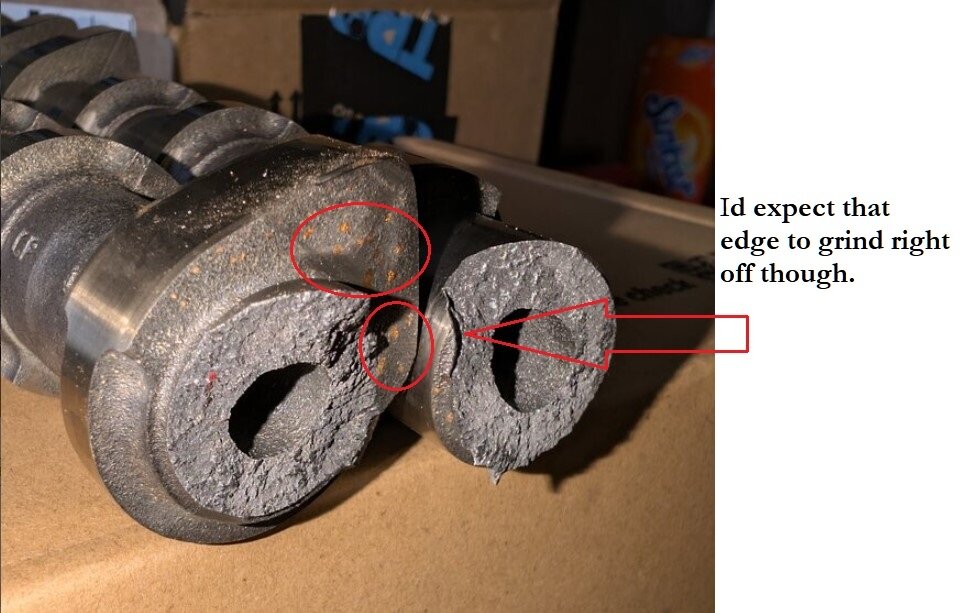

Yes exactly, but the camshaft was still rotating. It broke in such a way as to be keyed together. Also, it did no damage to the journal. I was blown away. You can see the rub marks where it was contacting.
Apr 7, 2025 at 6:31 PM
AL514
  • 5,656 POSTS
Oh wow, hard to believe all this caused was a little surging. I do wonder if this would have showed up on a cylinder leak down test, or possibly a running or cranking compression test. I can understand how the cam was semi locked in place, but even at the breaking point, I dont see anywhere that looks like it was lacking oil at the cap location, or even any worn lobes. So the right end there, thats where the cam actuator is on this engine correct? And the cam sensor is at the other end where the notches are.
And you didnt find any stuck valves or anything like that on the broken side of this?
Its difficult to say is the metal was porous at the breaking point, since obviously there was some movement against the two broken ends together, I see some metal flakes inside the holes. It looks like it might have just been a manufacturers defect, but I would really inspect for anything that could have caused this. Maybe still do cylinder leak down testing to make sure no valves are effected, you dont want to get this all back together and find out it now sets misfires codes and something else Id be concerned with is all that metal flaking, Im sure some of that migrated into the oil journals and down into the oil pan.

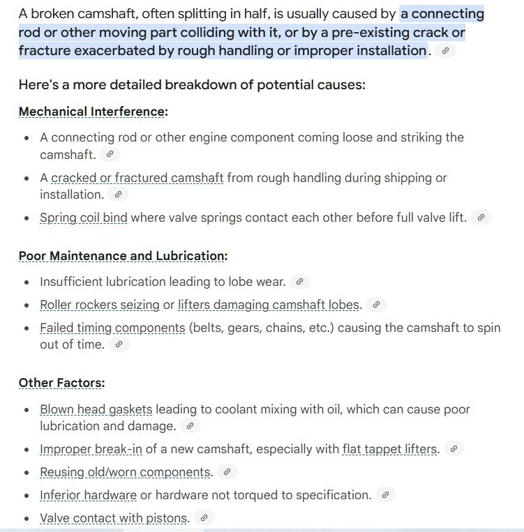

Just off hand, and checking some other information, I found some mechanical causes of this such as a valve spring, rocker arm seized up or connecting rod coming loose, but I think you would have heard some thing like that, I mean a rod thats loose would be making some serious noise. And the breaking point does not look like there was a lack of oil there, it doesnt look burned or gouged where that cap was. And camshaft bearings will make some serious screeching noises when they start to go bad. I had one that I was almost positive it was the serpentine belt screaming, but it turned out to be a cam bearing.
I did a search too just to see if there were any other causes I wasnt thinking about.
Thank you for sharing these pictures though,, very interesting case study, its a first for me, considering there were not codes, I assume it wasnt making any apparent noises either.
I also wonder if this engine had been apart before, and something wasnt torqued to spec, thats something I else I saw. If dont find any other issues, I guess we go with manufacturer defect.
Are you planning on just replacing the cam? If so, I would measure the clearance on that cap where it broke. Id use Plastigauge to do it, if I spelled that correctly. I dial bore gauge would work, but the plastigauge would give a more accurate reading. You might even want to cut open the oil filter and see how much metal particles are in between the layers of the filter. Hopefully the engine is damaged. But keep me in the loop as you go, and thanks again for posting the fault. I really appreciate it. Not the outcome we thought at all.

This is an overhead cam so there is no rockers or push rods, it's direct cam lobe to valve caps/cups and since it just came back from the machine shop, I assume they did a full inspection before machining. so, I wasn't informed of any valve issues, but I will thoroughly check things out.

Okay, so it has the same setup as a Suzuki Forenza, with the valve springs under the shim caps. I had one of those recently with a broken timing tensioner that smashed all 16 valves, so I remember the design. I wasn'tt sure if you were sending the head out to get machined or not, that was a good call. I'm sure its okay then. Just make sure to do another oil change after the first start up so if there's anything particles left over, they can be cleared out. Did you find any coolant in the oil due to the head gasket? Although contaminated oil can cause a cam failure, I'd think it would look scored under that cap as well, but it looks surprising smooth. Do you have the valve clearance specs to check the shim caps, or did they take care of all that for you?

Strange enough I didn't get coolant in the oil, this whole thing has been very odd from the start. It started out being oil in the coolant which led me to change the oil cooler but at the time I didn't know I had another issue which was the overheating. Before that I replaced the valve cover gasket but didn't see the broken cam. The machine shop didn't see it either until he loosened the cam to do the machine work.

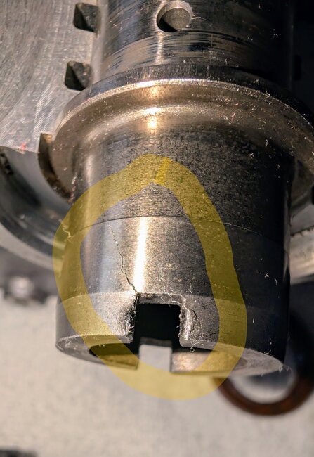

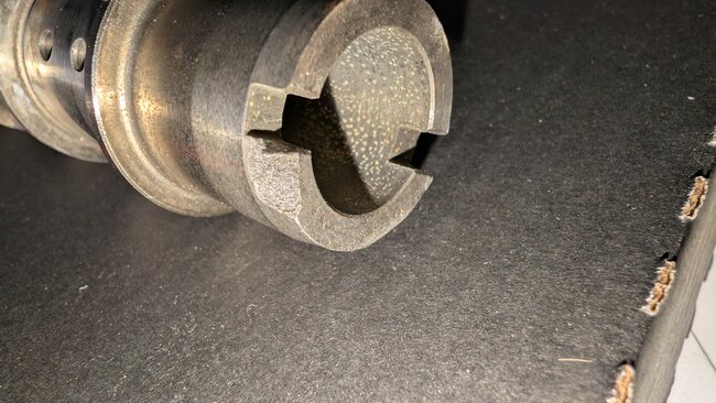

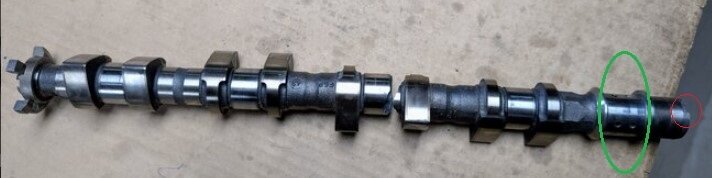

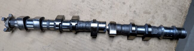

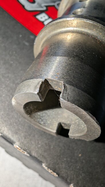

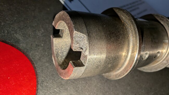

I was preparing to begin reassembly when I found this on the (Exhaust) camshaft.
(See pic). What is going on with these camshafts? What could have caused this kind of damage but still run okay? Also, it was in perfect timing when I disassembled it. Notice almost no wear on the lobes or journals.
Apr 9, 2025 at 4:58 AM
AL514
  • 5,656 POSTS

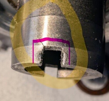

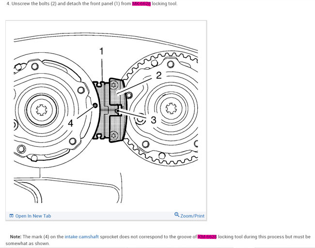

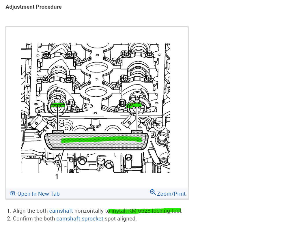

Oh boy, the opposite end where the cam sensors are it has notches as well for the flat camshaft hold tool. There is one for the front as well (diagram 2), but its really tough to say what happened here. Something just doesn't seem right though.
So, what did the machine shop do exactly? just resurface the head? I wonder if they used an impact gun when removing the cam bolt, I mean this is a lot of internal damage and I just don't see how a cam broken in half didn't set any cam position sensor codes or anything at all. With no marks or signs of overheating under that cap where it broke, this area in diagram 3 where the notch is, looks like there was serious vibration on the cam actuator, you can see it looks like the lower notch wasn't affected like this. But we don't have the entire history of this vehicle, such low mileage for such major problems. To be honest, when these cars start having problems, it doesn't seem to end, I don't know if it's the quality of parts GM used on them or what. Going forward if you are going to keep the car, I'd use a really good synthetic oil and there was even a TSB on using ACDelco oil filters only. Unless you fix it and sell it. It's got low enough mileage, I did a search on internal engine damage and really only came up with the oil filter TSB, but I'm sure more in-depth searches will show more issues with other vehicles. I just don't want to see you have more problems in the future.

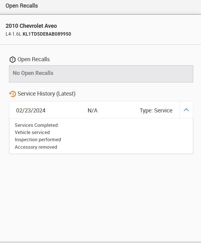

If you give me the vin # I can run it through service info and see if any recalls or service records, come up. But that crack there seems like the actuator on that cam must have been vibrating on that notch to make marks like that. Maybe the bolt wasn't torqued to spec, makes me wonder what else might be damaged as well. Was there a magnet in the oil pan on this? or any metal particles you noticed in the oil. See if the VVT solenoid screens have anything in them as well.
Apr 9, 2025 at 12:47 PM
IMTOOLER59
  • 28 POSTS
KL1TD5DE8AB089950
Yes, I just had it resurfaced but I would have thought that finding the broken camshaft would have raised curiosity and caused them to at least check the rest of it out. I checked the screens and all is clear. I did use an impact to remove the actuators, but it didn't take too much effort to remove. And they didn't seem to be loose as to be banging around. None of this makes any sense. It's all new to me as I'm not used to working on these little motors, I've had big V8's most of my life.
Apr 10, 2025 at 8:54 AM
AL514
  • 5,656 POSTS
I didn't find any open recalls and there is a mile long list of TSBs, I ran through them really quick and didn't see anything related. But where that cam broke, I can't see how it wouldn't have set misfire codes and VVT codes. These cars set VVT or cam timing codes at the slightest hint of being off. Does the cam have a marks on either end like it may have been dropped? I know I'm kind of throwing the machine shop under the bus here, and I may be wrong, it could have just been a cam that was manufactured where it was weak at that point, but even with the way the broken section has that small point that looks like it could lock in place, I really don't think that would hold the whole in place, in time. Theres just too much force it has to overcome. If you think about how tough it is to turn an engine over by hand that has the spark plugs still in. I do think I see some small rust points, but if you think about it, this camshaft snapped in half, and then just stayed perfectly in place!?? And there are no other issues with the end that broke off, I'm just skeptical. I did a search for broken cam videos, and they are all pretty much the same, a no start condition with a really bad cranking cadence.

Yes I did find something on the actuator end, but also, I can't swear that it wasn't already there when I took in. I agree with all that you are saying but also, I can't prove or do anything about it if it was dropped at the shop.
Apr 11, 2025 at 4:18 AM
AL514
  • 5,656 POSTS
I don't like the look of that, maybe at least look up the machine shop and see if there are any reviews about it. With the price of parts these days, they may not want to say anything. But yeah, I agree with you. Can't really prove anything without the before pictures. You could bring it to their attention and see how they react. It's your call, I sorry it turned out this way. It was a cool case study, but not so much when you have to pay for it. I do appreciate you sharing the end results though. Not every day you see a cam snapped in half, I'm definitely saving the pictures. If it's possible, you may want to get rid of the vehicle after it's repaired, I know these have a lot of problems, but so does my vehicle.

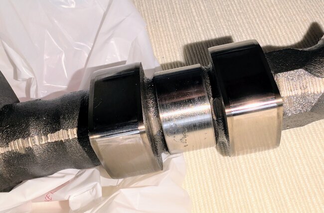

Well after 2 new camshafts, head resurface, timing belt and pulleys, o2 Sensor b1s1, cam sensors, new gaskets and seals and thermostat and housing, and a throttle body cleaning, it runs like top, finally idles smooth but guess what? Still surges on acceleration slightly, I haven't gotten fuel trim readings yet, but I'm convinced it has something to do with the TB.

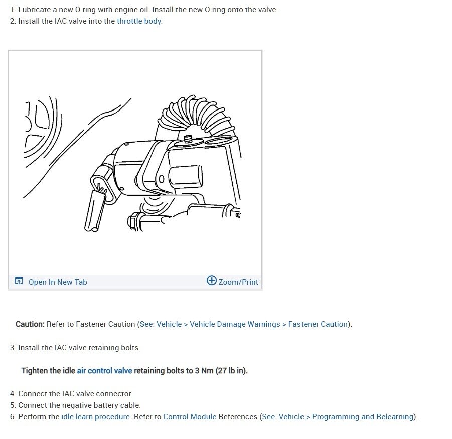

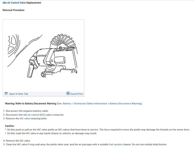

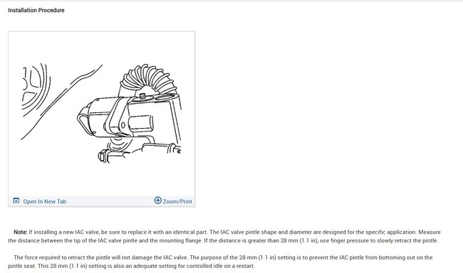

Does this vehicle actually have an IAC valve along with an electronic TB? I cant imagine it does, but for whatever reason they show one in service info according to that VIN #.

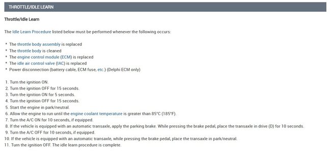

But heres the TB relearn procedure, that will need to be done since everything has been disconnected (diagram 1). The rest is just service info on an IAC, but I dont see one in the wiring diagrams. It looks to be for certain engines, probably built in other locations.
