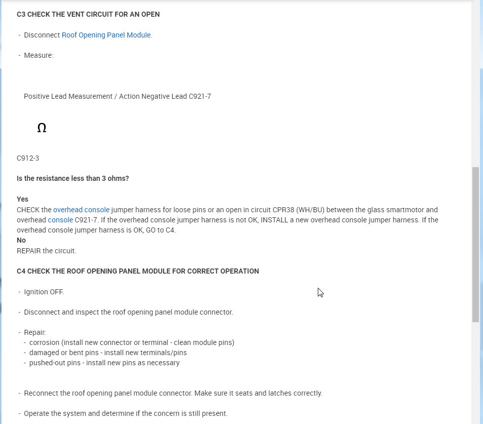

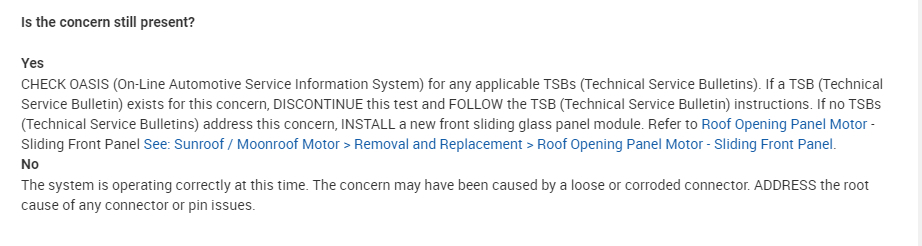

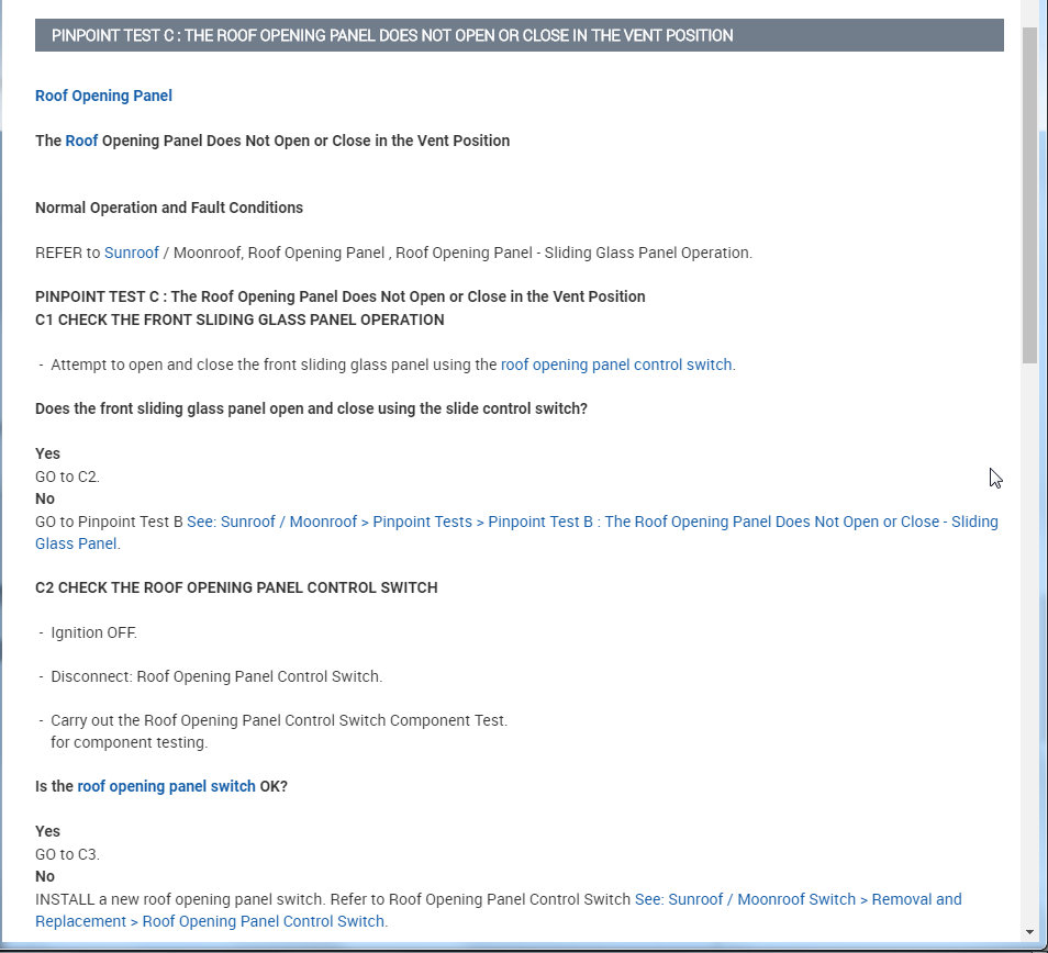

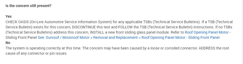

I have replaced the sunroof motor and switch and the sunroof still is not working.
Jul 27, 2020 at 1:31 AM
This could be the cable is binding or another electrical issue. I attached the testing that we need to run through in order to find out what the issue is.
Let's run through this and see what turns up. Let us know what you find. Thanks
