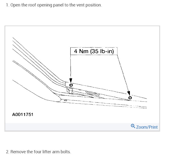

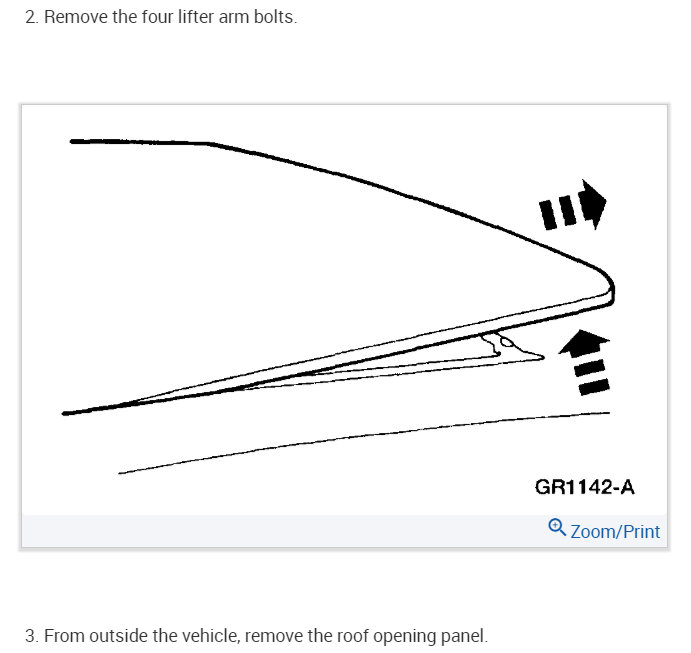

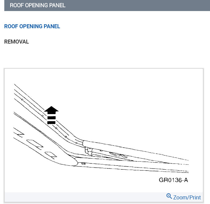

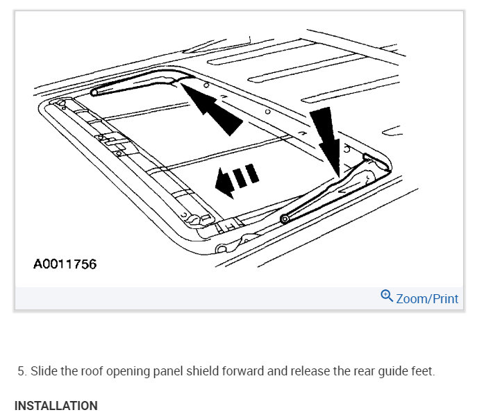

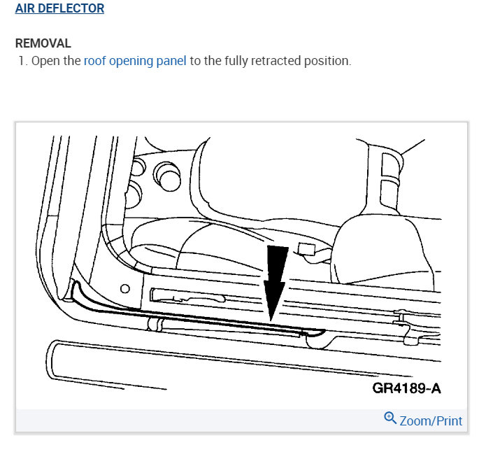

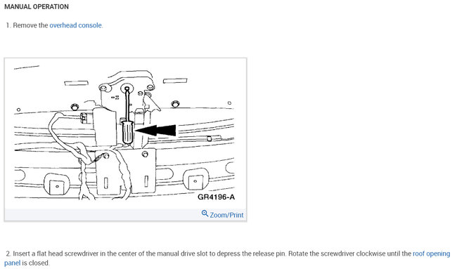

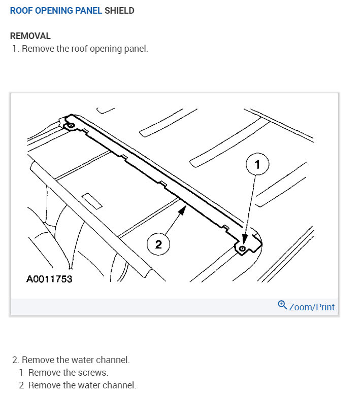

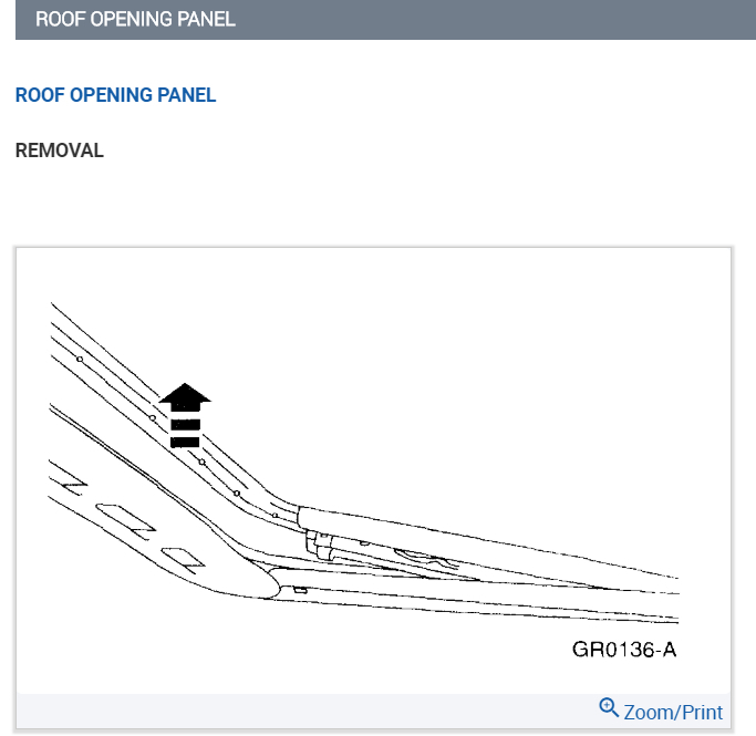

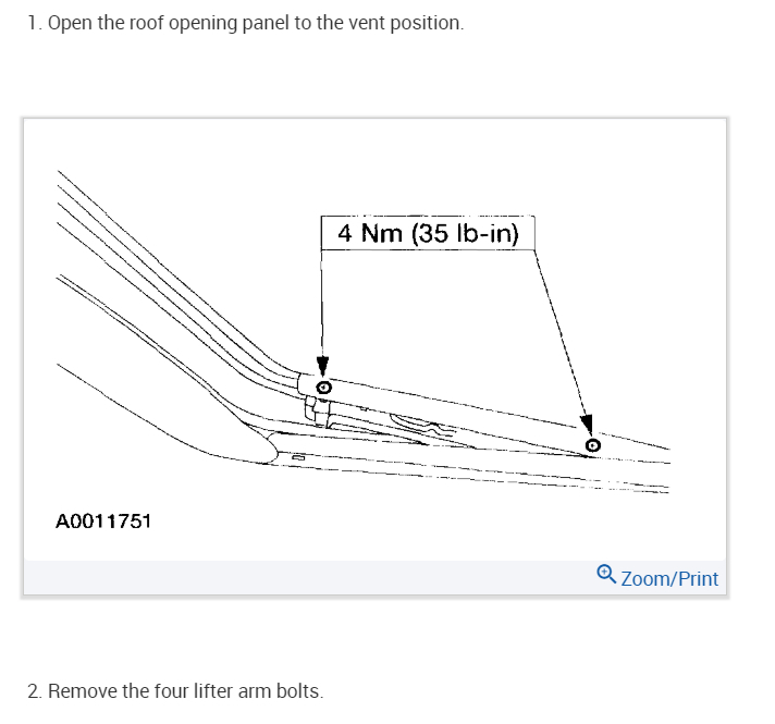

My sunroof is stuck in the tilt position. How do I drop the overhead console to replace the switch or check the wires to the motor?
Mar 7, 2009 at 2:57 AM
DAVE H
  • 13,384 POSTS
Hello ..
Hope this helps. Let me know if you need any more information.

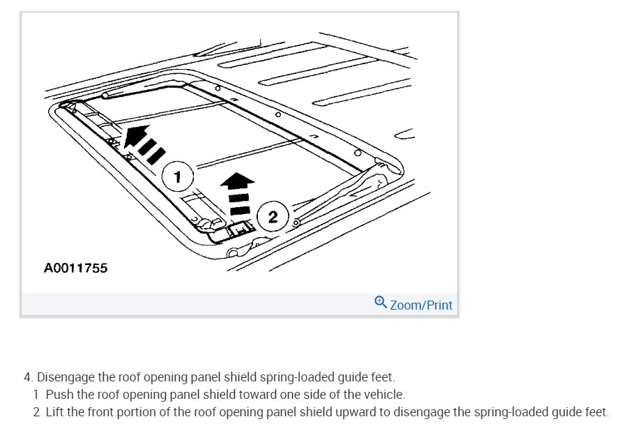

Insert a flat head screwdriver in the center of the manual drive slot to depress the release pin. Rotate the screwdriver clockwise until the roof opening panel is closed.
Inserting flat head screwdriver in center of manual drive slot to depress release pin.

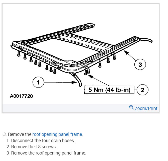

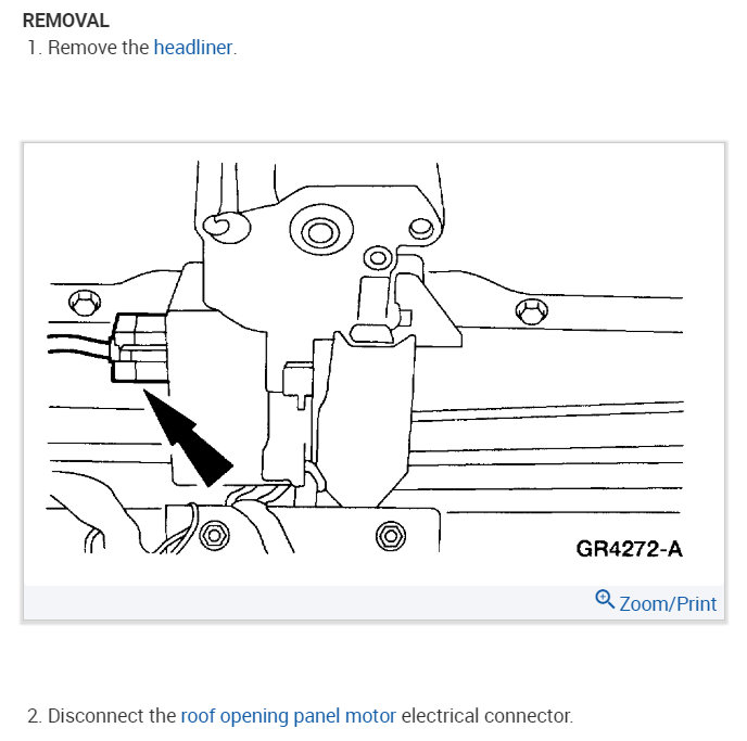

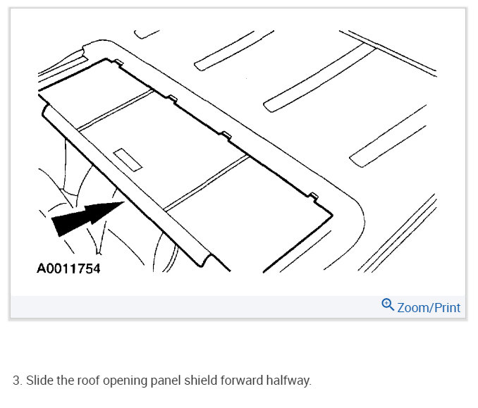

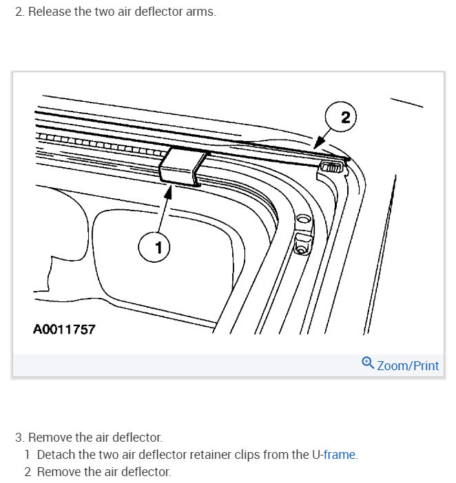

Here are sunroof repair guides below. Check out the diagrams (below). Please let us know if you need anything else to get the problem fixed.
Cheers

I "think" you need top drop the liner. The motor is usually part of the sun roof assembly.
