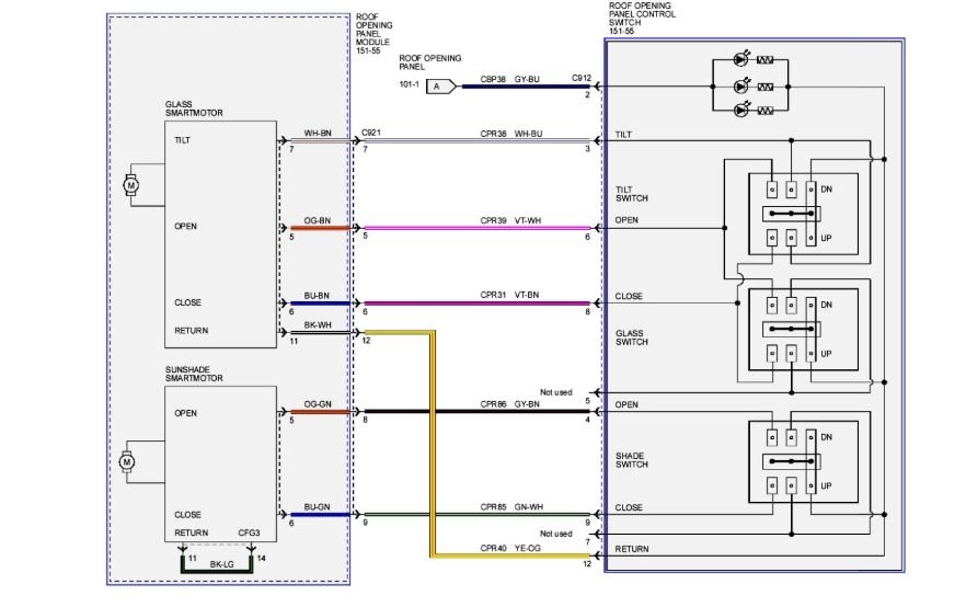

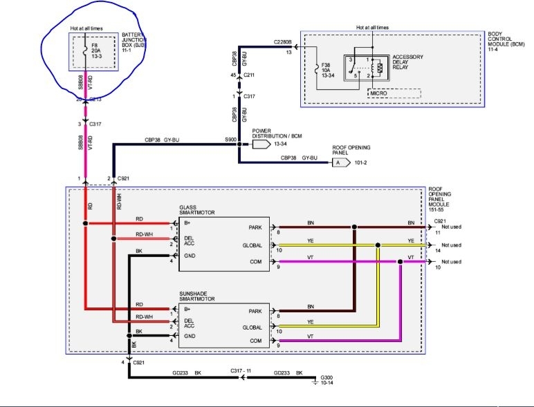

I attached 2 diagrams and there are 2 fuses for the module. Make sure they have power on both sides and that there is power to the module from both feeds.
If they are okay, then you have an internal failure in the module.

I found and checked F8 - looks good.
F38 looks like a relay, could not find fuse for that. not sure how to verify if that is good or bad?

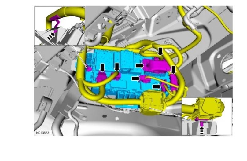

It is a fuse. It is on the body control module or the GEM module.
It is under the dash left side.
