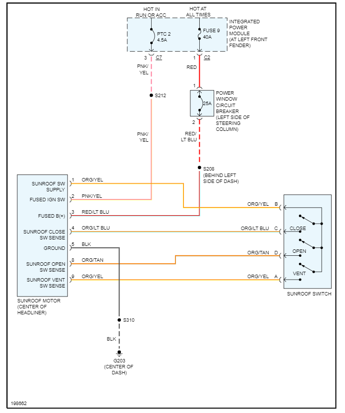

I opened up the sunroof on my ride home and when I stopped the glass would not close. I popped the switch and checked it with my meter, and it checked out good. I am not getting any power to the plug and cannot find a fuse or relay for the sunroof. Any ideas?
Jul 5, 2023 at 5:34 AM
  • 55,456 POSTS
The power for the sunroof comes from the TIPM fuse # 2 - 4.5 amp and fuse # 9 - 40 amp under the hood. Here is a guide to check them for power please check them with the system on, and I have included the sunroof wiring diagrams so you can see how the system works.
Check out the images (below). Please let us know how it goes
