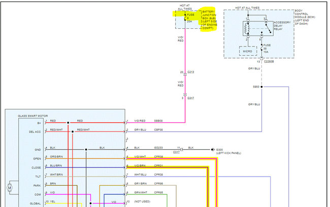

My sunroof will not open but the sun shade does, but only half way.
Feb 10, 2021 at 2:42 AM
  • 110,240 POSTS

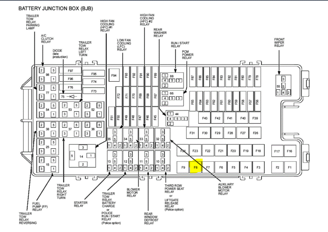

There could be an issue with the switch or the control module. However, I need you to check something simple first.
Under the hood is a fuse box on the left side. Locate fuse 8 and confirm it is good. In addition to checking the fuse, I need you to confirm there is power to it.
Here is a link to help:
Also, I attached two pics below. Pic 1 is from the wiring schematic. The second pic shows where the fuse is located in the fuse box.
