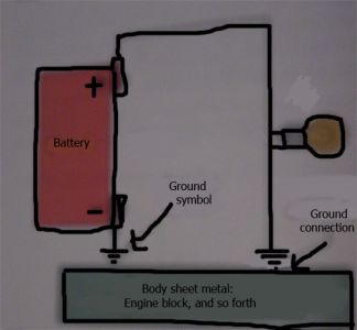

NICK MAPLE
  • 28 POSTS
https://images.2carpros.com/forum/automotive_pictures/435144_battery_1.jpg
If the battery is gone there shouldn't be any ground.
May 9, 2010 at 8:11 PM
CARADIODOC
  • 34,381 POSTS
Sorry to get so involved. 99 percent of people don't have your understanding of electrical theory.
The battery doesn't provide the ground. It is simply connected to ground just like all of the other loads and sources. In his case, the generator is a source of system voltage just like the battery is. Think of a diesel truck with two batteries. Both have their negative cables connected to ground. Either one alone would power the systems. Now imagine you're replacing one of the batteries with the generator.
"Ground" is just a term we give to a common connection point. In the tv world we also have a name for the common power supply. That is "B+", a reference held over from the days of "portable" radios that used an A, B, and C battery, in case you care. We could also say the battery positive cable is tied to the B+ circuit, but that doesn't mean it develops the circuit, just that it is connected to it. Same for the negative side. It doesn't develop the ground, or common point, it is just connected to it.
Let me know if my descriptions made things worse.

NICK MAPLE
  • 28 POSTS
I...c, I understand where my confusion is. "Ground" what is ground really? I thought it was a connection or rout for all electrical components to the negative side of the battery. You stated that "The battery doesn't provide the ground. It is simply connected to ground just like all of the other loads and sources."
What is "ground" if it is not the path to a battery's negative terminal to complete a circuit?
Thanks in advance,
Nick
May 10, 2010 at 10:43 AM
CARADIODOC
  • 34,381 POSTS
"Ground" is just the name we give the common point. The generator also needs a complete circuit for current to flow. It just happens to be sending current through the same circuits as the battery.
Since you understand electrical terms, think of the battery and the generator as being in parallel. Either one can pump current through the circuits that are connected to them. The generator can also pump current into the battery if its voltage is higher than the battery's. If the battery's voltage is higher, as when the engine is off, it would like to send current through the generator, but there's diodes in there to prevent that.
At the risk of adding confusion, another way to look at this is to treat each load as an individual circuit. Battery, wires, fuse, switch, head lights, wires, battery. That's a complete circuit if the switch is turned on. Generator, output wire, fuse, dome light, switch, body, braided strap from firewall to engine block, generator case. That's a totally different complete circuit when a door is open. Now take the case of the generator, (actually, the engine block), and the negative battery cable, and tie them together. It hasn't changed either circuit, but we call that common point "ground". Next, connect the battery positive cable and the generator's output terminal together. That still hasn't changed either circuit, but we don't have a special name for that tie point other than "hot". The only thing that has changed is now the battery can send current to the dome light circuit and the generator can send current to the head light circuit.
caradiodoc
