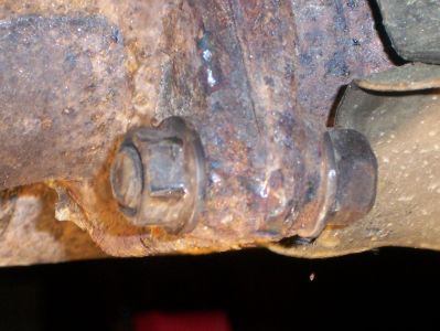

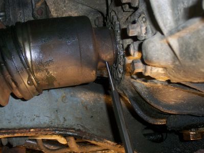

I have tried the punch and I I do not think there is any thing in there, is there another approach? Am I missing something? If the punch is just sliding through the hole and the next size is to big, or how hard would it be to knock this pin out? Here is a pic with the punch in it, also the muffler looks like the bolts are wielded on and I can not get them off, any suggestions?

MHPAUTOS
  • 31,937 POSTS
Hi there,
For the drive shaft just check that it is not a roll pin fitted, if so an exact size punch will be required, This is the only locking device in the shaft so if no pin fitted the shaft will move. The exhaust nut is welded and you will have to undo the bolt end.
