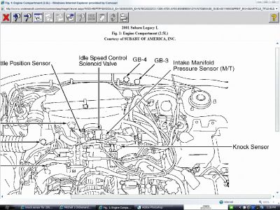

i have 2001 subaru legacy check engine light is on i took it the mechanic and told me that kcock sensor code. i tried to fix it by my self but i couldn't find the location of the knock sensor. thanks for ur help

2 different engines in these! 2.5 it's on the top rear of the engine On 3.0 there are 2 of em, they are on the right and left center of the engine.
https://images.2carpros.com/forum/automotive_pictures/62217_Knock_2.jpg
