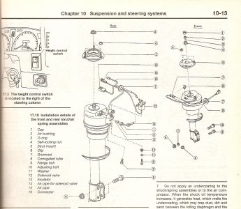

I have a 91 subaru legacy wagon 4 door hatchback, that has the push button height control option. The switch is stuck on, and the vehicle is stuck in the high position, IE very bumpy ride, almost undriveable. I took the vehicle to a repair shop to have the problem repaired they said that I had leaks in the air bags which control the height control, and it would be tons of money to replace the system. I dont care about the height control, and just want it removed or disengaged.
I have tried pulling the fuses and disconnecting the battery to restart the ECU, with no luck.
What can I do, I just want it out of the the high position an driveable again. Can I some how disengage and disconect the switch?

you can disconnect the power going to the air suspension, then loosen up the air control for each shock letting the air out leveling the vehicle,
https://images.2carpros.com/forum/automotive_pictures/54223_air_suspension_1.jpg
