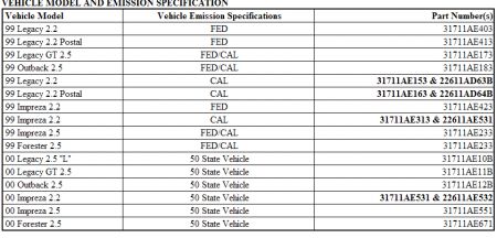

TECHNICAL SERVICE BULLETIN Reference Number(s): 16-65-99R,  Date of Issue:   April 03, 2000 Related Ref Number(s): DESCRIPTION In the event you encounter a customer complaint of the A/T temperature light flashing and this code is found in the TCM, perform the following: First, eliminate all wiring and connector concerns by performing the tests as outlined in the appropriate Service Manual for this code. Repair as necessary. After you have checked and confirmed these items, and you still did not find any problems, we recommend you replace the following part(s). Use the chart below to locate and order the correct part number(s) for your application .
https://images.2carpros.com/forum/automotive_pictures/62217_suba_1.jpg
That part # is 31711AE10B I'm not sure what it is but it mifgt be the TCM itself...Stop in at Subaru, they can tell you if it's been done on yours yet, Transmission control module?

The TCM has definitely not been done. Can I use one from a 2001 or 2002? Different part number. I'm having trouble locating a used one for 2000 on ebay and a new one is $400.

Check the part number on the chart, it's the only one for your car that will solve the problem.
