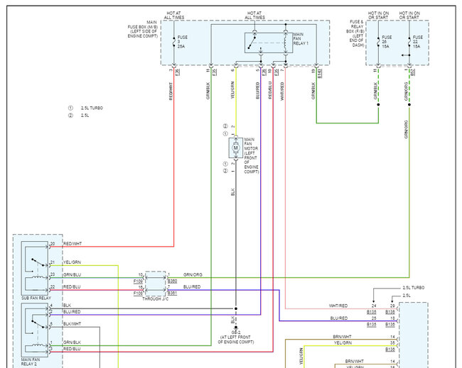

The engine fans won't kick on, even with the A/C on, even if the green connector is plugged in. The car doesn't overheat, per the dash, but just pulled the p0483 code yesterday. has a new radiator and coolant, thermostat, checked out good then, no other known issues except for the A/C clutch not kicking on either. The A/C was working this summer.

The diagnostic trouble code (DTC) P0483 in a 2006 Subaru Legacy relates to the cooling fan. This code indicates "Fan Rationality Check Malfunction,"

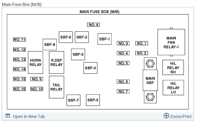

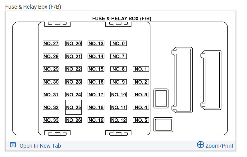

If neither fans are working it sounds like the main fan relay 1 is not working but we should check the fuses (3, under the hood and #26 and #22 inside fuse panel) as well, here is a guide to help you check the fuses and if they are okay, I would swap out the relay.

How are the fuses? do they have power?

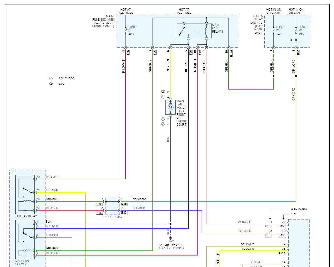

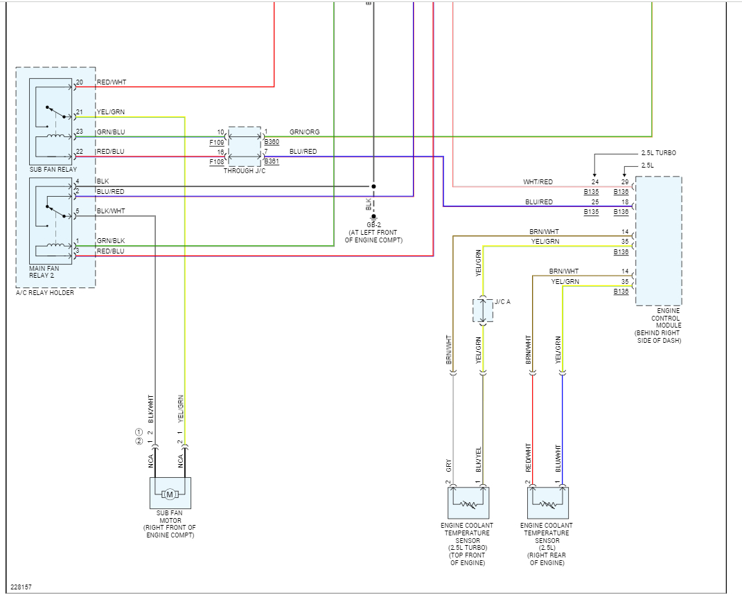

So, does the fan come on when the A/C is on? If not, I would test the yel/grn wire to the fan motor for power with the A/C on. Here is a guide to help:
Please go over this guide and get back to us.
