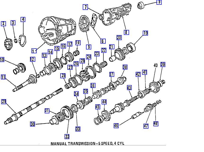

my truck's 720 five speed is stuck in reverse gear. clutch works, but will not come out of reverse. tried bumping the clutch but still in reverse. any ideas what it could be?

It sounds like something has broken inside the transmission.
Here is a guide that will give you an idea on how to pull it out. You will need to put the truck on jack stands before you begin.
and
https://www.2carpros.com/articles/transmission-replacement-removal-manual
Here is a diagram showing how the unit comes apart.
Please let us know what happens and upload pictures of the problem.
