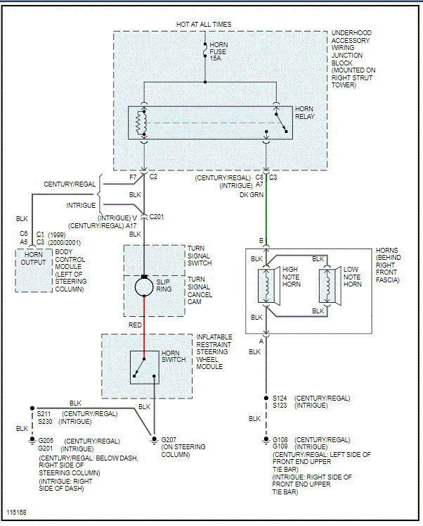

Last night ,for no reason, the horn went off. (The car hasn't been driven for 2 days).Checked the horn relay and it appears to be okay.
Any suggestions? Thanks for your help.

Does the horn stop if you remove the relay? I'm trying to determine if there is a short to power after the relay. Also, how was the relay inspected? Take a look at this link that explains how to test a relay:
If the relay tests good, then I suspect the actual switch (horn button) in the column is the cause. I attached a wiring schematic of the horn circuit. Take a look and you'll see there isn't much more to fail other than a shorted wire.
Let me know about the relay and if it stops when the relay is removed.

Yes, it stopped once I removed the relay.(that was the only way to shut it up).This is the way I tested it: pulled it out connected jumper wire to one control terminal (85) and batt +,the other control terminal (86) to batt -,it clicked ,then checked for continuity, at the power terminals (87 and 30) .It had continuity..

After you guys answered my original question, I went ahead and took a voltage reading at the fuse box and got live volt on the top 2 connectors, where the horn relay goes.
Is this normal?
