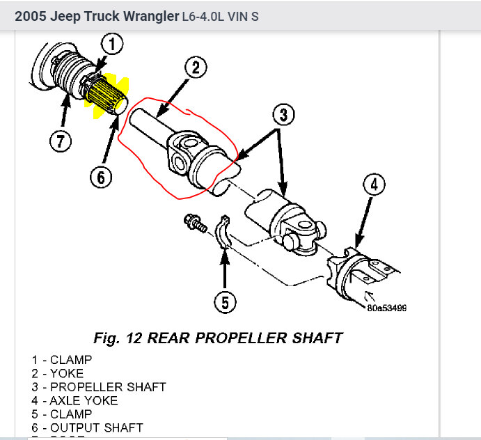

I put it on a lift today put in neutral with key on all tires turn running rear locks up. I took the driveshaft out on lift engine off everything turns including transmission yolk running wheels turn with driveshaft out transmission yolk locked up. Would torque converter do that or is transmission shot? All fluids were changed about 2 months ago.
Feb 9, 2023 at 10:41 AM
  • 110,240 POSTS
When you say transmission yoke, are you referring to where the driveshaft connects to the transfer case? See pic below. Is it the output shaft that locks or the yoke?
If it is the output shaft on the transfer case, chances are it has nothing to do with the transmission. Instead, it is likely related to the transfer case. Also, a torque converter wouldn't cause this to happen.
See pic below.

Yes, where the driveshaft connects to transfer case.
