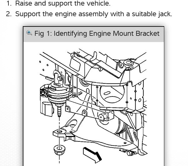

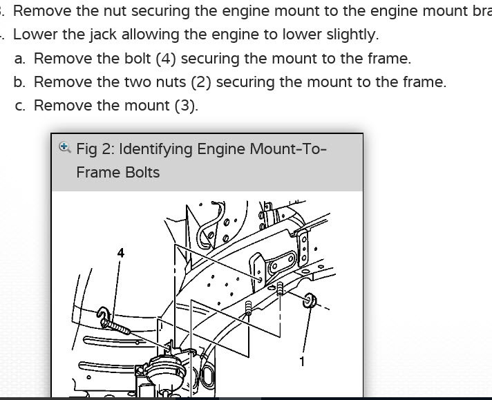

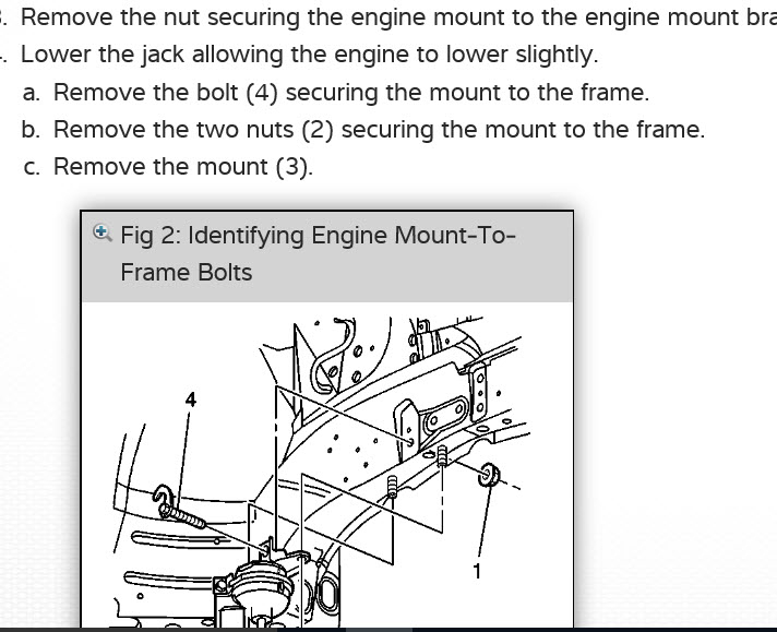

My engine keeps shaking while idling and during driving. How do I replace the rubber part for the motor mount?. I know I hv to loosen the dogbone bolts, but if I loosen them, should I hv something under the engine or will it be fine?
Feb 4, 2016 at 9:14 AM
HMAC300
  • 48,601 POSTS
scan for codes first it may have a misfire auto parts can do it for free but if it's amount pics are for a 3.8L 3.1 is similar
