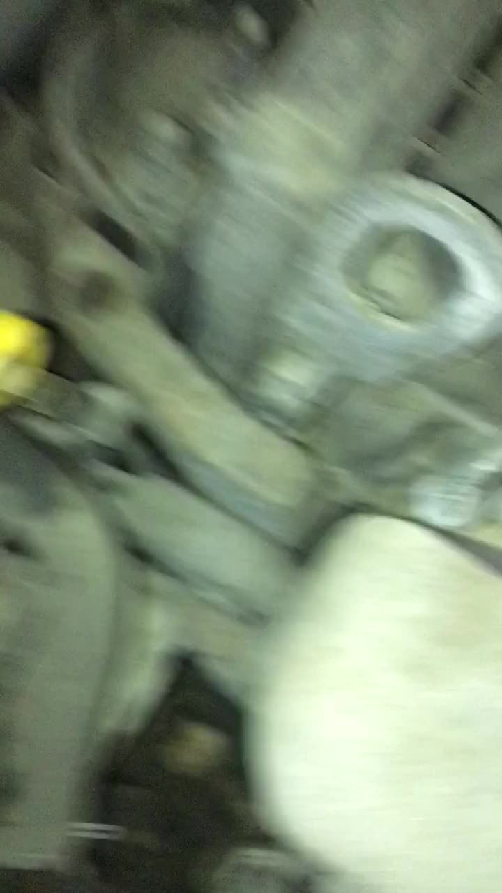

When i am standing and the car is hot (not overheating) she makes strange sounds. i have added a video of this sound. (By a mistake i have wrote 90,000 miles but it is not 90,000 miles it is 90,000 kilometers)

For some reason, the audio recording wasn't uploaded. Can you do that? Also, make sure the belts are dry, clean, and tight. If they are, remove the belt and see if the sound is still present. Keep in mind, the engine will overheat with the belt off, so only run it for a couple seconds, just long enough to see if the sound is gone.

I definitely hear it. The first thing I would do is confirm the belt is tight and it doesn't just need adjusted. If it is tight, remove the belt and start the engine for a couple seconds to confirm the sound is gone. If it is, inspect each of the belt driven accessories. Most likely, a bearing is going bad in one of them.
Here are the manufacturer's directions for testing belt tension. However, you can check it without the belt tension gauge. Pull on the belt. If you are able to easily move the belt up and down and the tensioner is moving easily, that is most likely the problem.

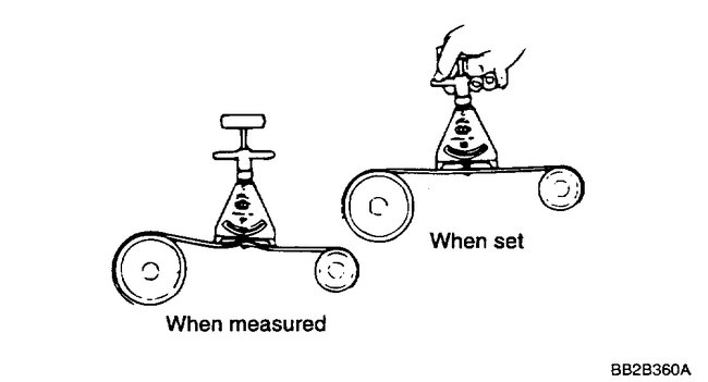

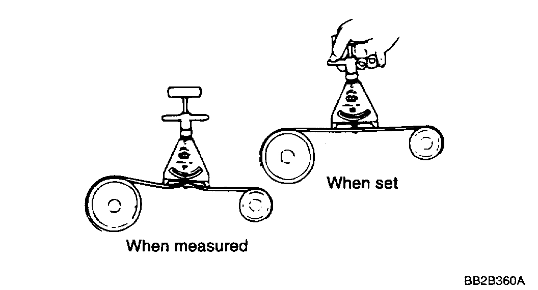

1. Check drive belt and pulley for wear, cracks, and fraying. Replace if necessary.
picture 1
picture 2

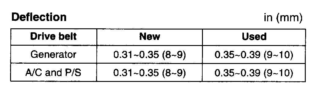

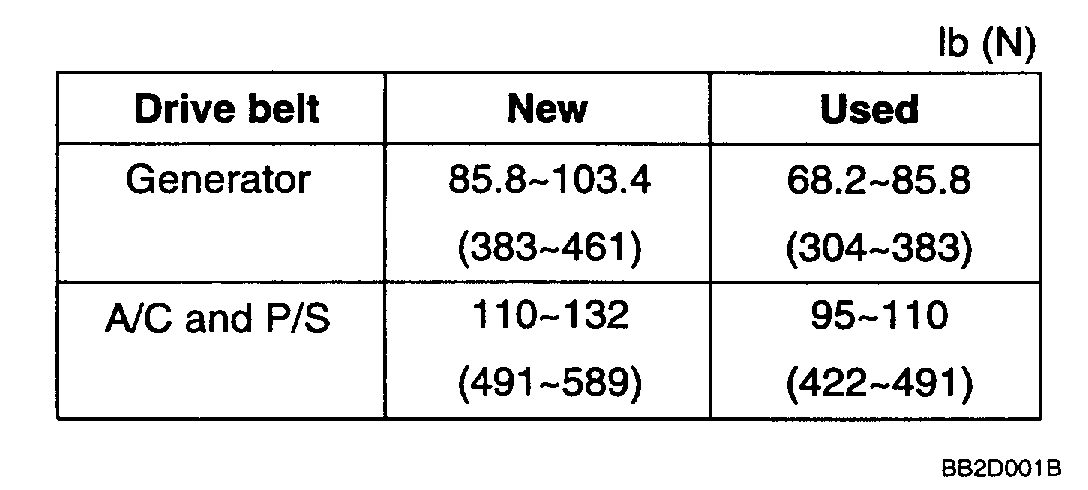

2. Measure drive belt tension with a tension gauge.
Deflection
picture 3
3. Measure deflection by applying moderate pressure (22 lb [98 N]) midway between pulleys. Adjust if necessary.

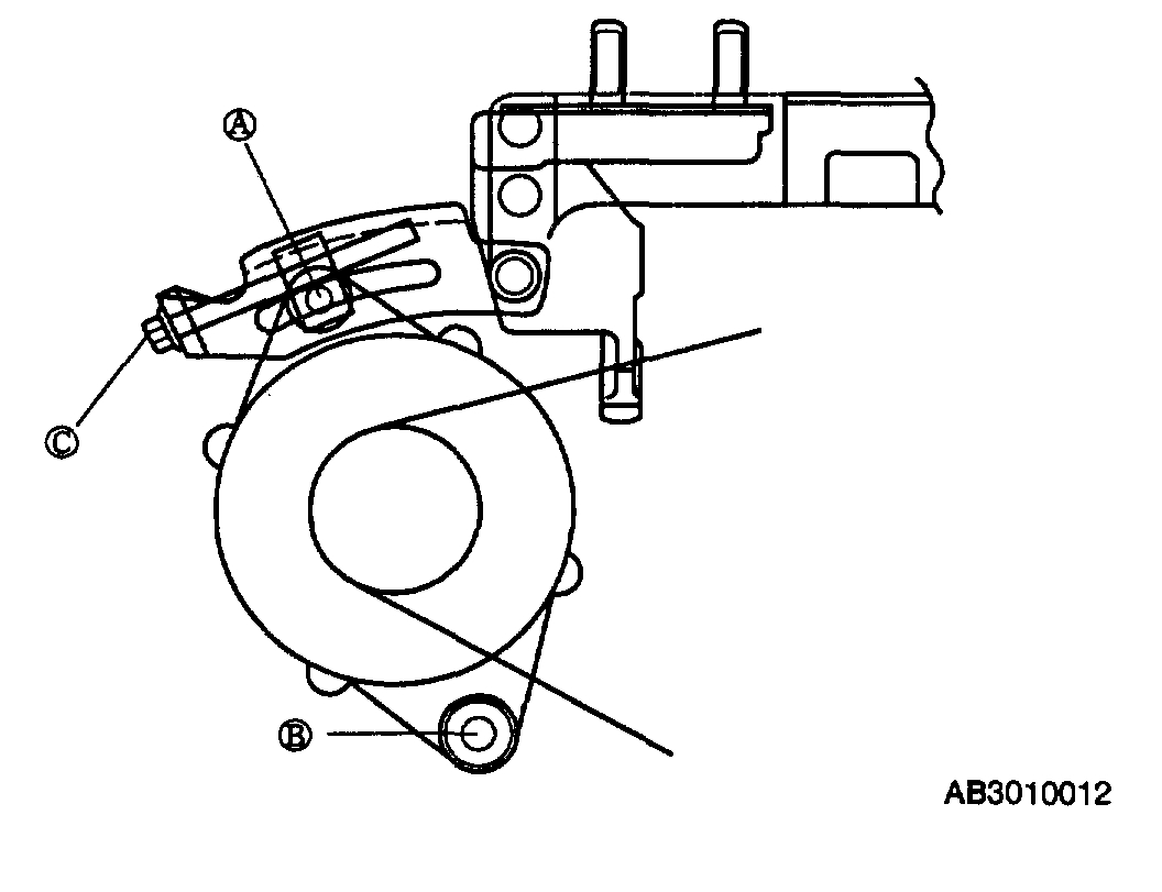

If you find that the tensioner needs adjusted to tighten the belt, here are the directions. The 4th picture shows bolt orientation as well as which one adjusts the belt.
Loosen pivot bolt B and tensioner mounting bolt A. Do not remove.
Relieve or add tension on drive belt by rotating adjustment bolt C.
You may just have to tighten the belt to eliminate the noise or the belt may just may be old and dried out allowing slippage and the noise. If you want to make it really easy to determine, do this.
Start the engine and open the hood. Pour a small amount of water on the drive belt while the engine is running. If the tone changes, for sure it is the belt or one of the accessories.

Okay, now the results the belts looks fin.e i mean they are tight and i can't really move them easily up or down .
Most of the time i hear this sounds when the car is reg working temperatures and the car is on parking or while i am driving until 40 km after 40 km the sounds disappear. if i am on parking and the sounds are there i can turn on the A/C and then the sounds disappear (i will change the belt in a few days and will tell you what is going on with it).

Do me a favor. Trying pouring a bit of water on it when it is making noise to see if it changes pitch or goes away. Just take a cup of water and slowly pour it on the belt. Just protect your eyes and clothing because it will most likely fling the water.
