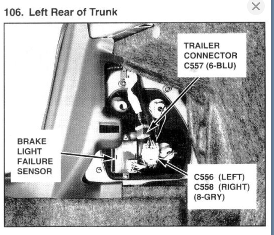

I need to replace stop lamp failure sensor on my car listed above (four door sedan). Where is it located? This car what you are referring to is separate from the brake light failure light directly below the little car figure which also shows doors ajar. Nothing to do with brake switch. I need to know where the Brake light sensor is located. The lights all work. The bulbs are all good same brightness. The sensor which has a printed circuit has gone bad. I have a replacement. I just need to know where it is located. Thanks

The sensor is located behind the left tail light. I cannot find any pictures of it.

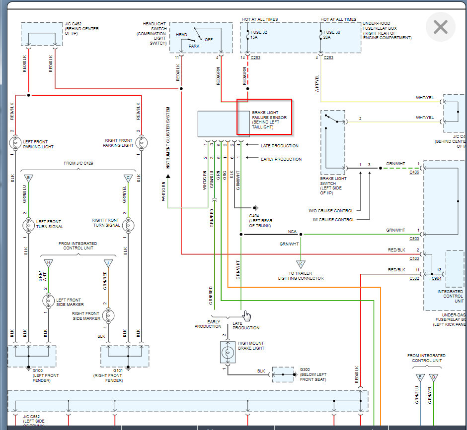

The wiring diagram states it is on the left side.

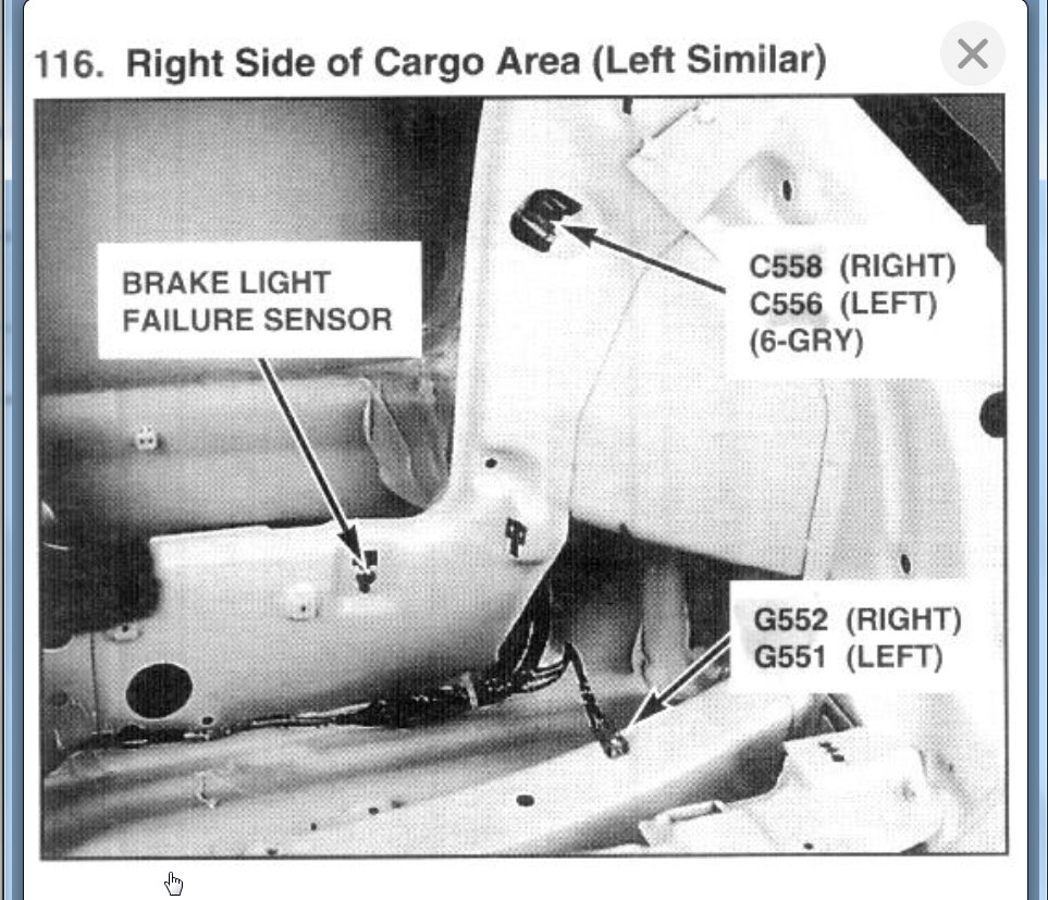

Please see the information below from the wiring diagram and photos of the sensor.
The confusion comes in I think, because the harness routes to the right side of the trunk but the sensor is on the left side behind the taillight.
Please review this material and let us know if you have other questions. Thanks
