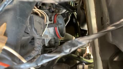

Okay, here’s the video. We sprayed starting fluid directly into the intake and it just turns over still. Exactly like in the video.

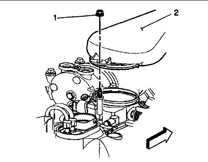

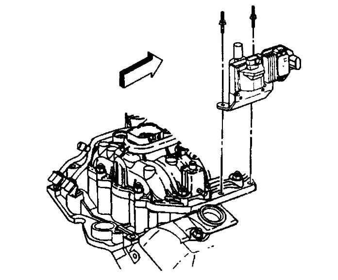

  • 52,797 POSTS
This sounds like the ignition coil is not putting out too much spark.
How old is the coil?
I attached pictures of the replacement.
Sunday, June 28th, 2020 AT 3:57 PM

  • 52,797 POSTS
That would be a good start. I would replace it and see if it is a brighter spark.
