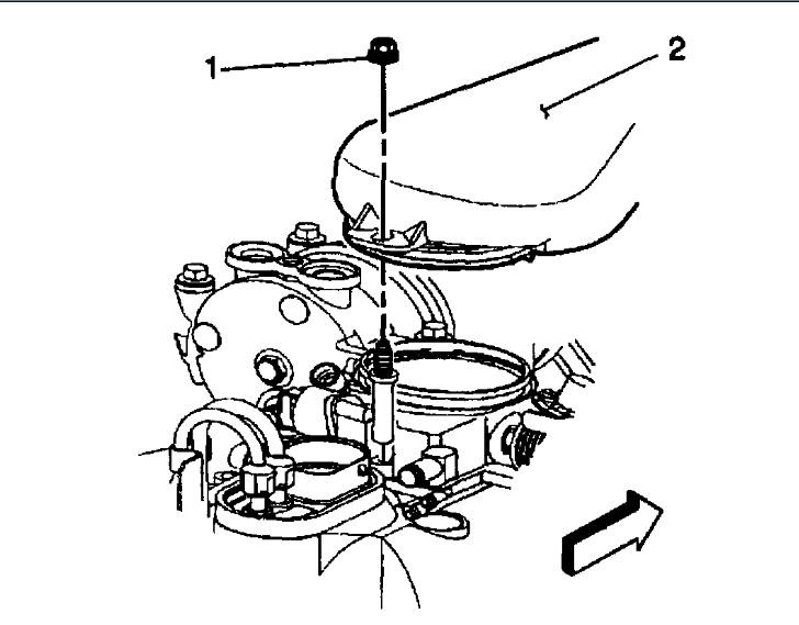

You said timing because the starting fluid doesn’t work. Could it possibly be the spider injector? I was told that the poppers are known for sticking, but that wouldn’t explain why the starting fluid has no effect.

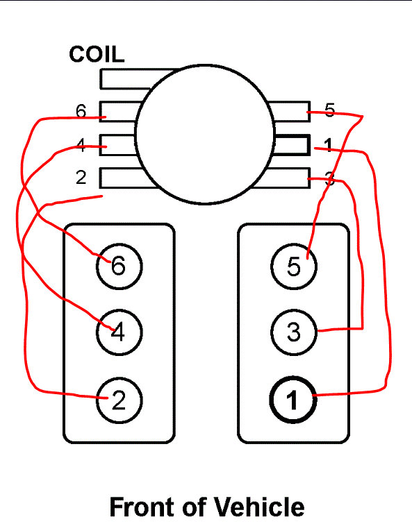

Okay, that is where one of the plug wires goes, so you got spark. By any chance could the plug wires been reinstalled incorrectly for firing order purposes?
I attached a pic of where the spark plug wire order per cylinder. Please confirm.
Jun 14, 2020 at 1:22 PM
DAVIDKAZEE
  • 21 POSTS
The wires are in the correct places. When I replaced the distributor cap I removed and replaced one wire at a time so I wouldn’t get them confused.

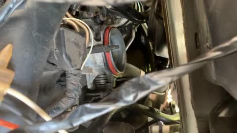

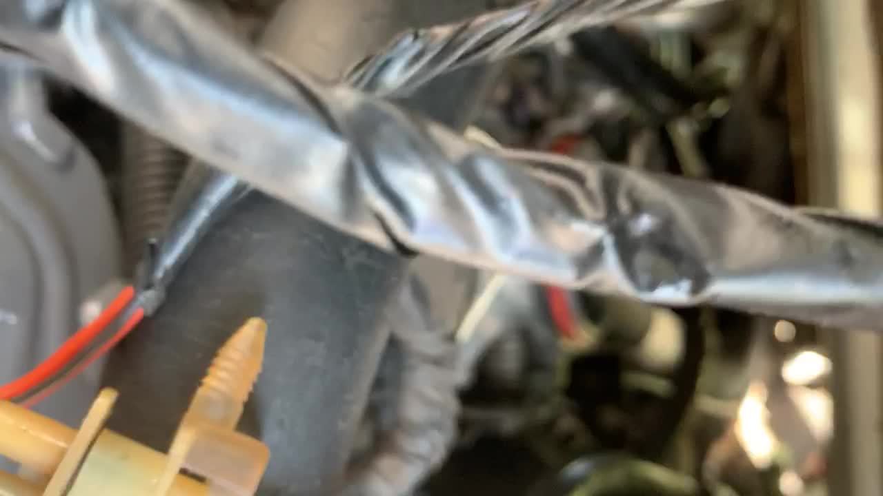

Okay, here’s the video. We sprayed starting fluid directly into the intake and it just turns over still. Exactly like in the video.

Okay, this all started with the fuel pump. You had next to know pressure.
Did you double check you installation to be sure nothing, in particular, wiring, got pinched with the installation?
This sounds like a fuel delivery issue. Are there any codes set in the ECM?

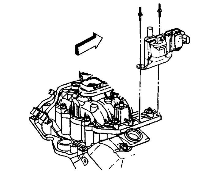

Okay sorry I broke my phone, but I have no spark at the spark plug. And every 5 seconds of the engine turning over it sparks the tiniest little spark on plug wire #6. And it’s not a blue spark, it’s more like orange or yellow. But the spark is significantly smaller than say the one on my lawnmower and the spark on my lawnmower is blue. Any ideas?
Jun 28, 2020 at 3:28 AM
This sounds like the ignition coil is not putting out too much spark.
How old is the coil?
I attached pictures of the replacement.
Jun 28, 2020 at 8:57 AM
DAVIDKAZEE
  • 21 POSTS
The coil is original so about 20 years.
Jun 29, 2020 at 4:52 AM
That would be a good start. I would replace it and see if it is a brighter spark.
