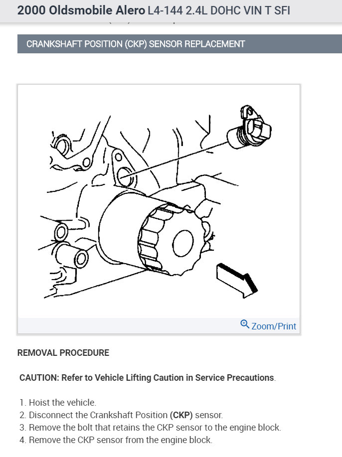

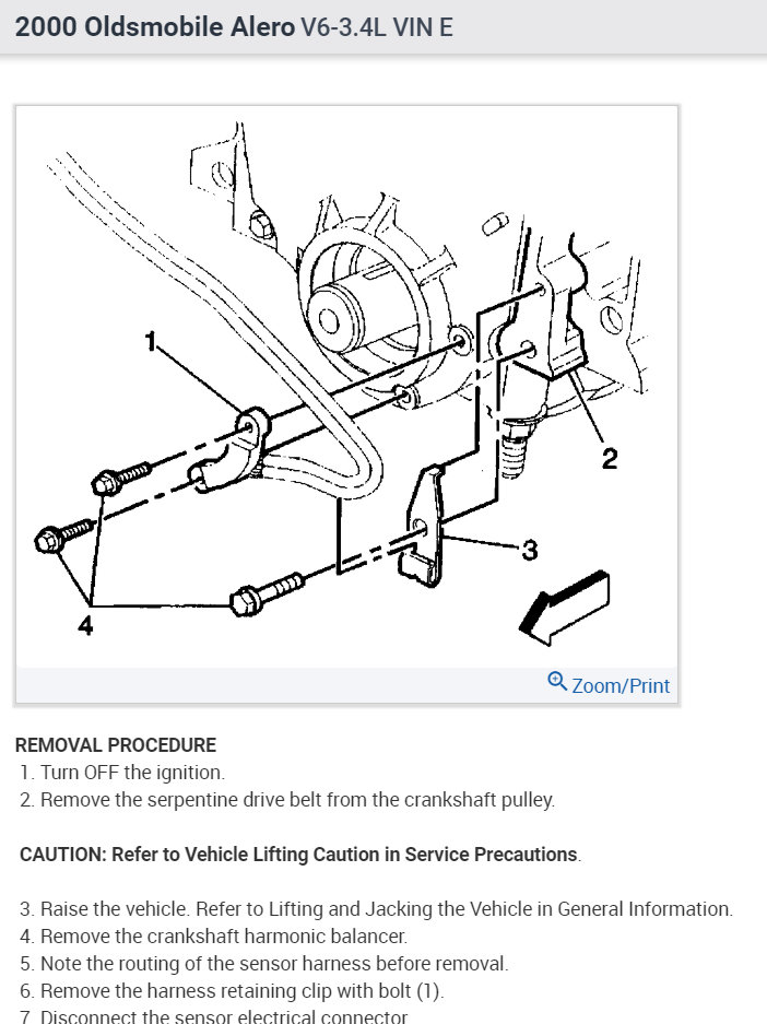

They have checked the fuel pressure and it was okay. They replaced the spark plugs and wires (again). They also replaced the EGR (ERG?) valve. It drove eight miles then it shut off with no warning again. What else do you guys suggest?
Jan 3, 2017 at 3:47 AM
HMAC300
  • 48,601 POSTS

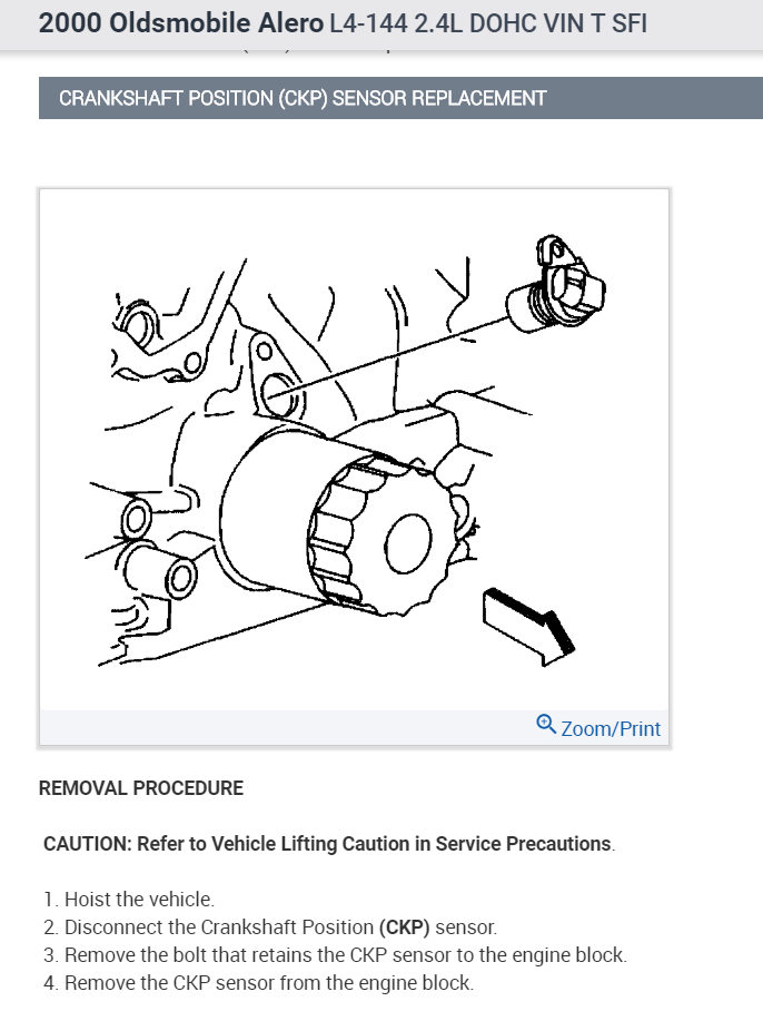

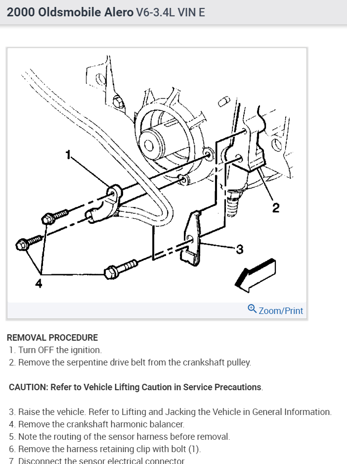

It sounds like the crankshaft angle sensor has given out which will not give you a trouble code most of the time here is a guide to help you see what you are in for when doing the job and the location of the sensor below.
this guide can help as well
https://www.2carpros.com/articles/engine-stalls
Here is the sensor locations for both engine just in case.
Check out the diagrams (Below). Please let us know what you find. We are interested to see what it is.
Cheers
Jan 3, 2017 at 4:06 AM
JOHNNY G.JR
  • 320 POSTS
Thank you so much I got the sensor $46.00 and the car has never run better. I love this site.
Jan 3, 2017 at 5:45 AM
