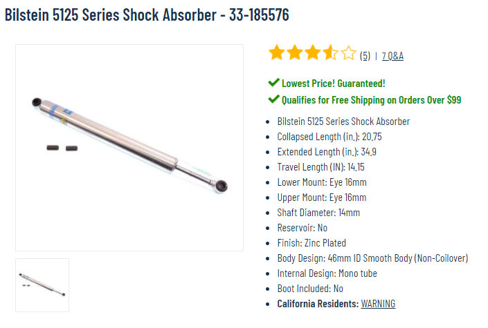

Sorry to hear this. What type-brand of struts and shocks were installed? MotorCraft (Ford) original? I personally when it comes to the trucks I own use the brand Bilstein shocks. They are excellent for towing, hauling, and 4x4 use. They are a little more in price but well worth it. I've experimented on my 1997 Chevrolet K1500 with many different shocks and the Bilstein 5100 series are by far the best. I've attached a picture below of what they look like from 4WheelParts.com. Hope this helps and let us know if you have any further questions on this issue. Thanks for using 2CarPros.
