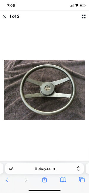

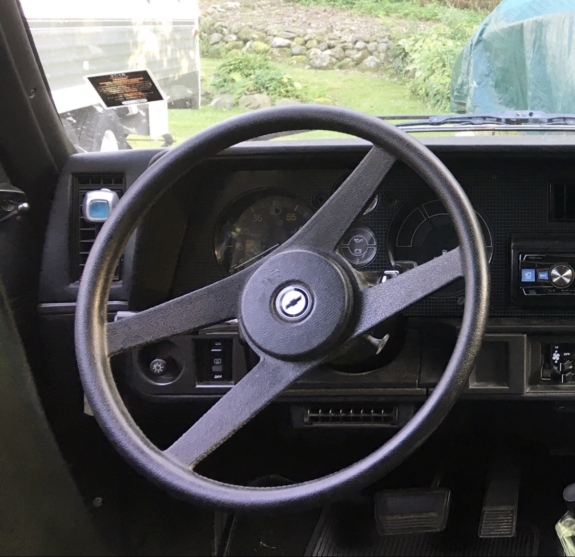

Hi, I need a new steering wheel for my car. I need the 4 spoke model wheel. I found one that looks identical on the 1971-1980 Chevy Camaro. I was curious if it would fit.

The steering wheels are different parts number for the Camaro and the Cavalier.

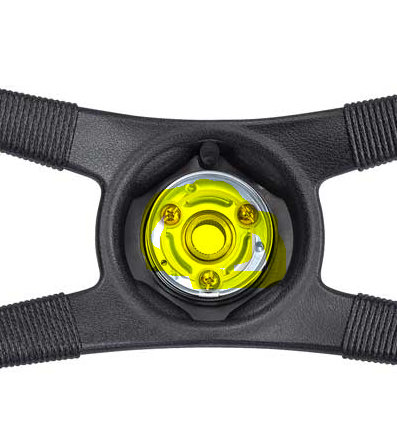

However, the only way to make sure it will fit is to check the shaft diameter of steering column. The part that goes into the steering wheel.
This will require you to remove the steering wheel and measure. Also, you will need to count the 'teeth' on the spline. It has to be the same number as the Camaro steering wheel.
Unfortunately, this information is not available in the catalog.
I have attached a picture for your reference.
