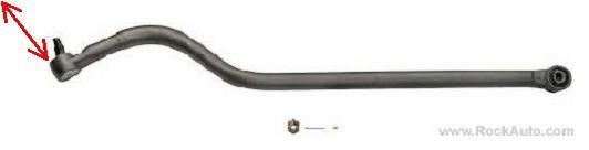

WANE EVANS
do you have pictures of the track bar
Dec 29, 2015 at 9:14 AM

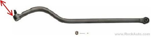

CARADIODOC
  • 34,414 POSTS
This is from the Rock Auto web site. The photo is backward from what you'd see on the truck. The loop, ball and socket, and my nifty red arrow are on the driver's side. The stud is bolted to a small bracket on the left frame rail close to the steering gear box.
Remember, this is only used on the 4wd trucks. 2wd versions use upper and lower control arms and have no need for this bar.
The arrow shows where to look for the movement. As the steering wheel is turned back and forth, that puts real hard pressure on the steering linkage, which pushes sideways on the axle. The axle movement is allowed by the play between the ball and socket. The movement you're looking for is up and down in the direction of the arrow. Seeing this can be a little tricky because the wheel that turns out also moves down. Since the ground is in the way, the truck body moves up instead. That can result in the bar rotating a very tiny amount, but that can be enough to make it falsely appear to have play.
To add to the misery, you can't just grab the bar and tug on it by hand to make the movement visible. Arm pressure is not nearly high enough to cause the movement to occur.
Of the many of these I've replaced, I used the dial indicator to measure the amount of movement for warranty purposes. The worst ones I usually found had up to .030" movement, far less than what was "allowed", but way more than enough to cause complaints. That's around 1/32", so you can see that you're looking for something small enough to be considered okay on other suspension parts.
