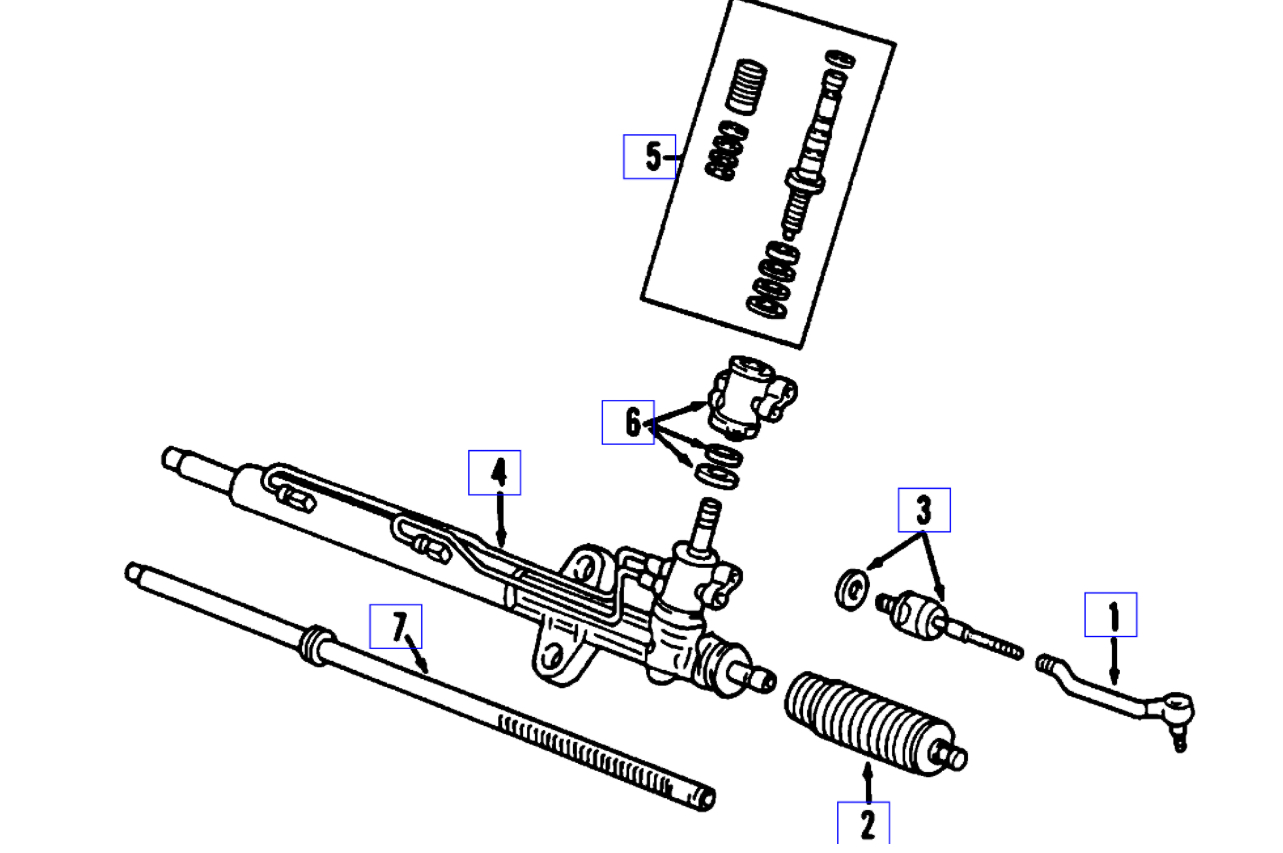

Hi, I have a situation where after driving a few kilometers I get an intermittent knocking sound. This is not apparent when I first start the car up and the engine is cold. But when I return from an excursion and the car is stopped in the driveway and I turn the steering wheel to left or right I get a noise. The steering wheel is not loose in anyway, but I am concerned that the overall level of knocking sound is increasing. As the car is 12 years old with low mileage and in good condition, I would prefer to keep it but not if the repairs are going to cost a great deal. Are you able to pinpoint what the problem may be, availability of parts and if it is worthwhile repairing? I appreciate any assistance you can give.

When it makes the noise if you are stopped and you turn the wheel, does it make the noise without the car moving?
There are bushings for the steering rack assembly that do wear out. The tie rod ends are another common wear item, but we need to narrow down the area of the noise.
Can you upload a video of the noise for me to hear?

Okay, I would check for any play in the front wheels with the car jacked up.
Start there and feel for any play.
