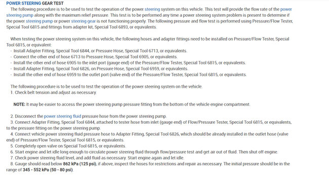

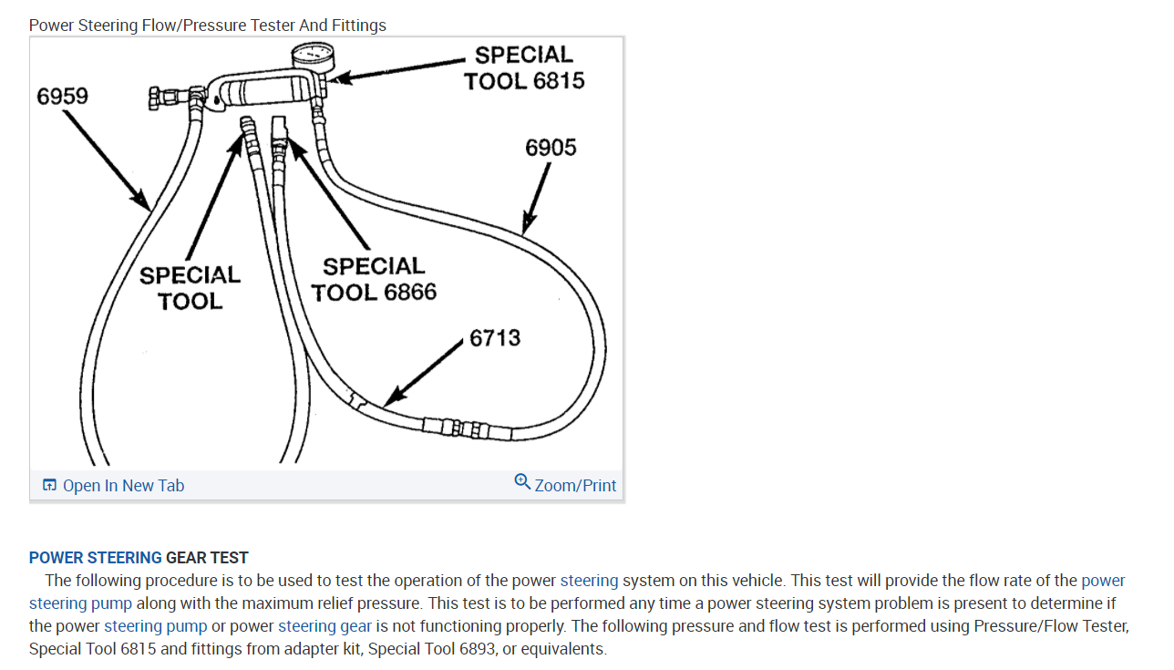

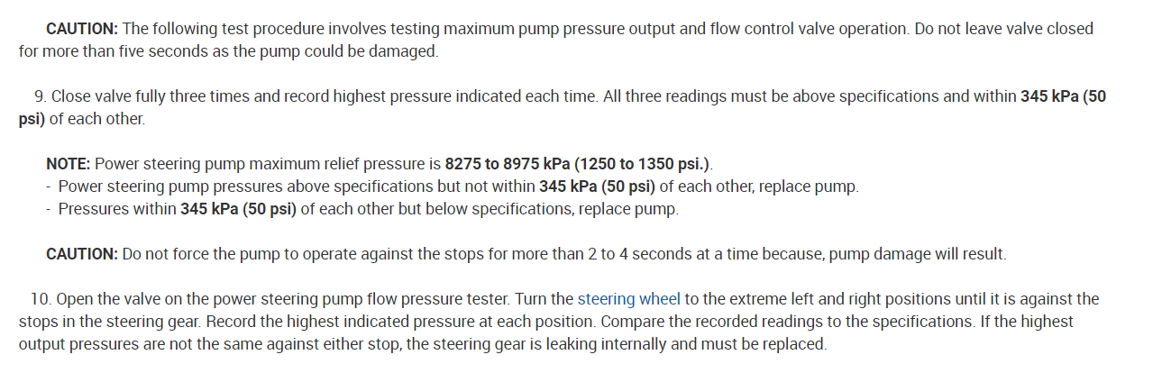

My power steering went out again, after new power steering pump and rack.
I had added regular power steering fluid instead of ATF+4.
Which some forums and my local NAPA guy, tell me is bad and I trashed the system.
I have new power steering pump and rack and lines and hoses and reservoir.
First I want to test system with pressure tester.
+1
Thursday, April 15th, 2021 AT 12:51 PM
  • 52,797 POSTS
Good afternoon,
I agree with the guy from NAPA. It sounds like the seals got damaged from the incorrect fluid.
https://www.2carpros.com/articles/power-steering-problems
https://www.2carpros.com/articles/power-steering-fluid-flush
I attached the procedure for testing below for you.
+3
