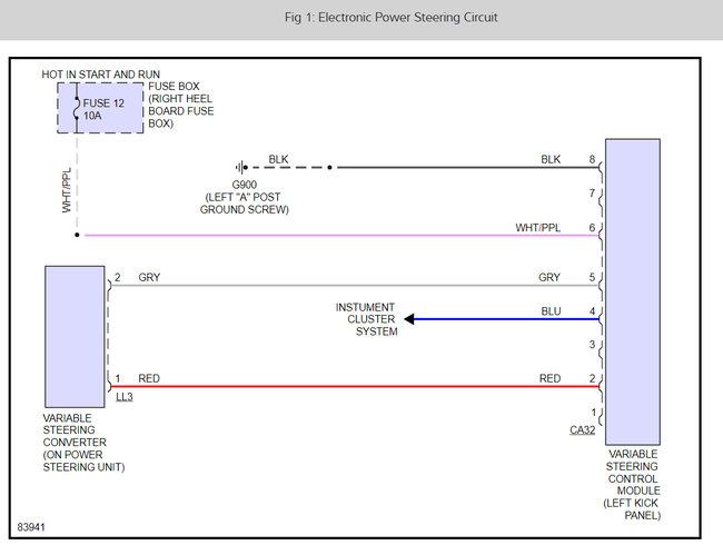

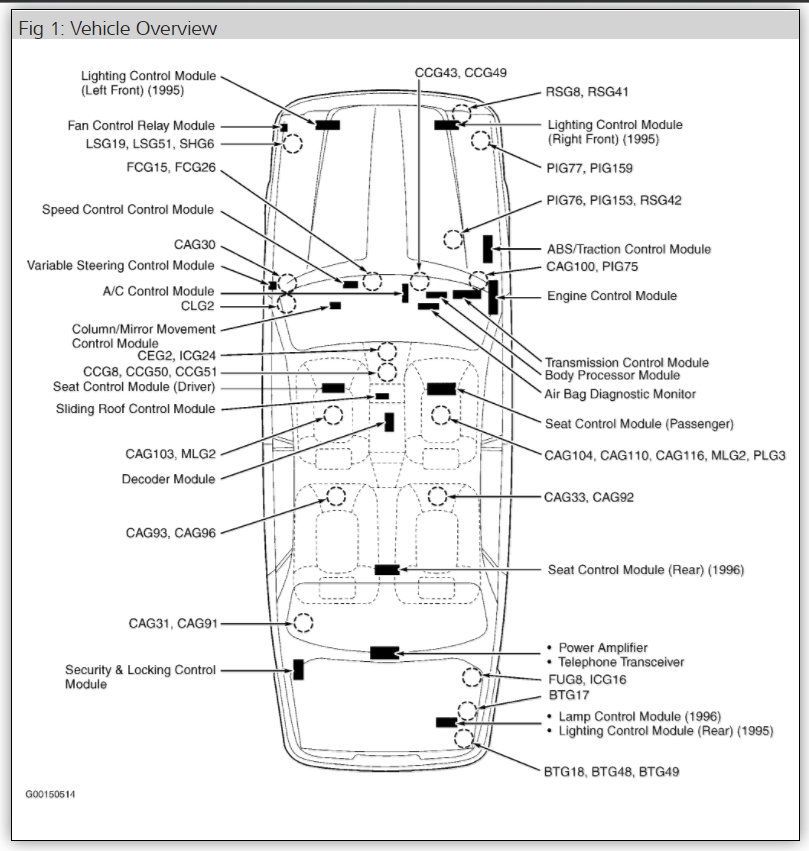

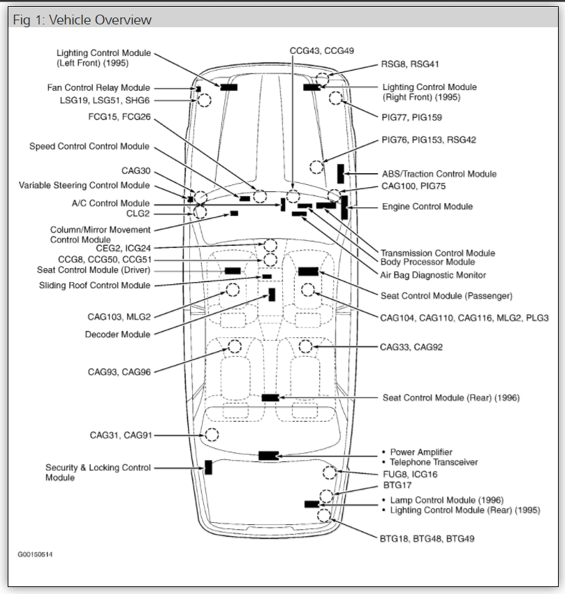

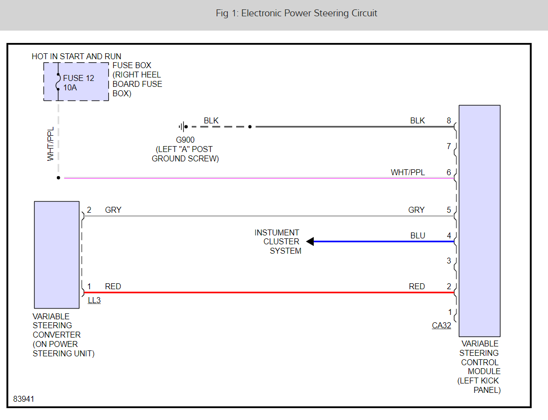

If the pump is not the problem I have seen where the steering control module would intermittently fail. Here is the steering control module wiring and location
Feb 17, 2018 at 5:46 AM
TY
Thanks for this info the module was bad on my car and this guide helped me find it :)
