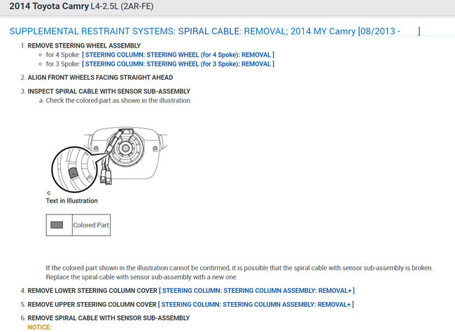

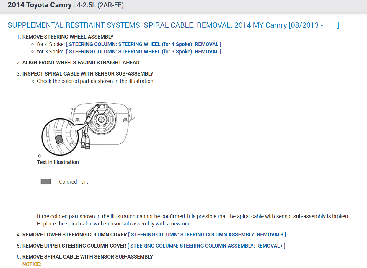

This is common when the clock spring behind the steering wheel goes out. To be sure lets do a CAN scan which is the future of automotive repair. you can get a CAN scanner from Amazon for about $50.00. here is a video to show you how:

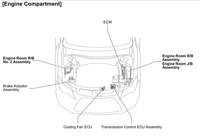

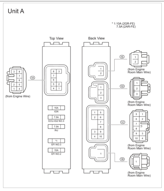

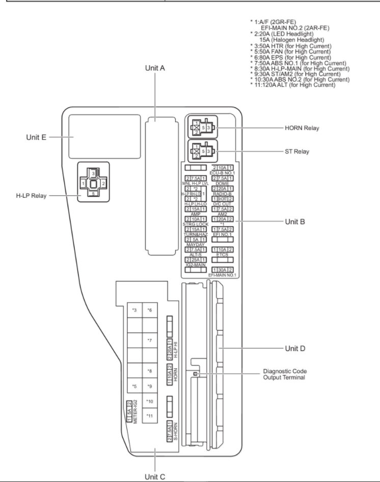

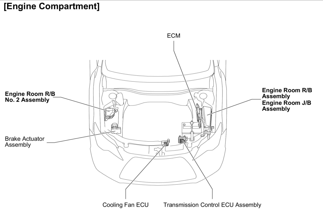

Also we should check the fuses. here is a guide to help with the fuse locations in the diagrams below:

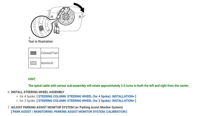

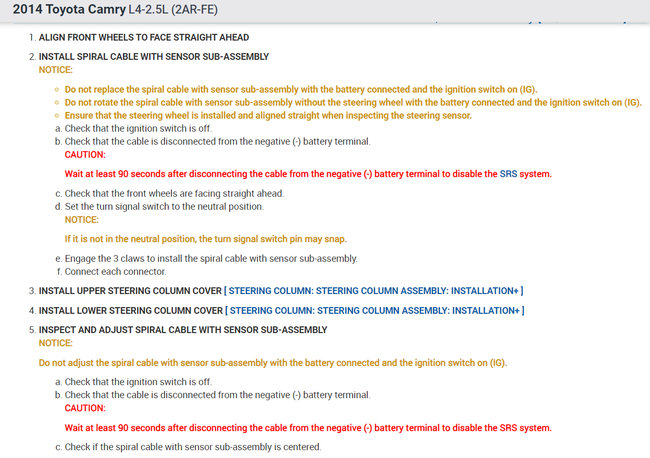

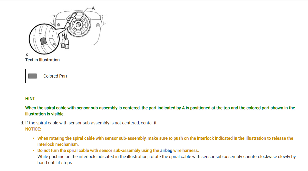

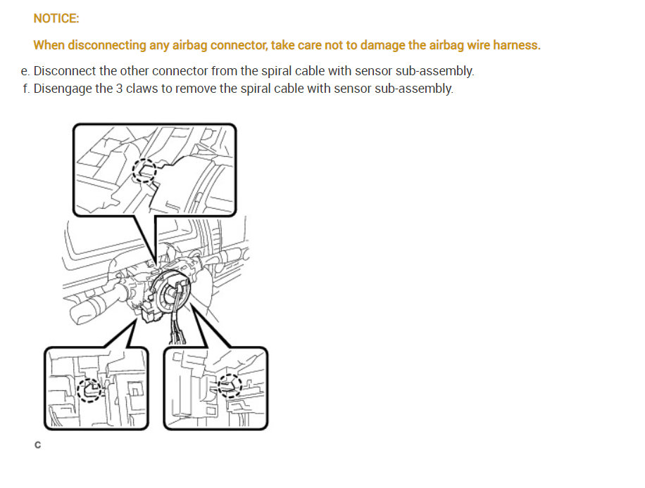

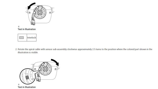

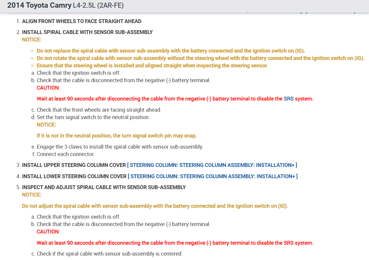

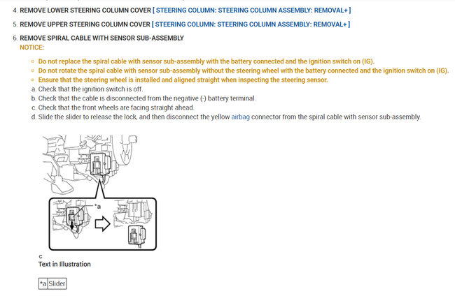

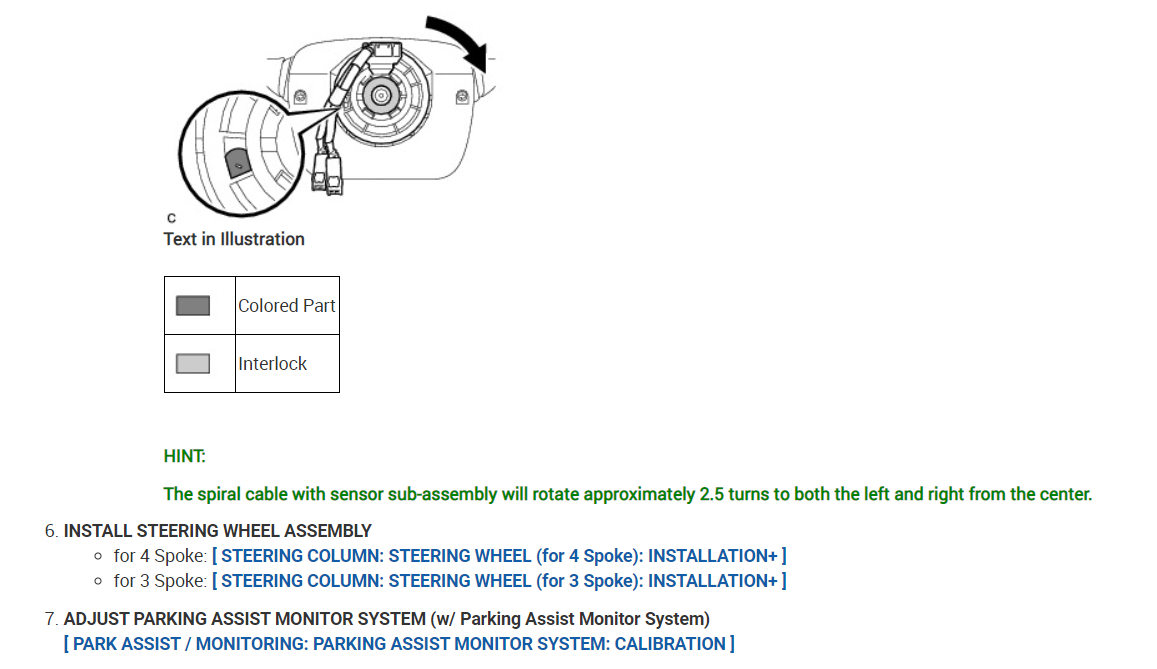

Here is how you change the clock spring out as well. Check out the diagrams (below). Please let us know what you find.
