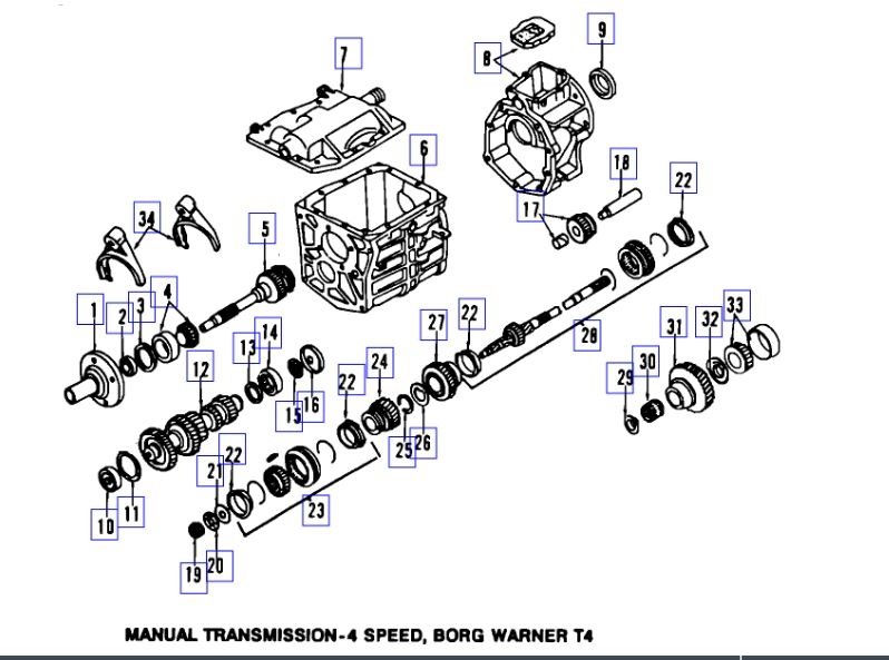

Hello. I have a question on gear grind with the transmission of my vehicle.
Shifting is good but there is a mild grind when I shift to fourth after driving for a few minutes. If I shift very slowly, or wait a second between 3rd and 4th, then there is no grind. Could this be a synchro issue? It only starts happening after driving for some time. Could it be the oil as it thins when it warms up?

As far as the grinding, it sounds like a synchro for 3-4 is the issue. The brass ring wears out and grinds when changing.
https://www.2carpros.com/articles/how-a-standard-transmission-works
I would change the oil and inspect for any meal debris in the oil. It will look like shiny brass in the oil.

If there is any metal debris, I guess the only way to fix it is to rebuild the transmission. Am I right in understanding that?
Also, can you guide me on why the grinding starts only after driving for some time? It’s fine for a few miles before it starts.
Jul 18, 2020 at 1:43 AM
The oil is thicker and slows down the gears to match RPM. They turn much easier with thin oil.
Yes, that would be a rebuild.

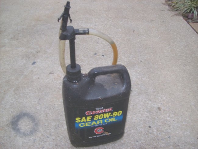

My transmission guy says you can run 80W-90 GL-5 in a T-4 or T-5,
Which is what I run in my 1977 CJ-5 T-150 transmission, Dana 20 transfer case, and both of my differentials (Nowadays, it is used instead of 90 wt, which is what I used back in the 1980's and 1990s).
I can comprehend doing this! It's a gearbox! I see no special materials in there that mine does not have.
Worst case? A rebuild? Sort of maybe headed that way, in time, anyway?

I do not think the oil will make a difference. I think you still have a syncro issue.
