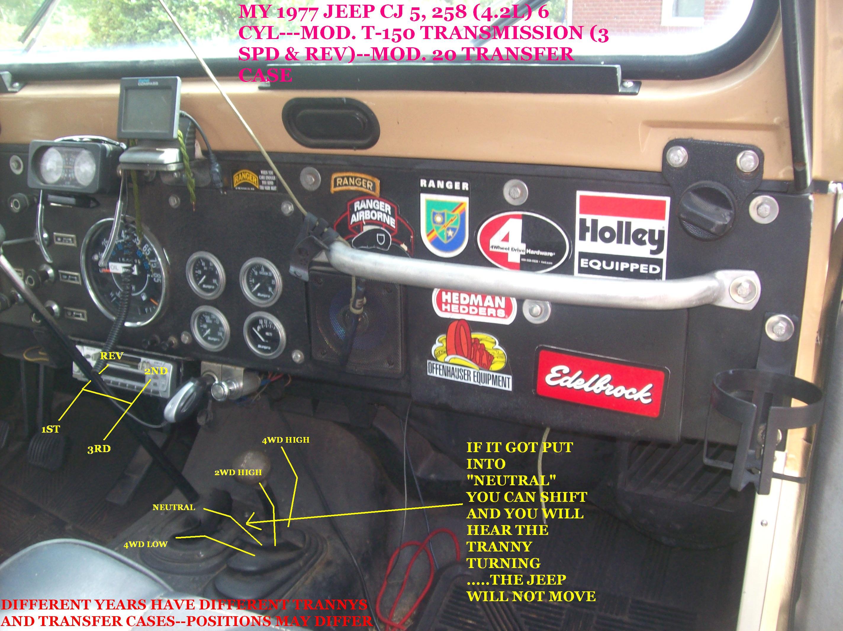

YOU MAY HAVE TO YANK HARD TO MOVE THE TRANSFER CASE LEVER
GIMME THE 1ST 8 DIGITS OF YOUR VIN....I MAY BE ABLE TO TELL YOU YOUR NOMENCLATURE
HECK.....SEND US A PIC!
KEEP IN MIND THIS IS "MY" '77 CJ5 LEVERS IN THE PIC
DEPENDING ON WHAT YOU HAVE---I HAVE PICS ON THE TRANNY'S INNARDS, FROM WHEN I REBUILT MINE

Apologies for my delayed responses. Having read your replies there's like a bunch of light bulbs that goes blink..blink..blink & when I saw your photo particularly of the 'neutral gear'...I felt like a dumb bimbo (or himbo) & began to wonder if I ain't masculine enough for a Jeep...(of what I see as a real man's auto). I'm definitely gonna follow your advice (to the letter) & will get back to ya on any progress. Hopefully I could address you as St. CJ Medevac in my next reply (your sainthood for being my savior).

Have to say looking at your photo, my Jeep's dashboard design especially with the large speedometer in the centre & 4 smaller gauges by the side + lighter/ashtray below looks identical to yours. Even the gear shift stick too.
