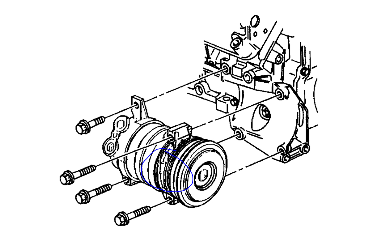

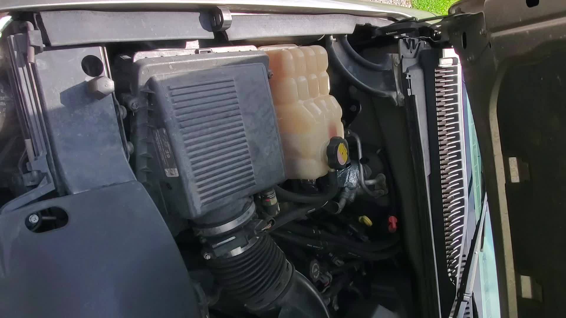

So the A/C is cold like it should be but after a few minutes at idle, the cold air leaves and it's just warm air. Under the hood, I can a constant rattle, and it rarely goes away. Is the A/C clutch staying on? I've tried to Freon it up but if the rattle is actually the compressor stating on then it doesn't go away, as if it's low of Freon. So now I'm thinking it's something with the A/C compressor but a lot of people are saying it's the radiator fan clutch. Thoughts?

Does the clutch stay engaged when it blows warm air?
I would get a set of gauges and check the high and low side pressures to see if it is overcharged. If it is, it will knock.
Can you upload a video of the noise? It very well may be the compressor. Disconnect the wire to the compressor and see if the noise goes away.

I wouldn't describe the noise as a knock. It's hard to explain but it's not loud. The compressor stays on a long time and I can't get an accurate reading because of it.

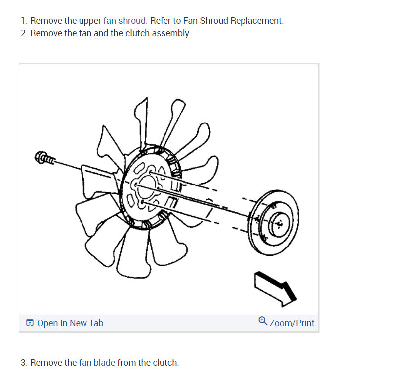

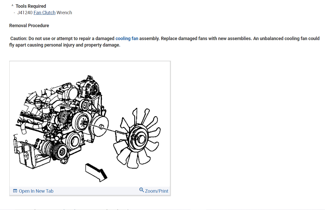

The fan clutch pulls cool air through the condenser for cooling down the condenser. If it is bad, it would reflect it in the pressures. The high side would be very high from lack of airflow.
https://www.2carpros.com/articles/fan-clutch-symptoms
https://www.2carpros.com/articles/fan-clutch-removal

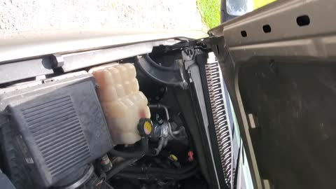

Okay, I will get some gauges from Harbor Freight. Until then, here's a video of the sound.
May 31, 2021 at 7:28 AM

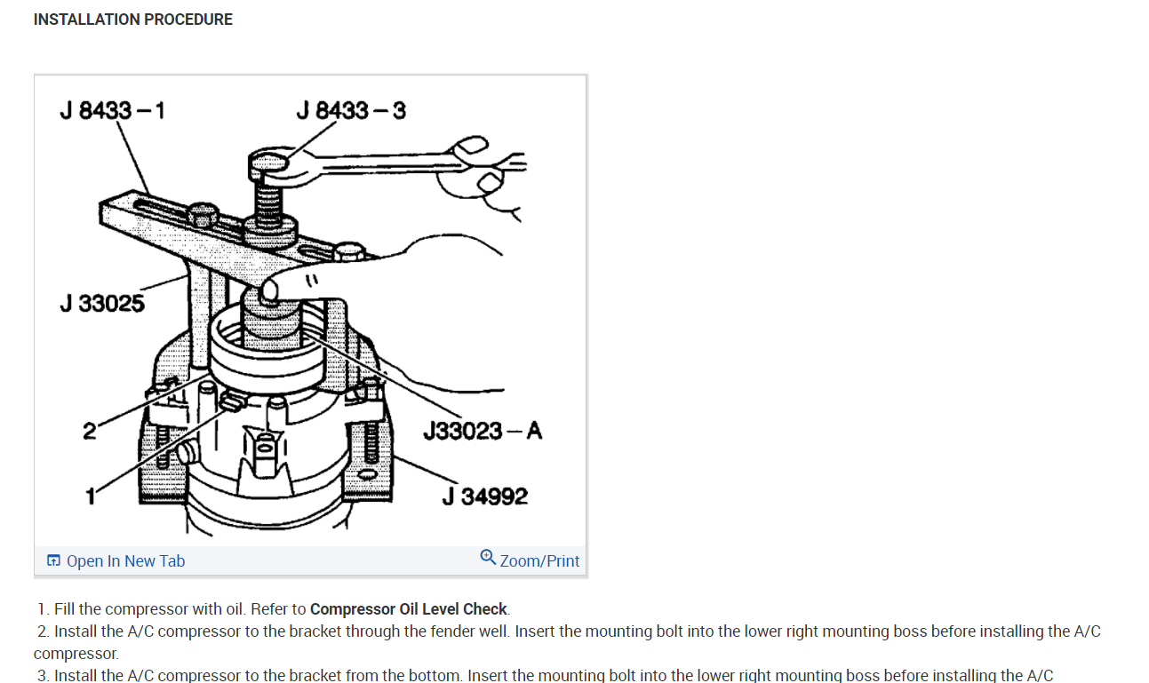

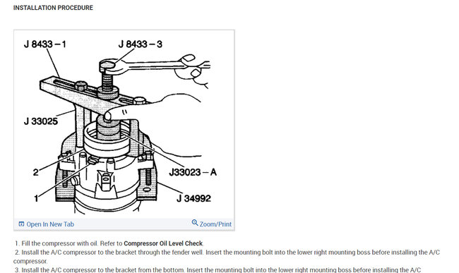

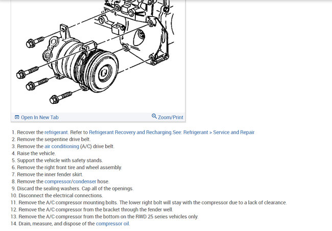

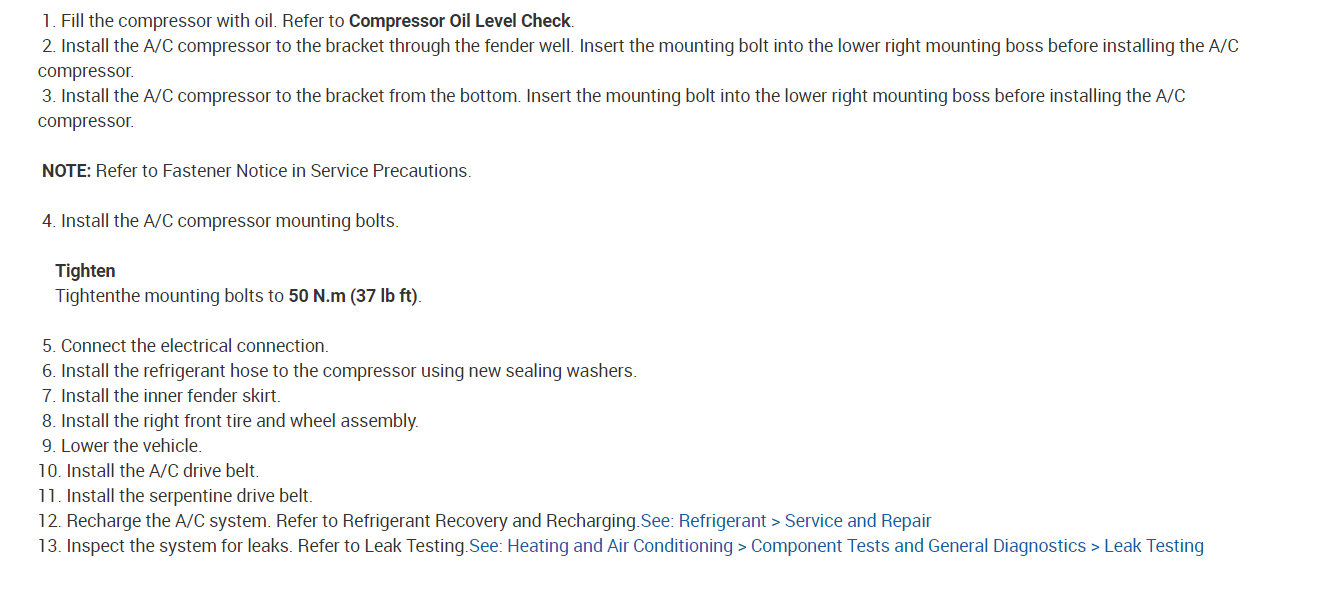

You need a compressor. I would replace it and evacuate and charge the system.
https://www.2carpros.com/articles/replace-air-conditioner-compressor
