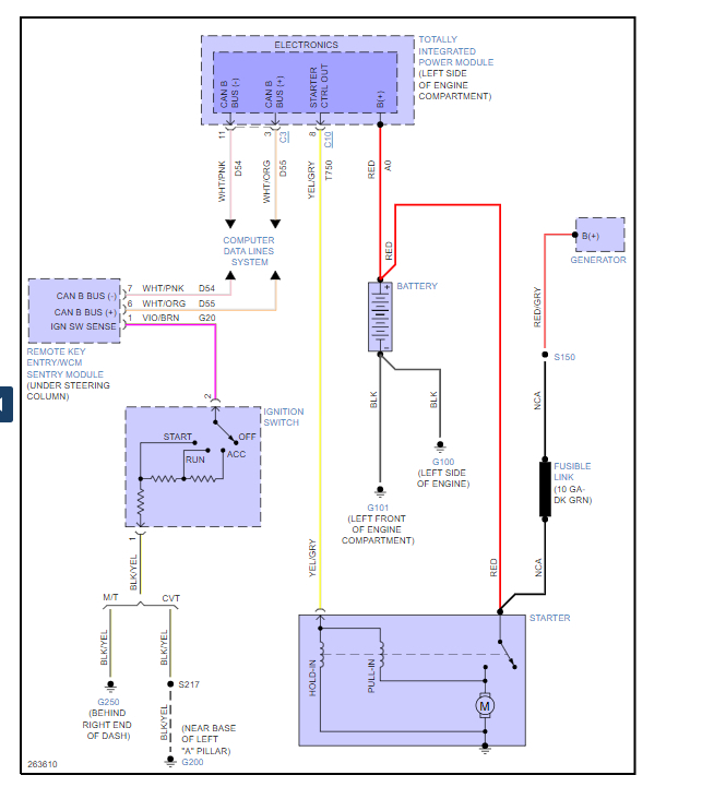

Hello here again, when I am driving, sometime the starter engages itself and to stop that, i have to pull over open the hood and disconnect the positive probe of the battery. how can i resolve that issue and please make sure that you provide me with a schematic diagram.

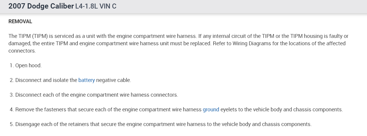

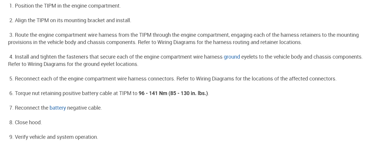

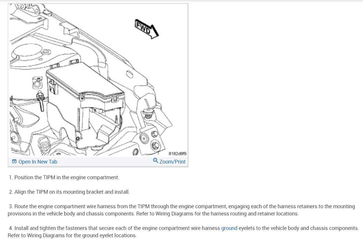

So, what happens with these cars is the TIPM goes out and causes the starter to engine at will. To be sure we should perform a CAN scan which is easy to do, you can get a CAN scanner (Controller Area Network) from Amazon from about $32.0.
https://youtu.be/u-4syLc-ifQ
and
Amazon CAN scanner link:
https://amzn.to/3sX8MCX

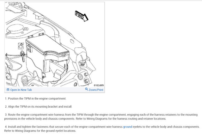

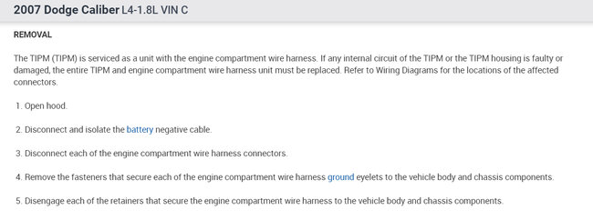

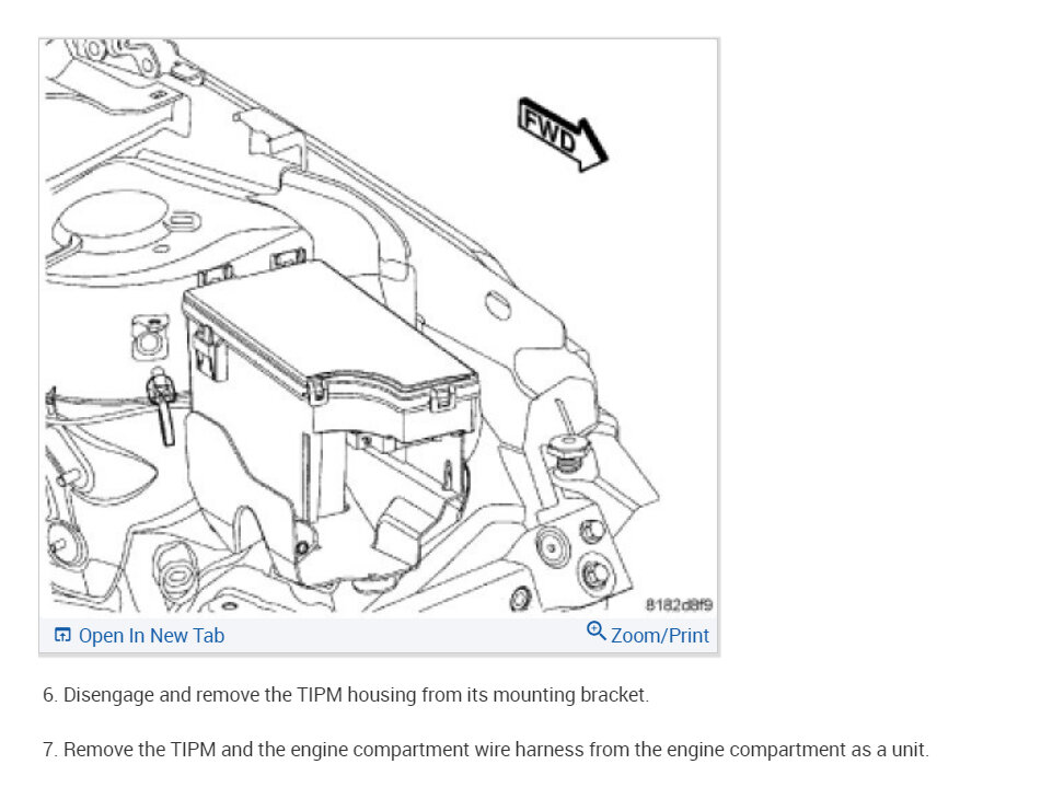

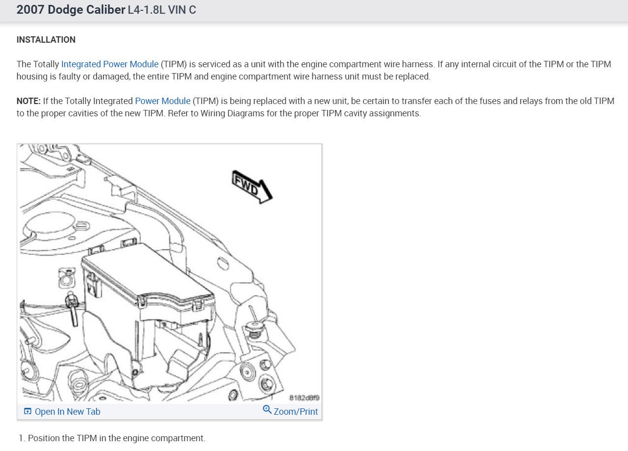

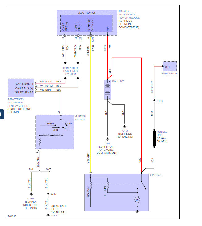

Here are the starter wiring diagrams so you can see how the system works and I have included the TIPM replacement instructions in case you need them. Check out the images (below). Please let us know what happens.
