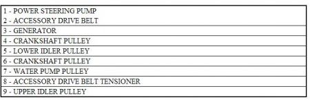

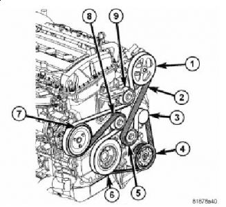

Could you please tell me where I can find a diagram for the routing of a serpentine belt? There isn't one under the hood. Any instructions at all will be very helpful. Thank you.
