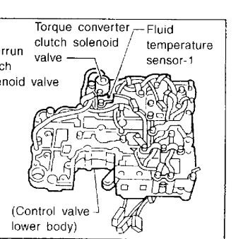

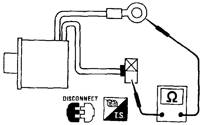

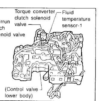

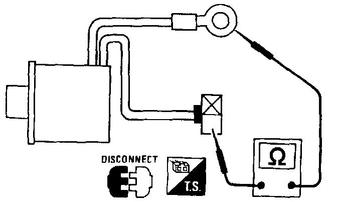

  • 110,194 POSTS
Welcome back:
This can be a few things. My biggest concern... it is related to the transmission torque converter. Since the check engine light hasn't come on to indicate an engine related problem, and it doesn't happen all the time, the first thing I want you to do is check the transmission fluid. Make sure it is clean and full. It should be a redish color. If is good, then I would suggest removing and checking the torque converter clutch solenoid. It is located in the transmission on the valve body and can be accessed by removing the transmission pan. Here are the directions for checking it. Picture 1 shows its location and pic 2 are related to testing.
^ Remove torque converter clutch solenoid valve.
^ Check resistance between two terminals.
Resistance: 10 - 16 Ohms
If this proves good, there may be the start of an issue with the torque converter itself. However, if the solenoid is locked, the transmission will not disconnect from the engine when stopping.
Let me know if this helps.
