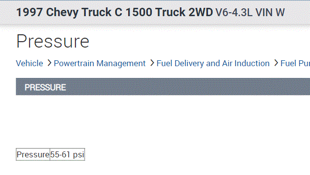

I changed my MAF sensor and all four 02 sensors. it ran fine for a few weeks now when I start it it'll rev to around 2,000 RPMs then shuts off. I can hear the fuel pump kick on but I don't know if it's the fuel filter, the fuel regulator. what can be causing the issue?

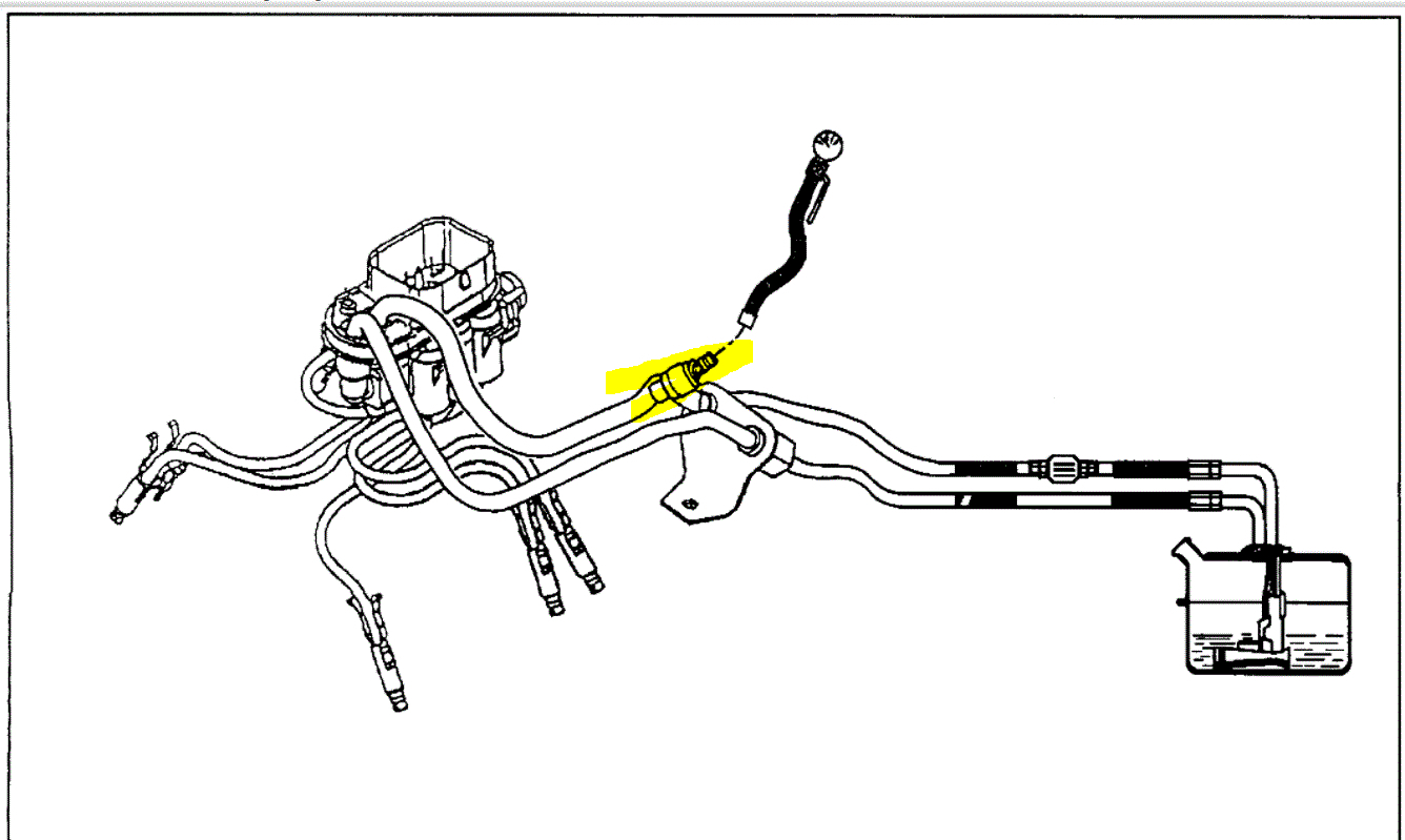

As far as a fuel issue, an extremely lean fuel mixture can cause a high engine rpm. So, I would start by testing the fuel pump pressure and regulator. It really isn't too hard to do.
Here is a link that explains in general how to do it. You will need a fuel pressure gauge, but most parts stores will lend one to you.
If you look at the pics below, I included a pic showing where the fuel pressure gauge attaches and the manufacturer's specs for pressure.
