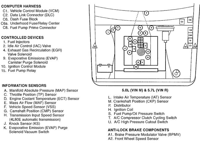

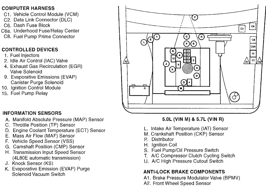

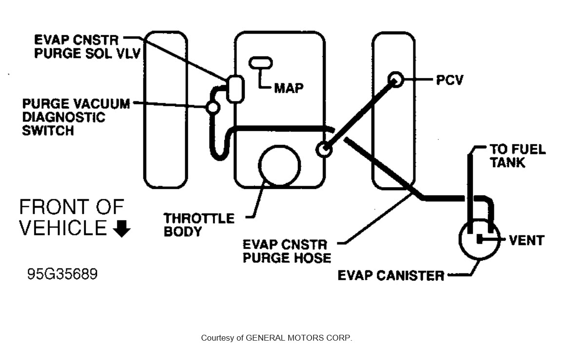

I need a diagram of the intake egr, pvc, carbon can.
May 30, 2016 at 10:49 PM
HMAC300
  • 48,601 POSTS
Scan for codes and check fuel pressure as well as vacuum leaks auto parts scans for free and rent gauge. if hoses are soft for vacuum replace them.
and
https://www.2carpros.com/articles/engine-stalls
Check out the diagrams (Below). Please let us know what you find.
