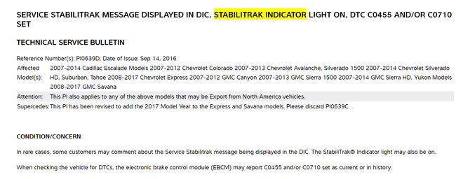

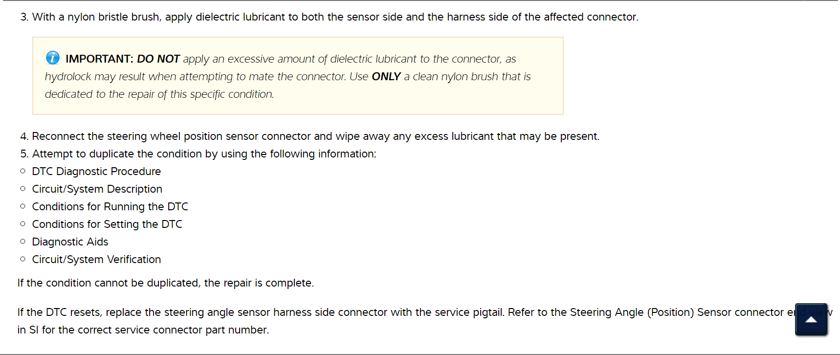

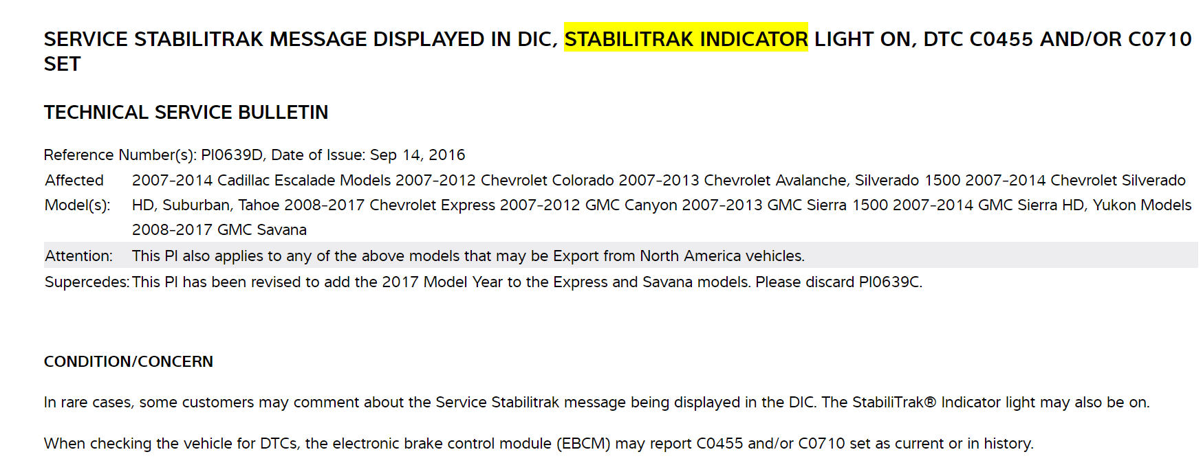

JESSICADABOMB
It has 40 psi. my dash shows a message of service stablitrak, traction control, and says engine power reduced.
Sep 2, 2020 at 5:30 AM
SCGRANTURISMO
  • 4,897 POSTS
Stabilitrak on your vehicle is highly complex and you need to have a Chevrolet Factory Scan Tool to fix. But when researching this for your vehicle I did come across this Technical Service Bulletin (TSB) for this problem. The issue has more than likely caused your vehicle to go into "limp mode". Limp mode is designed to make your vehicle driveable just enough to get it to a repair shop. Once whatever is causing the vehicle to go into limp mode is fixed, it should reset itself. Please go through this TSB, in the diagrams down below, and get back to us what what you can do with it.

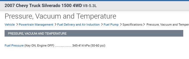

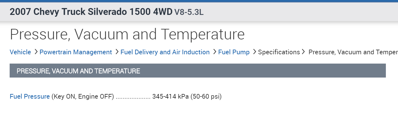

Long cranking is normally a fuel issue. Unfortunately, I learned the hard way that new parts are not good parts. If this started after the pump then we need to prove out a pressure issue. I would start with getting the fuel pressure when this is happening
https://www.2carpros.com/articles/engine-cranks-excessively-before-starting
When you just turn the key on and do not crank the engine the pressure should be a minimum of 55 PSI. Another way to help prove the pump is to turn the key on so the pump primes, then turn it off and back on a couple times when this happens and see if it starts the truck. If it does then basically this is showing that the pump is not priming properly on the first key cycle.
Let us know what you find. Thanks

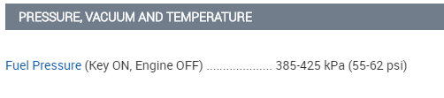

RIVERMIKERAT
  • 6,110 POSTS
Check for fuel pressure bleed down. Turn the key on and verify that you have around 55 pounds. Then turn the key off and see if the pressure bleeds off slowly or quickly. If quickly, the pump should be replaced and your secondary check valve is also not doing what it was designed to do.

THEBOSS
  • 31 POSTS
Well it`s been 2 days now and the secondary check valve seems to be doing the job. Wne I first started into this problem as noted the fuel pump pressure spec. is 60 psi but this truck has been running fine at 50-55 psi and thats what it is doing fine so far on with secondary valve,starts again within the 3 sec.range.will keep watching and post if it changes.Thanks again!

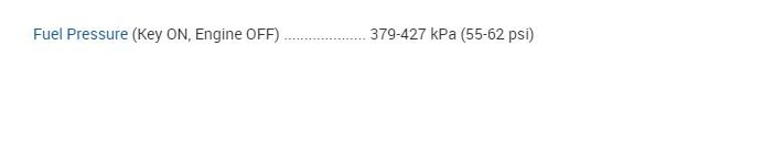

ROBERTBARNES62
  • 83 POSTS
I checked the pressure and this is what I have found. When turn the key the press goes up to about 50 psi and then immediately drops to about 10 psi. When running it is reading about 50 psi steady.
If I understand it correctly, when I turn the key it should be in the 50psi range but it should hold pressure and not drop back to 10psi immediately, right? If that is correct would mean that my fuel pump needs to replaced, right?
Also I must add that I put a new fuel filter and pressure regulator already.
Jan 25, 2021 at 3:47 AM (Merged)
  • 110,240 POSTS
Either the pump is bad or there is a leak. When you first turn the key on, it primes only for a couple seconds. Then, the pump will not turn back on until engine RPM's reach a predetermined point. Are you sure there are no leaks? When it does start, is there any black smoke which could indicate a leaking injector?

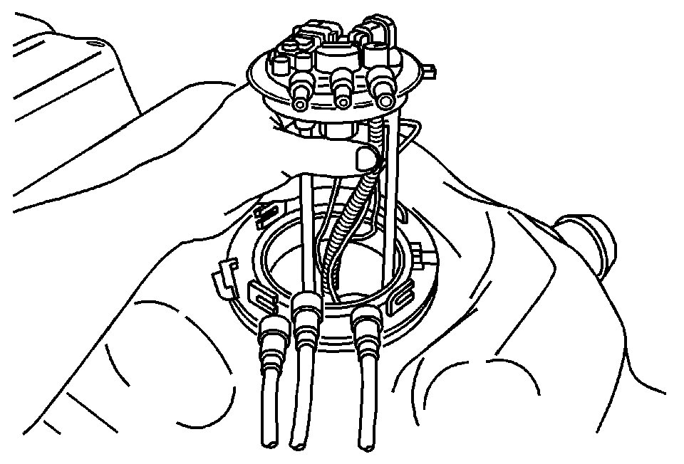

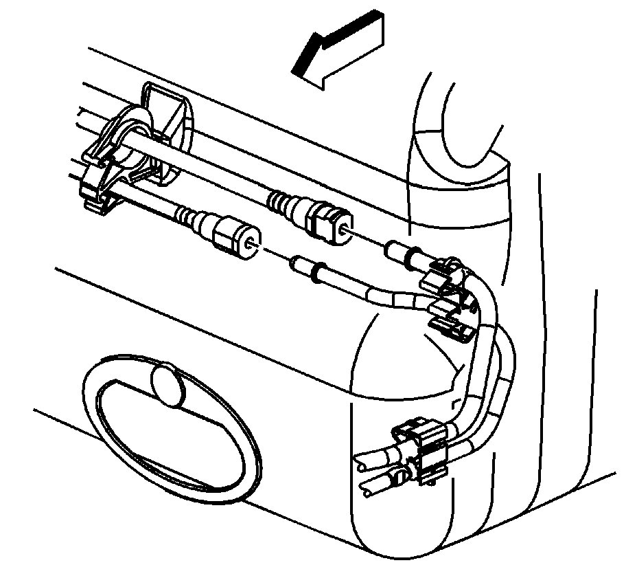

Since there is no black smoke and you see no leaks, I suspect it is the pump. Here are the directions for replacement. The first part is tank removal. The second explains how to remove the sender / pump. All pics correlate with the directions.
__________________________
2003 Chevy Truck K 1500 Truck 4WD V8-6.0L VIN U
Fuel Tank Replacement (Pickup)
Vehicle Powertrain Management Fuel Delivery and Air Induction Fuel Tank Service and Repair Removal and Replacement Fuel Tank Replacement Fuel Tank Replacement (Pickup)
FUEL TANK REPLACEMENT (PICKUP)
Fuel Tank Replacement (Pick-Up)
pic 1
REMOVAL PROCEDURE
1. Relieve the fuel system pressure. Refer to the Fuel Pressure Relief Procedure.
2. Drain the fuel tank. Refer to Fuel Tank Draining Procedure.
See: Fuel Tank > Procedures > Fuel Tank Draining
3. Remove the fuel tank fill pipe.
4. Remove the evaporative emission (EVAP) canister.
5. If equipped, remove the fuel tank shield bolts.
6. Remove the fuel tank shield.
pic 2

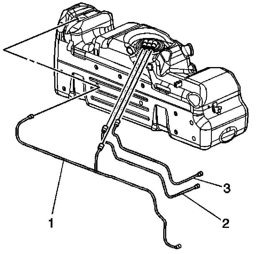

7. Disconnect the fuel feed/return pipes from the fuel tank pipes.
8. Cap the fuel and EVAP pipes in order to prevent possible fuel/EVAP system contamination.

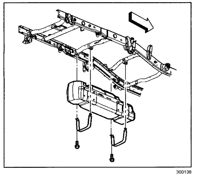

9. Place a suitable adjustable jack under the fuel tank.
pic 3
10. Remove the fuel tank strap bolts.
NOTE: Refer to Damage to Fuel Tank Straps Notice in Service Precautions See: Fuel Tank > Vehicle Damage Warnings > Damage to Fuel Tank Straps Notice.
11. Remove the fuel tank straps.

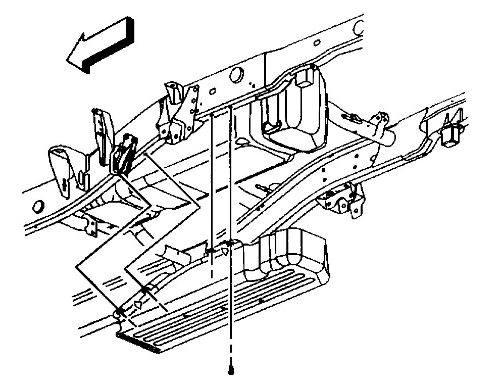

12. Lower the fuel tank until the electrical connections are accessible.
pic 4
13. Remove the fuel sending unit connector position assurance (CPA) connector.
14. Disconnect the fuel sending unit and pressure sensor electrical connectors (1).
15. Completely lower the fuel tank.
16. With the aid of an assistant, place the fuel tank in a suitable work area.

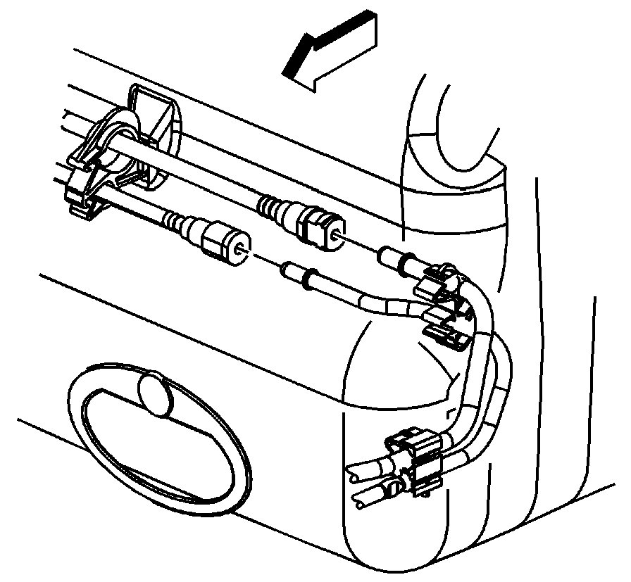

pic 5
17. Disconnect and remove the fuel feed (3) and return (2) pipes from the sending unit and retaining clips.
18. Disconnect and remove the EVAP pipe (1) from the sending unit, roll over valve (3), and retaining clip.
19. If replacing the fuel tank, remove the sending unit.

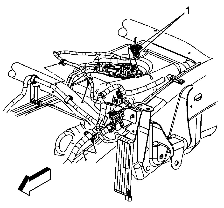

pic 6
INSTALLATION PROCEDURE
1. If the fuel tank was replaced, install the sending unit.
2. Install and connect the EVAP pipe (1) to the sending unit, roll over valve (3), and retaining clip.
3. Install and connect the fuel feed (3) and return (2) pipes to the sending unit and retaining clips.
Fuel Sender Assembly Replacement
Vehicle Powertrain Management Fuel Delivery and Air Induction Fuel Tank Unit Service and Repair Procedures Fuel Sender Assembly Replacement
FUEL SENDER ASSEMBLY REPLACEMENT
TOOLS REQUIRED
J 44402 Fuel Tank Sending Unit Wrench
pic 12
REMOVAL PROCEDURE
1. Remove the fuel tank.
2. Disconnect fuel lines from the sending unit, if required.
3. Using J 44402 , remove the sending unit lock ring.
pic 13
4. Remove the sending unit and seal. Discard the seal.
CAUTION: Drain the fuel from the fuel sender assembly into an approved container in order to reduce the risk of fire and personal injury. Never store the fuel in an open container.
5. Clean the sending unit sealing surfaces.
CAUTION: In order to reduce the risk of fire and personal injury that may result from a fuel leak, always replace the fuel sender gasket when reinstalling the fuel sender assembly.
IMPORTANT: The fuel strainer must be in a horizontal position when the sending unit is installed in the tank. When installing the sending unit, assure that the fuel strainer does not block full travel of the float arm.
pic 14
1. Install a NEW sending unit seal.
2. Align the tab, and install the sending unit.
pic 15
3. Using J 44402 , install the sending unit lock ring.
4. Connect fuel lines to the sending unit, if required.
5. Install the fuel tank.
_____________________________
Let me know if this helps.
