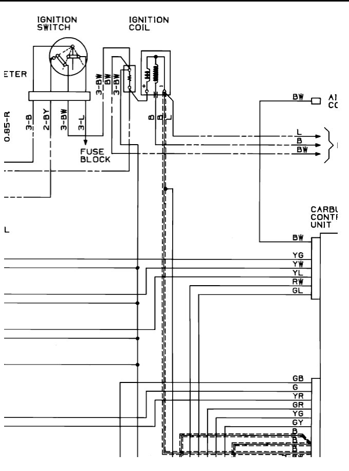

Engine cranks normal, getting fuel, and sometimes will start but stops . I need to run voltage test on and around the coil when key on. With key in on position, not running, should I have twelve volts checking positive and negative side of coil with a volt meter. Or is twelve volts present only during cranking the engine.
Should I check continuity from the ignition switch wires to the coil side of the wire. I have a rather large black wire with white stripe and a black with yellow stripe I think are the ignition start and run wires.
Plugs have no spark I could see when testing and I layered coil tower wire near a ground and no arc found. So I am lacking a twelve volt source to the coil from switch. Switch is relatively new.

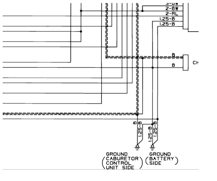

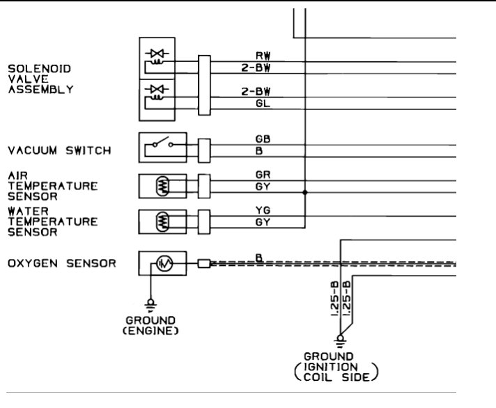

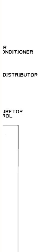

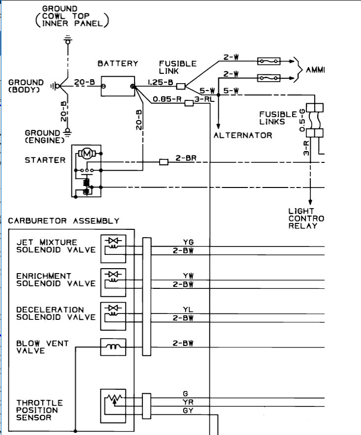

I have found the ignition switch and coil wiring diagrams so you can do some testing Here is a guide to get you started:
Below are the engine wiring diagrams. You will need to put them together.
