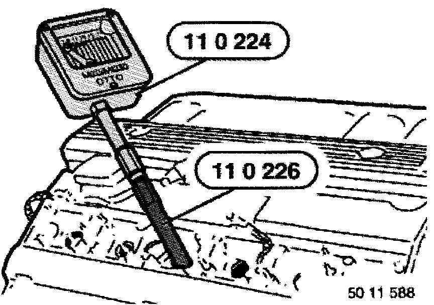

COMPONENT TESTS AND GENERAL DIAGNOSTICS
Checking Compression Of All Cylinders
- Read out fault memory of DME control unit
- Check stored faults
- Rectify faults
- Clear fault memory
Disconnect fuel pump relay or fuel pump fuse.
Start engine and allow remaining fuel to escape.
This prevents fuel from being injected, the catalytic converter from being damaged and the test result from being distorted during the compression pressure check.
Caution: High voltage - mortal danger!
Disconnect all supply leads from ignition coils (interrupt power supply to ignition coils).
picture 1

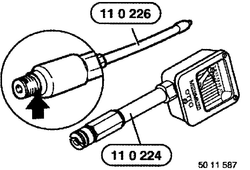

Remove all spark plugs See: Spark Plug > Service and Repair
Screw special tool 11 0 226 by hand into spark plug thread and connect special tool 11 0 224.
Note: Check that seal is in perfect condition.
picture 2
Depress accelerator and actuate starter until compression stops rising.
Compression pressure See: Compression Check > Pressure, Vacuum and Temperature
Now clear the fault memory.
Compression specs:
Compression pressure (approx. equal value for all cylinders) mininimum 12 - 14 bar

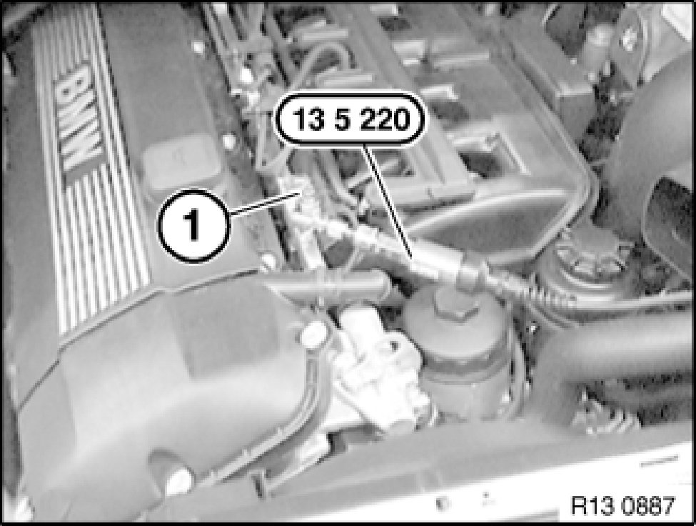

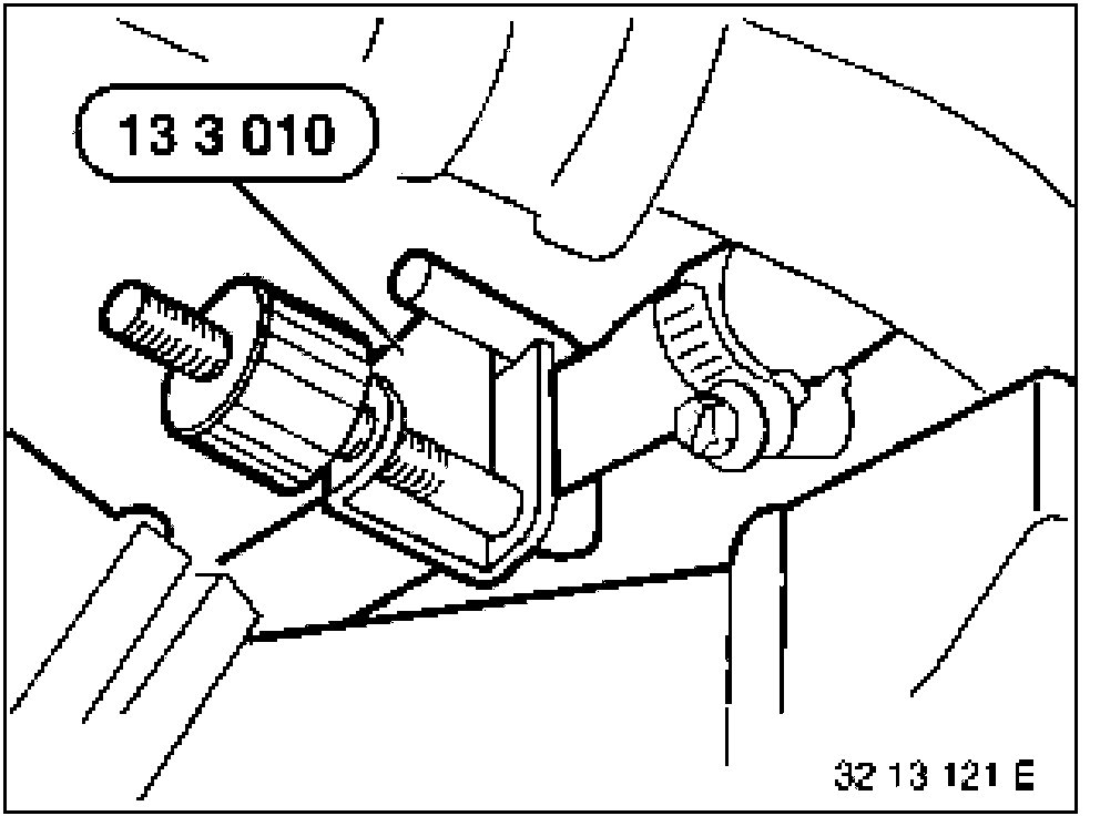

Remove cover from fuel injectors.
picture 3
Remove dust cap (1) from measuring valve on fuel rail.
picture 4

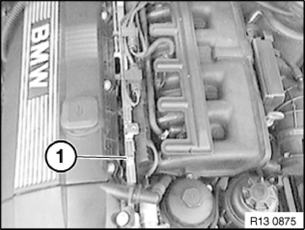

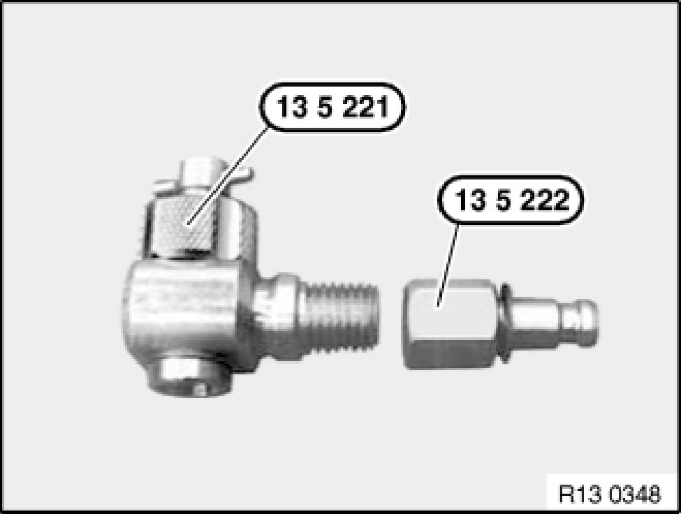

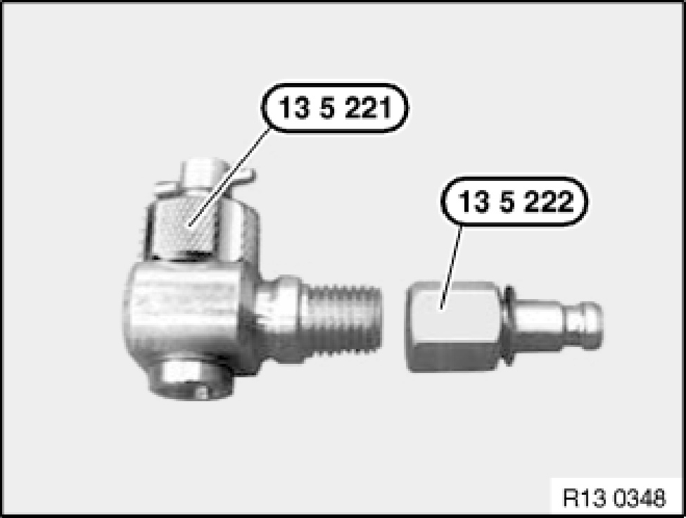

Prepare special took kit 13 5 220 (consisting of 13 5 221 and 13 5 222).
picture 5
Unscrew check valve (1) on special tool kit 13 5 220.
Fit special tool kit 13 5 220 on measuring valve and tighten knurled nut until hand-tight.
Start engine.
Screw in check valve (1) until a pressure reading is indicated on DIS Tester.
CAUTION: Do not under any circumstances screw in the check valve up to the mechanical stop. This could damage the valve in the pressure regulator housing.

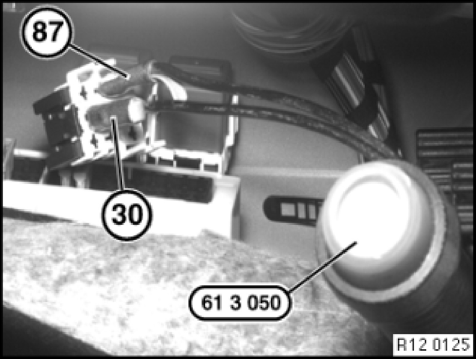

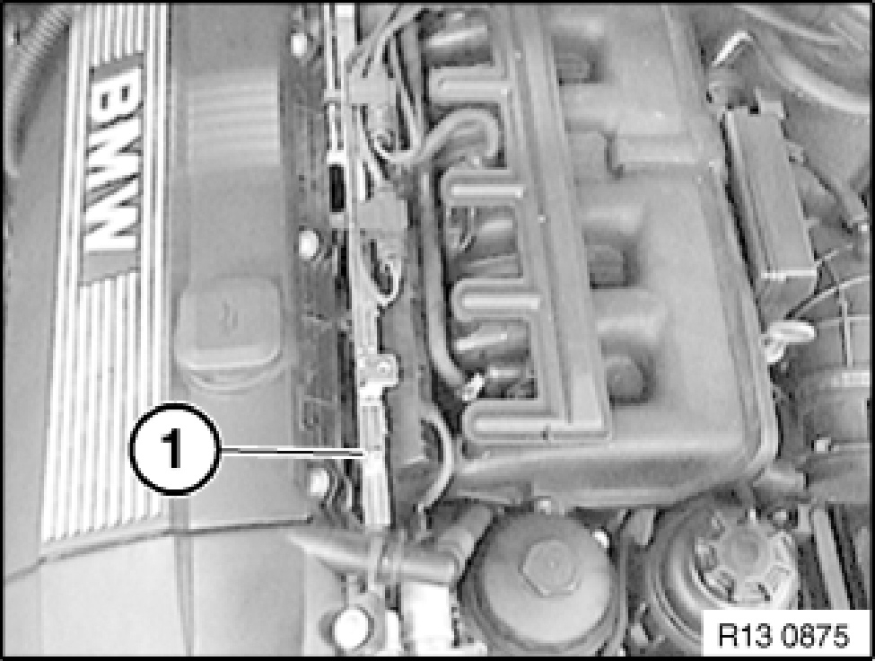

Checking fuel pump:
Detach fuel pump relay.
NOTE: Check whether fuel pump no longer starts up during engine starting procedure (engine fails to start).
picture 6
Connect special tool 61 3 050 to terminal (87) and terminal (30).
Press button and read off fuel pump delivery pressure on DIS Tester.
Compare actual value with specified value of delivery pressure.
picture 7
