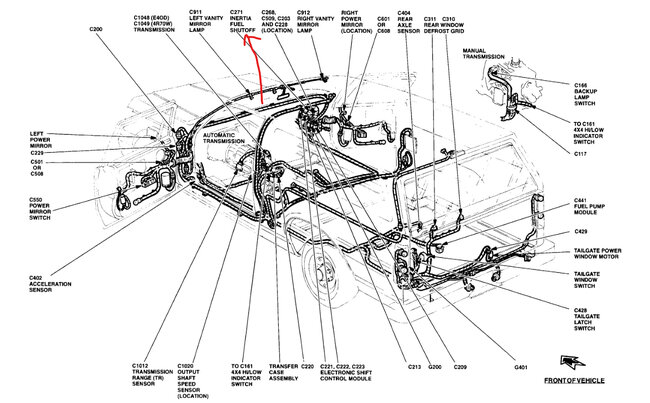

I have two questions. My vehicle was parked and some guy driving under the influence decided he wanted to park his Nissan Rogue under the front end of it. He hit it so hard that it broke the steering gear assembly and moved it about 5 1/2 feet. Before this happened, it was very dependable, I could get in the vehicle anytime and it would start right up. Since it was hit, it has become very unreliable. it either won't start at all, or it will start, and I can drive to the store and come back out, and it won't start. So many questions, could it getting hit have caused this and any idea what I need to do to fix it?

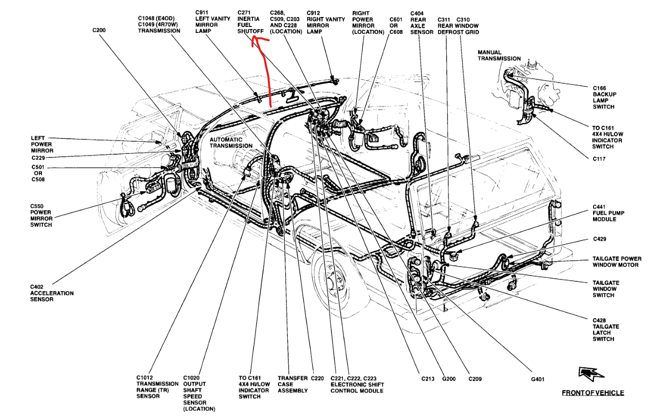

Sorry to hear about your accident, there is an inertia switch located on the right side under or near the kick panel by the passenger side which sounds like it has been tripped. there will be a reset button on the top push it down and you should hear a click which means the switch is reset and the engine should star again. Check out the images (below). Please let us know what happens.

I took off the kick panel and found the inertia switch. It didn't appear to have been tripped, but I went ahead and tried to start it. After putting a jumper on it, it fired right up. Let her run for about a half hour took for a spin around the block. I shut it off, and tried to start and it fired right up. I got home from work today, tried to start and battery is drained. I will update after I charge the battery. Thank you for your help.
